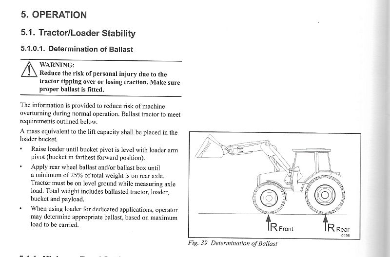

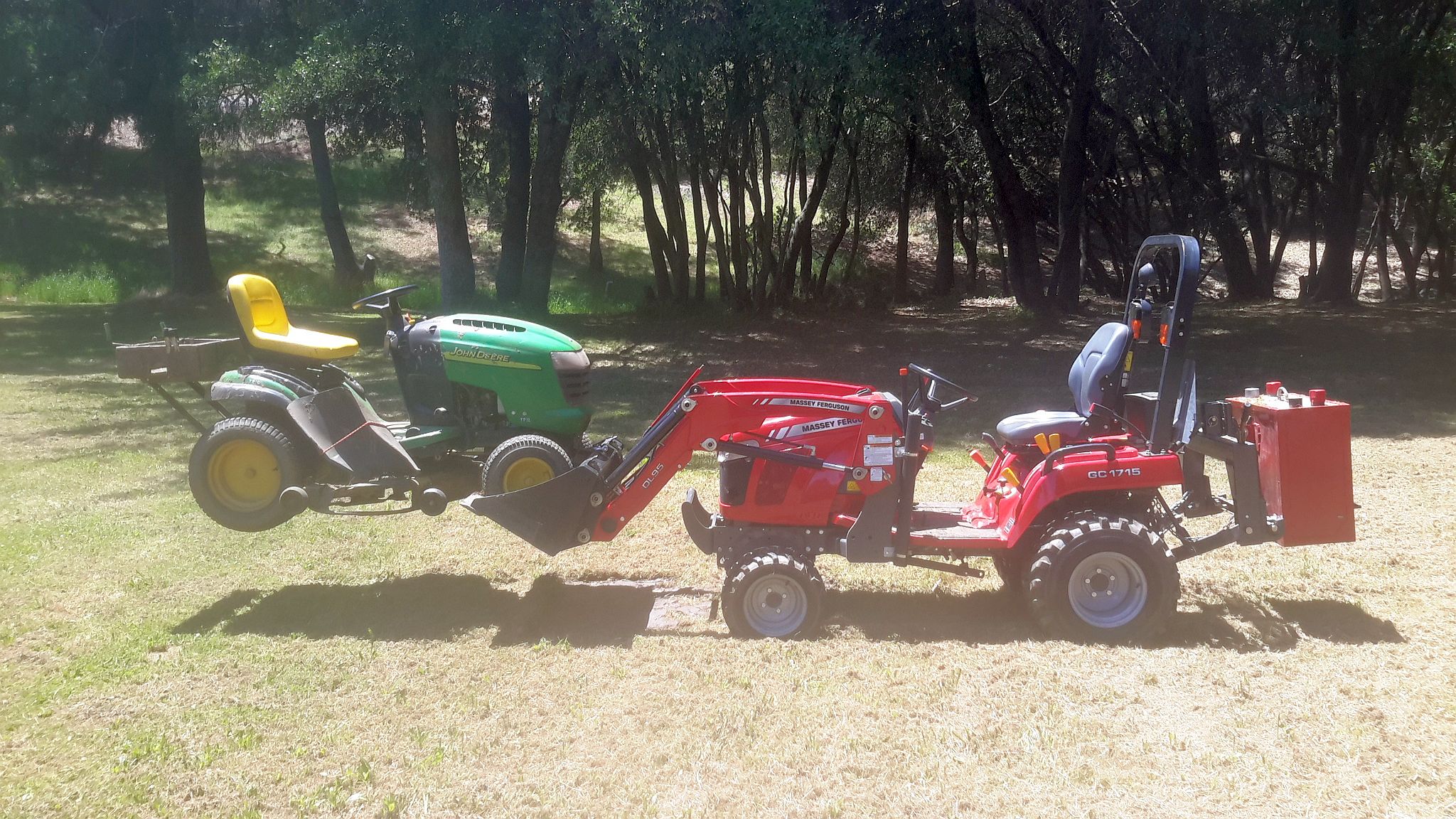

THis is what my tractor manual states....
docscan-2-jpg.678089
BUt I just made a box about 2x2x1 ft and filled it with concrete at about 150 pounds per cubic foot....
ballast-box-jpg.683191
Too much, to little, I don't know but it keeps rear wheels on ground... And being its an HST that is where brakes are...
20190513_134020-jpg.678087
20190513_134501-jpg.683289
JD weighs in at 520 pounds according to JD manual...
