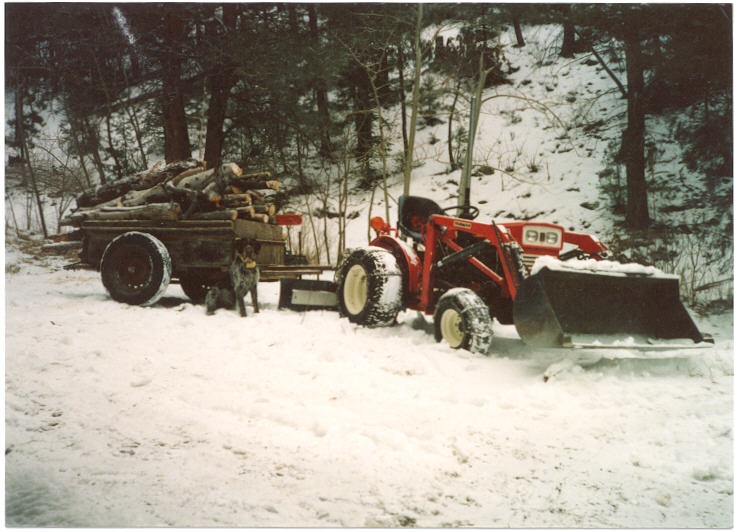

The YM165D had several ways to widen the rear stance - including reversing the wheels - which required that the left and right wheels swapped side, and made the hub fixing bolts end up on the inside rather than conveniently on the outside. There are pictures in the ownerss manual.
YM165D_firewood & snow.jpg1687144202431.jpeg At max. width, the wheel & hub are reversed with the hub to the inside so that from the side of the tractor it looks like the photo below. If you do that, be sure to reach inside between the wheel hub and fender to check and keep those two wheel-to-axle set bolts tight. Those set bolts should stay tight eough to take up all of the play between the wheel hub and that six-sided axle. The springs Yanmar put around the bolts work like lock washers to keep the bolts snug.
YM165D_firewood & snow.jpg 1687144202431.jpeg At max. width, the wheel & hub are reversed with the hub to the inside so that from the side of the tractor it looks like the photo below. If you do that, be sure to reach inside between the wheel hub and fender to check and keep those two wheel-to-axle set bolts tight. Those set bolts should stay tight eough to take up all of the play between the wheel hub and that six-sided axle. The springs Yanmar put around the bolts work like lock washers to keep the bolts snug.

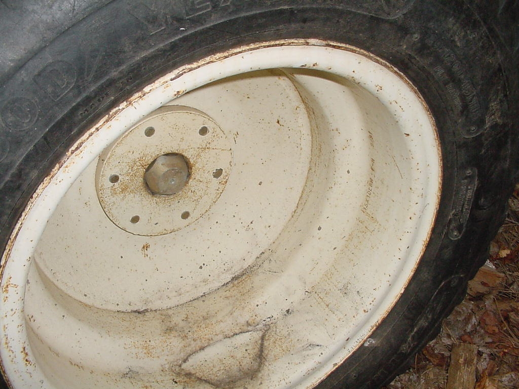

On my YM186D (about the same size) I sanded the 'wrong' side of the hub flanges to make them flat and found they were already machined flat. Apparently Yanmar anticipated the wheels might be installed that way, outboard beyond the hubs.
p1740771rhubsandedflat-jpg.364649
This improved the width of the tread to maximum.

Then I added wheel weights from Craigslist - origin unknown - that fit outside the shoulders in the rims.
