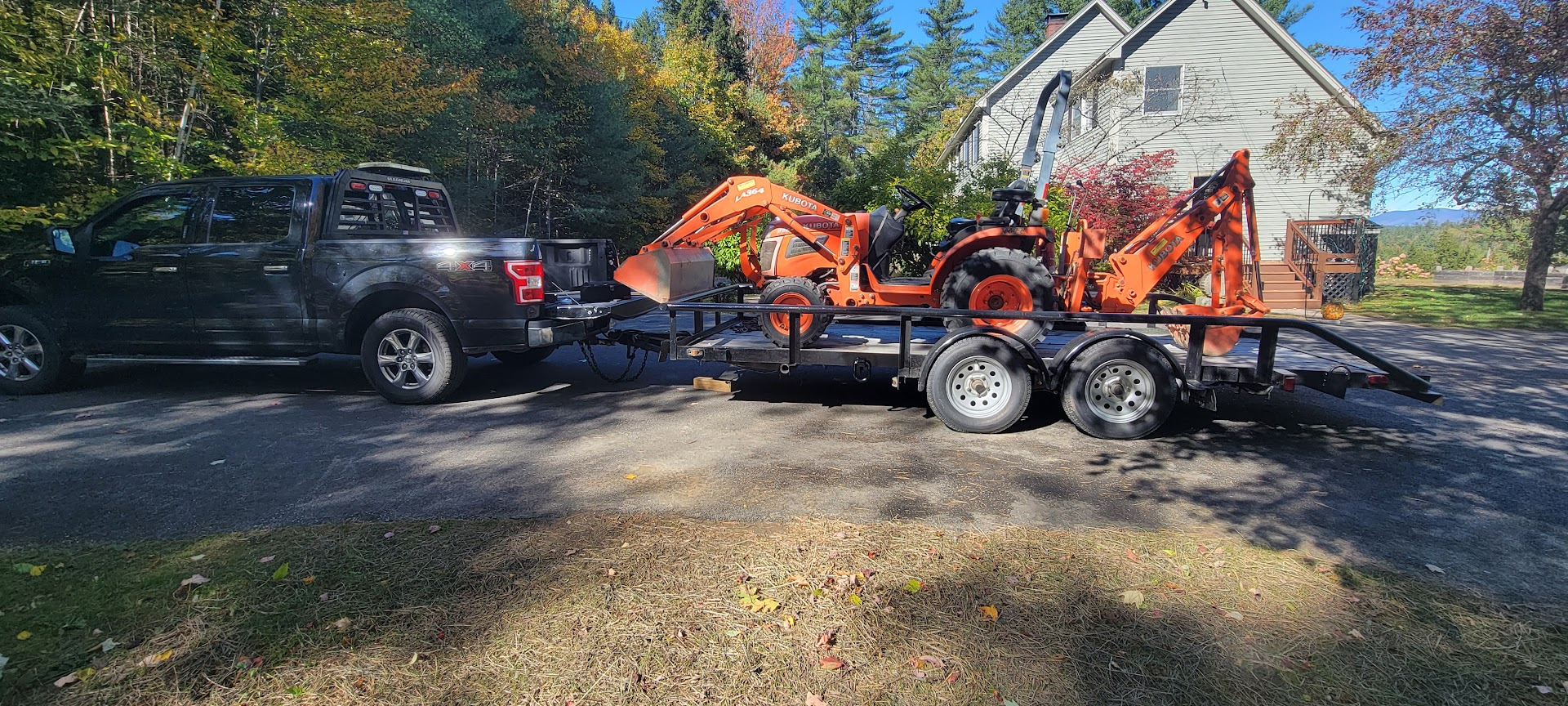

I have never towed this tractor on this trailer.
I measured from ground level to the top of the rear wheel well and got 39" with the unloaded trailer attached.
With the tractor backed onto on the trailer the measurement is 38".
If the tractor is driven up onto the trailer, bucket first, and the rear wheels centered between the trailer axles then the bucket extends over into the truck bed.

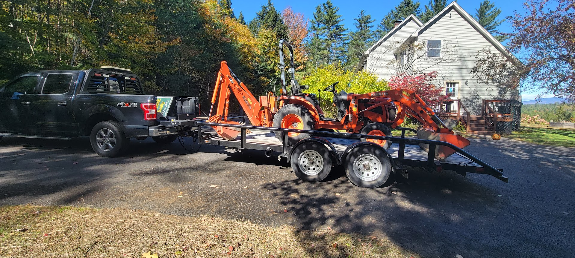

In photo #2 The tractor is driven on with the bucket just behind the trailer tube and the measurement is 38"

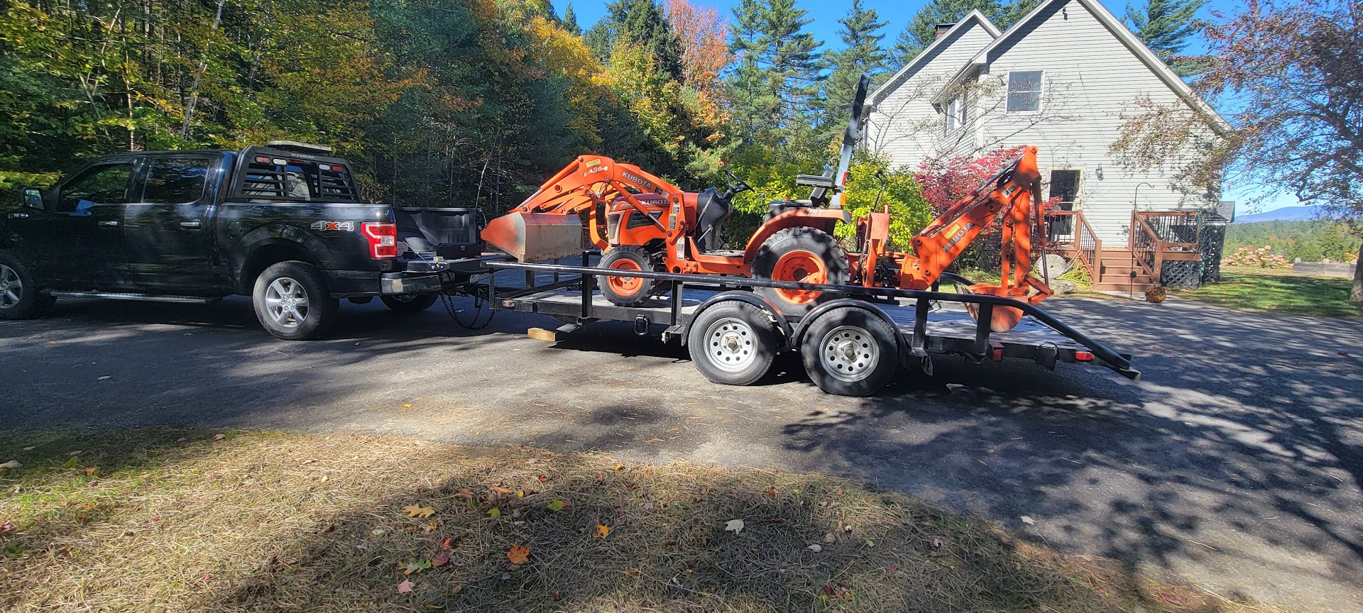

Photo #3 The tractor is a bit further ahead with the bucket just passed the front tube and the measurement is 37 1/2"
So my question is I need some experience opinions considering safety first and then determining proper tongue weight.

Most people would be satisfied with some amount of lowering of the truck suspension. You know there is an undetermined positive tongue weight, and I'm sure you'd be fine either way in your photos.
I prefer to confirm the tongue weight % with the numbers from the tractor and trailer weight, and weighing the actual tongue weight. 10-15% of the total weight is a range to shoot for.
Small hydraulic scales are available in the $150ish range, as are hitches with a scale built in. You could also look up how to use some lumber and a bathroom scale to check the tongue weight.

leave it backed on, easier to strap. your not going to have a issue
/ Trailer Weight Distribution #4
To my eye your first and second picture both look ok. The third picture I think the tractor is to far forward. Get a trailer tongue scale if in doubt.

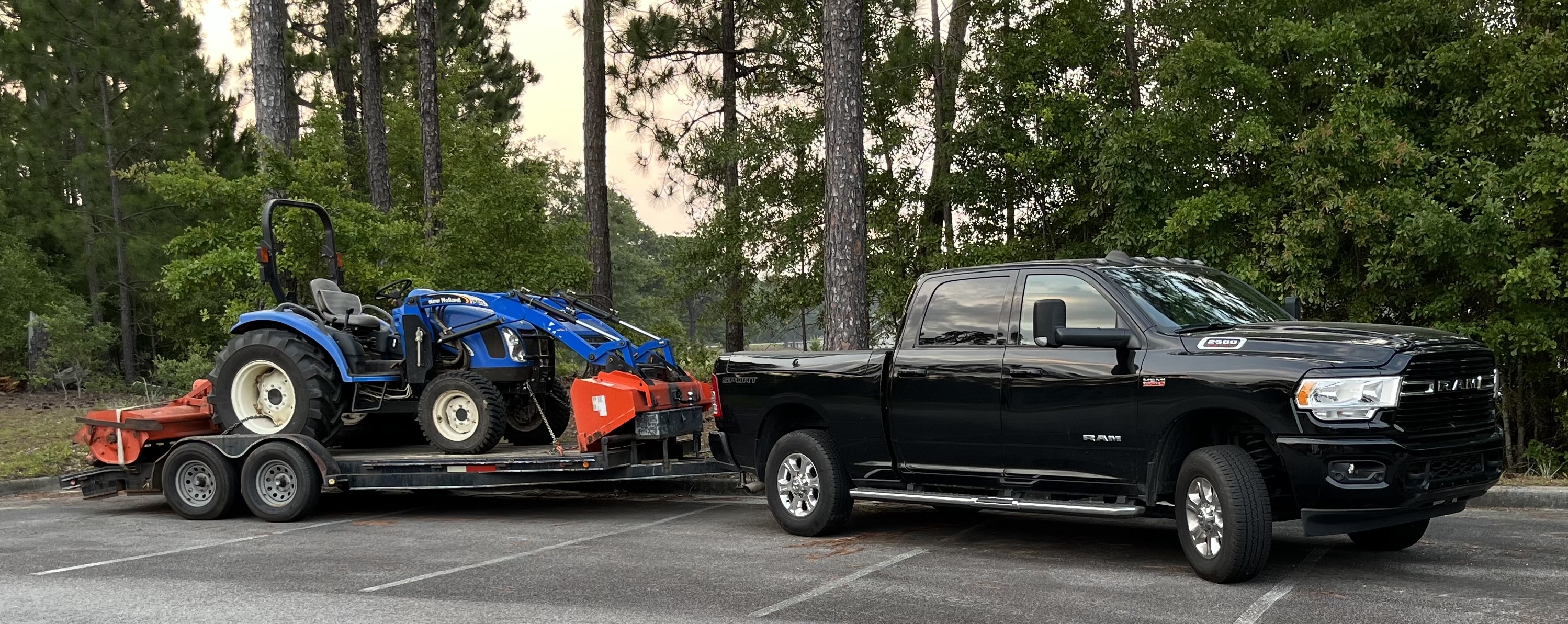

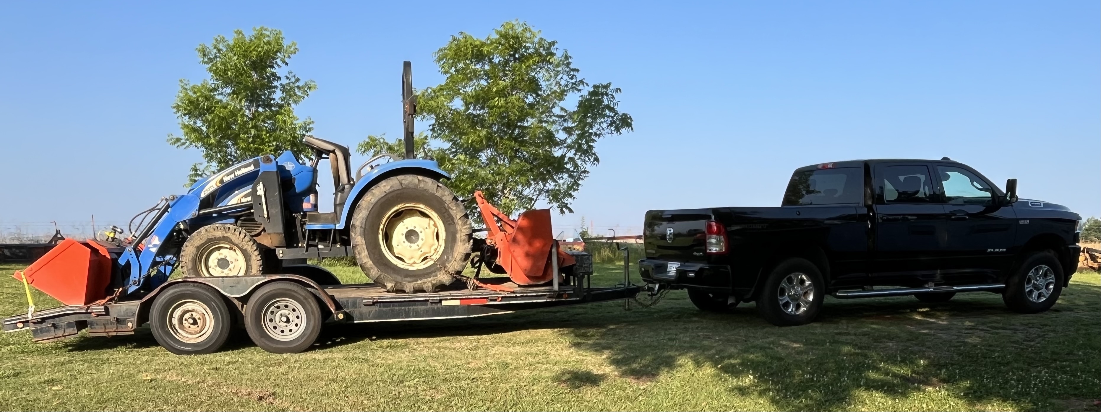

I think you have more tongue weight with it backed on than you think.
It looks like your truck is a 1/2 ton so you may want to weigh it and see what you have.
I have too much tongue weight with my tractor backed in the attached picture with my 2500 truck, but not if I pull it on. That said it tows great either way.

I like your pic#1 having the tractor backed on the trailer.
In pics 2&3 it appears like your truck will hit the bucket during a sharp turn.
I prefer my trailer to be level (or close) when empty. IMO 6" is too high.

Loaded tires and pic 1 looks like the perfect weight distribution for the trailer.
Pic 3 is too far forward.
Pic 2 is workable, but be careful on turns and backing up.
