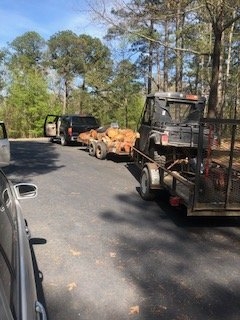

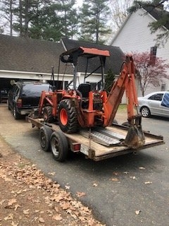

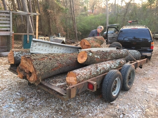

Been pulling trailers for over 55 years of all sizes and kinds.
Here of late most is with a double axle {6K lb each} 14' trailer I made for my asphalt business in '82 with my Kubota B20 and always pull it on -- never back it on.
Although I like "LittleBill21"'s comments, I don't recommend loading tail heavy and "take a ride. when it starts swaying at 45+ you will get it." as this could cause a blown tire, accident etc.
Most of the time I have a 5' Bush Hog on and it hangs 4' past the back of the trailer -- in AR that's legal -- but sometimes I'll have the Kubota BT750 Back Hoe on and lower to the deck.
The Bush Hog and Back Hoe are about the same weight as the motor and front end of the tractor and therefore balance the weight producing a tongue heavy load.
I also keep the loader bucket on the trailer against the front of the trailer as I don't really like it over the front unless I'm pulling another trailer behind the loaded one -- I also do this quite a bit.
You might also consider a "leveling hitch" and/or air bags for your tow vehicle.
I'll try and find a couple of pictures.

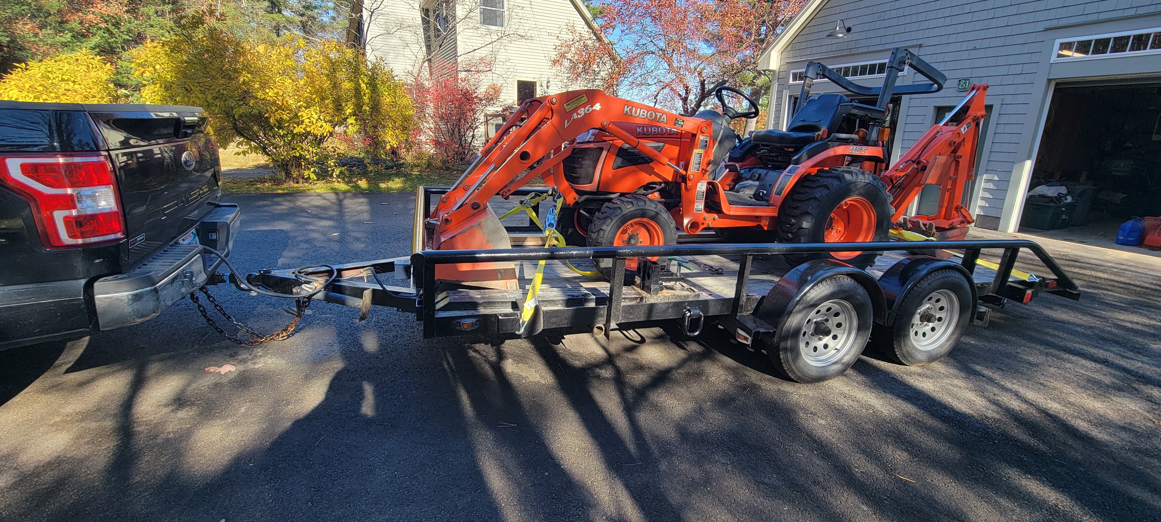

I think you have more tongue weight with it backed on than you think.
It looks like your truck is a 1/2 ton so you may want to weigh it and see what you have.
I have too much tongue weight with my tractor backed in the attached picture with my 2500 truck, but not if I pull it on. That said it tows great either way.
This really depends on the size of the tractor and implements your hauling.
My Grey market L1501 fit and hauled best when backed on. I could drop the bush hog wheel on the chain box, and the loader even with the tailgate.
It ran nice and smooth down the road.

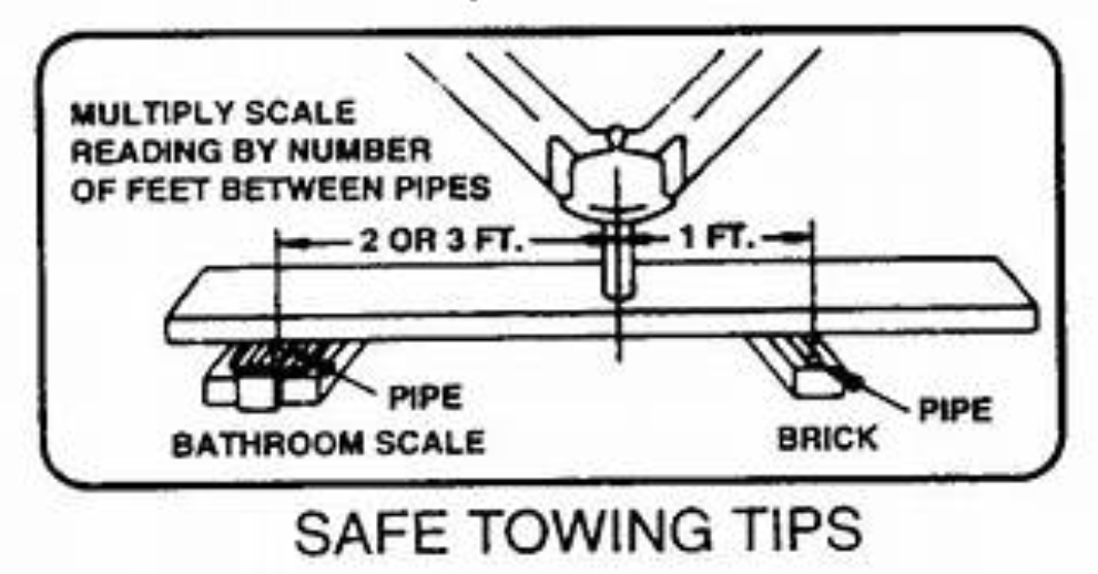

   / Trailer Weight Distribution
#59

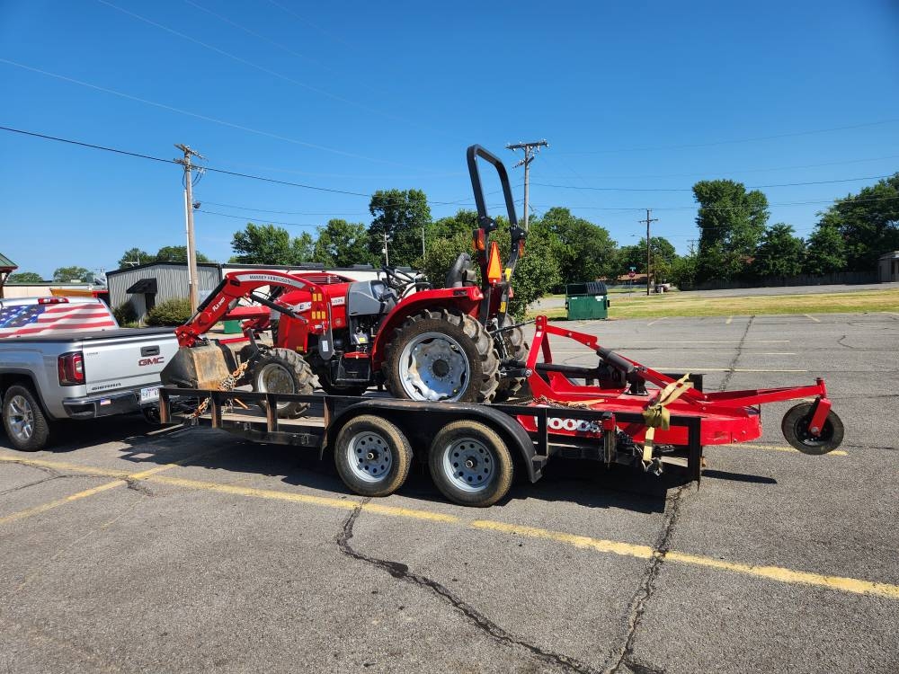

Up date.
First of all, thank you for all your input!
I'm sure as to what I'm to say to add more......
In order to get an idea on tongue weight, I went with measuring the distance from the bottom of the hitch to the ground completely unloaded.
18 2/4 ".
Measured with me @ 200lbs standing on the hitch 17 1/4".
Fully loaded as shown here, 15 2/4".
If my "iffy" math is correct then I have 480 lbs of tongue weight.
I am taking it for a 10 mile round trip to pick up a piece of stone today.
Max speed 40 - 45 mph, back roads, as I don't have brakes yet!
This trailer was purchased 3rd hand and the brake electrical lines were cut.
Other than this mornings trial, the trailer will not be used again until the brake issue is resolved.
