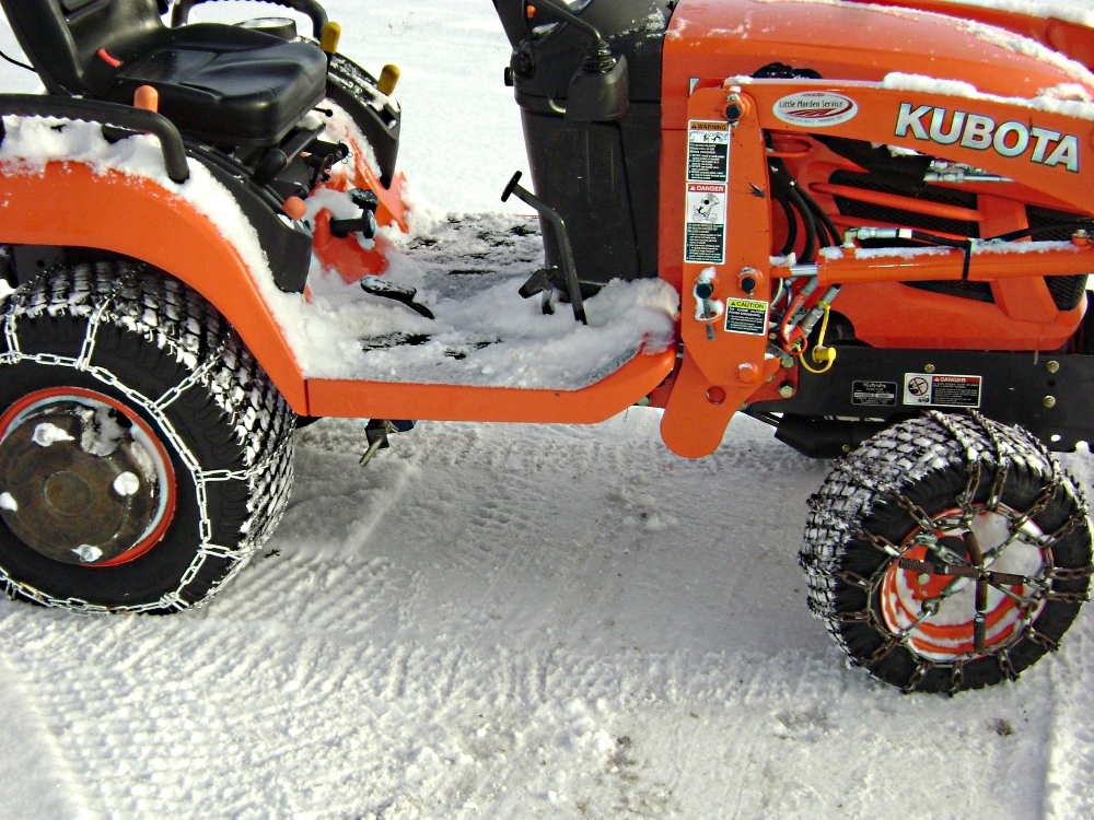

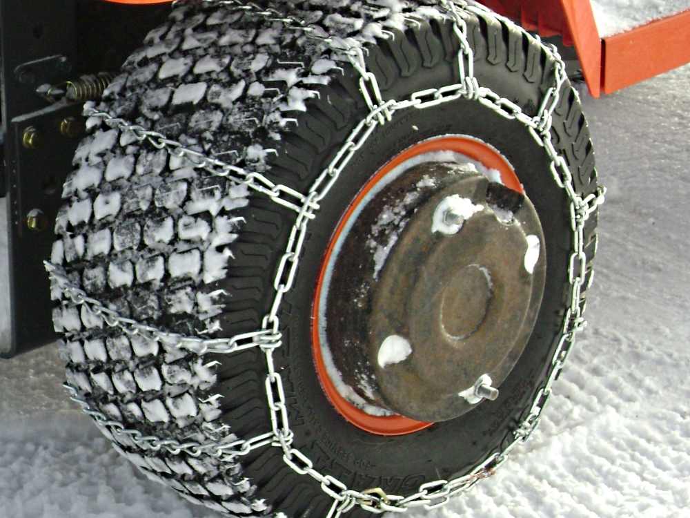

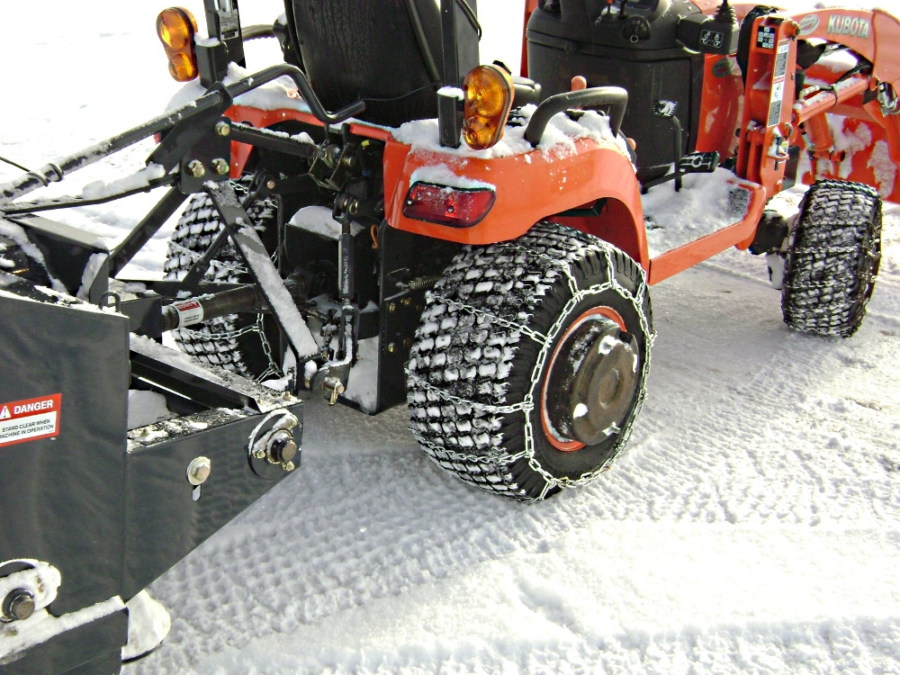

I use weights on the rear wheels of my Bx2350 and chains all around.
Years ago I got tired of the plastic covered concrete wheel weights on my little ten horse Allis so being a pattern maker I tooled up a pattern and sent it to the local foundry. After the Allis died I was just using these weights on a harrow frame dragged behind the quad for maintenance of the driveway.
Needless to say that I was pleasantly surprised to find that these weights fit on the Bx2350 perfectly. Whoda thunk it? These puppies weigh in at 275 pounds a side and thats some serious weight. Now on snow it or ice it just spins and digs holes untill the chains fine hard stuff and then it just chugs along like all good little orange tractors should.:)
Now all I have to do is tool up a few patterns for the front end and a ballast block for the three point, cuz like cast iron trumps sand and rocks every time.
Being a retired pattern maker with a complete home woodwork shop has it's perks.
And oh yeah the rear chains from the Allis fit the front wheels on the Kubota after I took out one ladder length so it's all good.

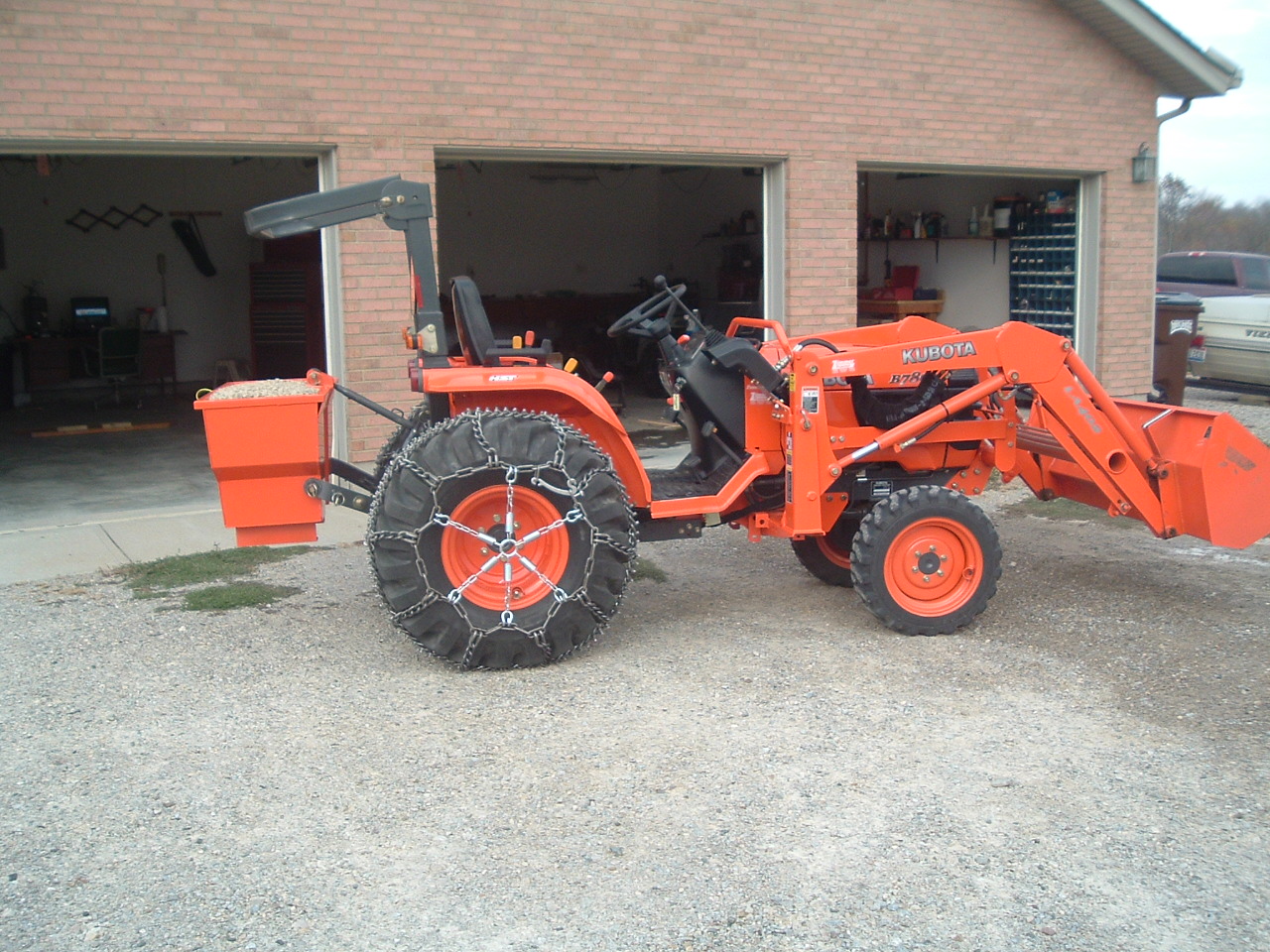

/ Weights #10
I filled my tires with Rimguard and added a ballast box. The filled tires add about 400 pounds and the ballast box an additional 600 pounds.

/ Weights #14
You can also make your own rear ballast box. Many posts on this site of various types. Mine is made out of a plastic 55 gallon drum, I welded up some framework inside it to connect to the 3 pt. and filled it 3/4 full of concrete. Weight is about 800 lb.
