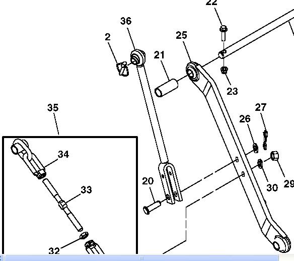

The left lift link on my JD 3038e broke this afternoon - at a time when I was doing FEL work and had nothing on the hitch. The lift link is the bar from the hydraulic arm down to the draft link, the bar that is a third of the 3-pt hitch.
I was busy and didn't notice the break I guess, and backed up with a few vines in my bucket. The back of the tractor rose up - the same effect you get when you try to lift more than the tractor can handle. I lowered the bucket and - tho it took a few seconds for the left rear to drop- I didn't notice it for a few moments - then heard a dragging noise and checked.
The draft link had dropped and, as I backed, it had lifted up the back rear wheel and wedged forward.
I studied the situation - since I was a mile from anywhere, then removed the sway chain and slowly ran forward. The link lifted the tractor again and came out where it was supposed to be. I wired it up until I was finished.
The lift link broke at the weld, so I can only assume it was a defect - although I have used a box blade and rotary cutter on it recently without problem. Got 35 hours on the tractor.

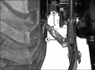

I see the 3038e has side links, although - in the tractor manual - they look somewhat insubstantial. On all the tractors I've owned, side links could be adjusted to prevent the lift arms from striking the inside of the tires? If this is true for the 3038, then you should shorten them accordingly to prevent this from happening again.
//greg//
/ Weird Thing - Link Broke
The 3038e does have side links and, to me, they seem pretty substantial. The problem is that when the lift link breaks, the lower draft link drops straight down. If you then back up, it catches the ground and is forced under the tractor toward the tire. The side link prevents the link from going toward the center of the tractor. It is not and could not be a solid bar to prevent it ever going toward the tire. The two side links working together prevent the implement from swaying. Anyway, when the draft link is levered under the tractor, the geometry of the side link changes and it allows the bar to get under or wedged against the tire. Fortunately, it did not press against anything that would break.
/ Weird Thing - Link Broke #9
Ah, I didn't understand the sequence as stated in your original post. But really, that too is avoidable. I've got quite a varied assortment of TPH implements. Every one (that I can't lift by hand) has lift pins that are at least 6" above ground level. I find no need to have the lift links adjusted to where they're at or near ground level. They're adjusted to no higher than pin level, and never ever even get close to ground contact.
And FYI, my 3720 has pin-adjustable semi-rigid side links. You might consider checking to see if they're compatible with the 3038 mounting points.

DK
Do you have a pic of the broken link? I'm curious where it broke. thanks
I assume it is the item #36 shown here.

beenthere: It was the part 36 lift link that broke, and it broke at the weld where the bar hits the upper part of the U bracket. I think the weld was just defective and failed when the tractor jerked or something. The hitch was empty at the time... Although it had a rotary cutter on it three days earlier.
Greg G:
I don't quite follow you. This link is the solid, non-adjustable one on the hitch, like every other tractor I've owned. The bar only hit the ground after the vertical lift link broke completely and the draft bar fell to the ground. It got up under the tractor - albeit without hurting anything - when I backed up. I can't imagine any hitch doing anything different if the vertical link just came apart suddenly.

No problem. I guess I just don't read the same way you write. My response was tendered with the impression that reversing the lift arm into something is what broke the lift link and subsequently caused the arm to "fold" under.
Personally, I'd never tolerate one of those fixed-length things. On the last 5 tractors I've owned, both sides have been independently height-adjustable.
//greg//
#13
The fixed length link is OK for the work I do with the tractor. With other tractors in the past I've used, having both adjustable links was necessary. I doubt I'd use it much if I had it with this tractor and my implements.
