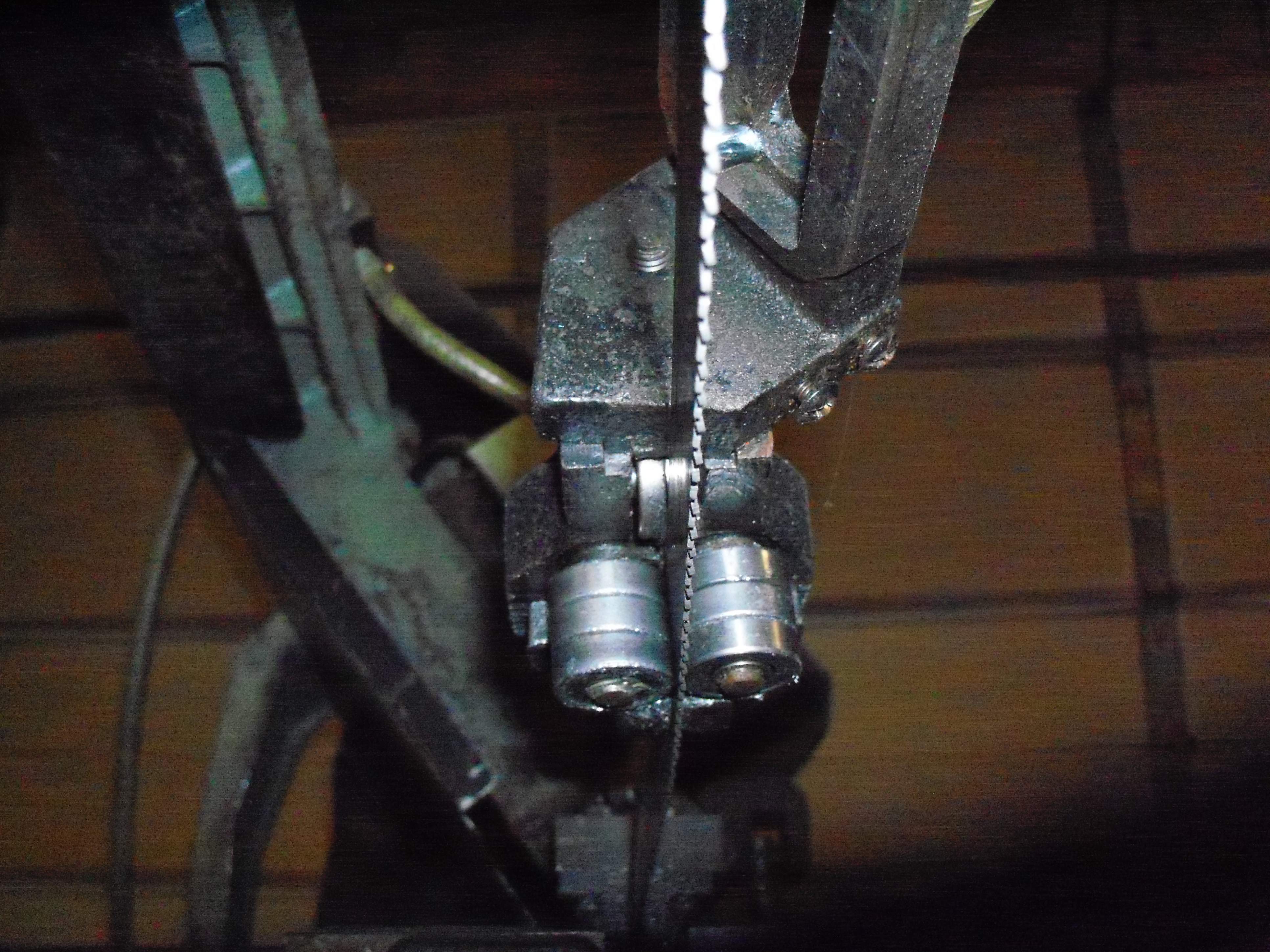

On my saw the blade goes through a set of rollers before and a set after the cut . These rollers keep the blade straight. These rollers ride tight against the blade. There isn't enough clearance for a doubled blade. Here is a pic.
Bill

The blade does not end up doubled. Not sure how to explain this in words better but you are scarfing the ends of the blades so that they overlap and maintain the same thickness. So, like if you look at some nice wood trim work, where the moulding overlaps in the field, you will cut both pieces on a 45 so that the joint is harder to see.
Something should google up that shows a scarf joint, and that is what you want so that you have the strength with the silver.
doing the sanding side by side (simultaneously) insures to the best of our shop ability that the angle is matching between the two pieces.
Went and found an article that maybe explains it better than I did, and has some other tips as well that may or may not be helpful to some. He sets his angle with a wedge, I have always just eyeballed mine, I think it really comes down to whatever works for you. Anyway, this may be worth a look for you.
