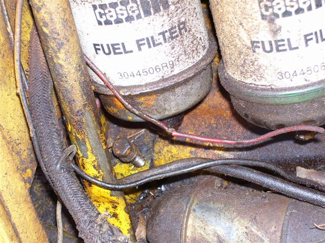

Here is what caused the lose of oil. A branch ripped the oil pressure gauge from the rubber hose. BIL took the fitting out of the block (probably a 1/8" pipe thread) and put in this 5/16 or 3/8" bolt. He didn't check for leaks but it was probably a slow one as he said it ran for another 90 minutes. You can see the bolt sticking out of the block just below the filters. Could be worse...it's only a 3 cylinder.
