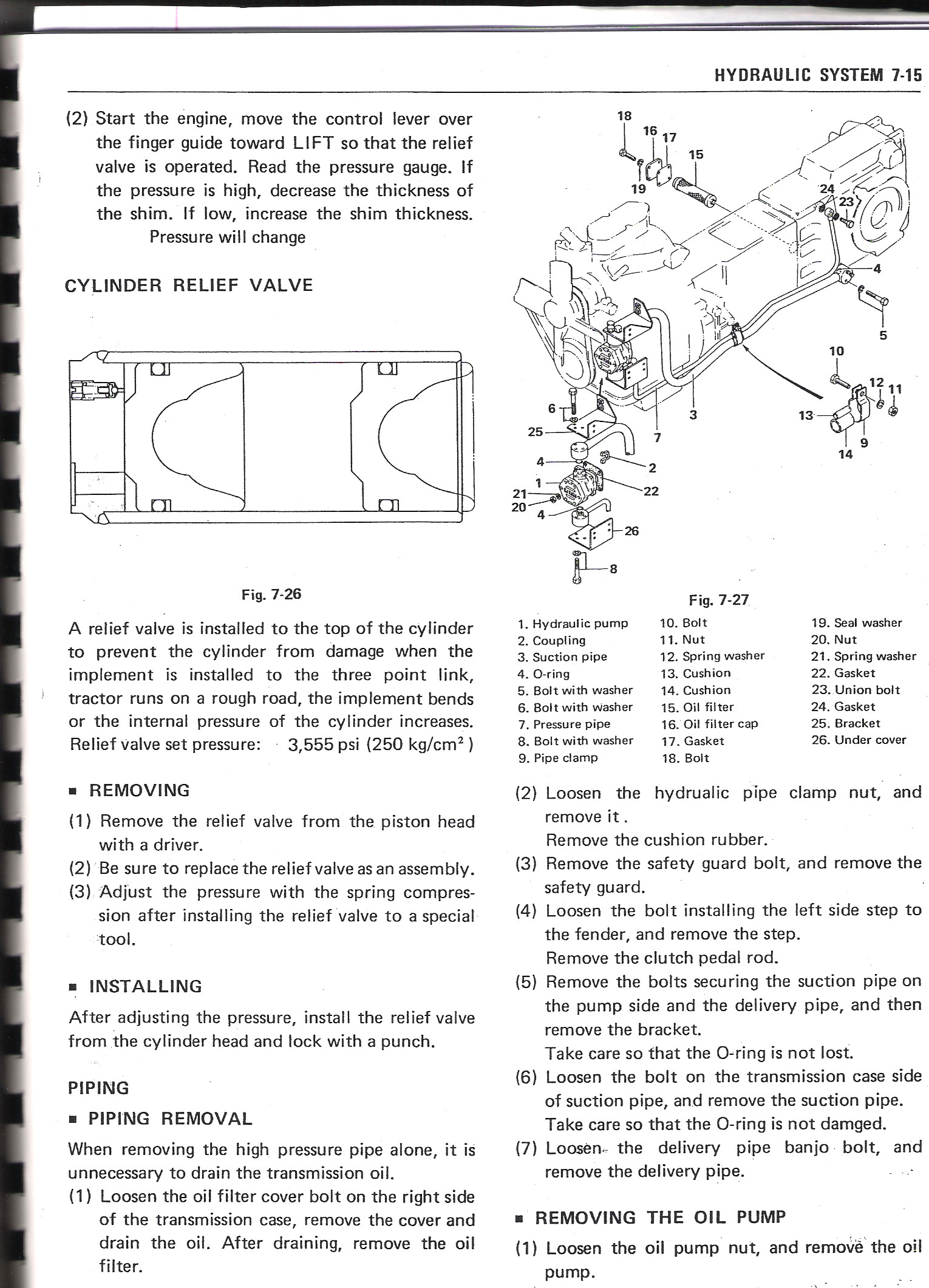

I bought a S-470D about 4 years ago and I still can't find the hydrolic filter.
And like some of the other people have a problem with condensation in the
trans, my hydrolics have slowed to a crawl, I have the radator out right now for repairs, can some one help???

hope this attachment helps you.

i have a mitusbishi mt180d, can anyone tell me how to change the hydraulic oil plesase
   / Welcome to the Hydraulics Forum! #18
look at above diagram.and remove the filter bolts.put contatner to collect fluid. you may have to bury a bucket to collect the oil.removt the screen and wash. replace screen and bolts and refill with fluid.
