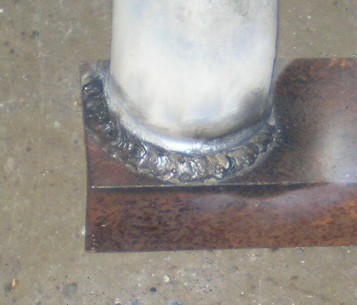

I need to weld some pieces of pipe ( 1 1/4in) to some angle iron as holders. Should I use black pipe or galvanized? I know galvanized gives off poisonous gas. But which is easier /better? Or does it just not matter.

If the angle iron is not galvanized use black pipe. Much safer too, less fumes, less headaches.

Ask anybody who does any amount of welding ,and they will tell you,
galvinized steel is great,unless you have to weld it.Then its just a pain in the butt.Even if you grind or sand the coating off,its actually still there,only to a lesser amount.Makes a real mess.If you do decide to use galvinized,i would
suggest using a mig welder.But its still a pain.If it were me,i'd just use black
pipe and then paint it,besides,galvinized is more $$$ than black.At least it is around here.

Black is easy. If you have a choice, use it.
I have a mixture of both stockpiled that I got cheap so, I use what fits the mood I'm in. Galv is NOT a pain to weld ... but it is slightly "different". When you get it too hot it bubbles and excretes a neat yellow crap. As you noted, try not to breathe.
If you use galv and don't use cold-galv paint (that stuf is COOL) cuz you want a diff color (as I do), wipe it with Miracle Water Stan Remover (hydrofluoric acid ... another bad hombre) ... it etches so good, paint sticks like a bad girl on a rich dude.

Matters a lot! You didn't say how experienced a weldor you might be, but if you really needed to ask the question, don't even consider galvanized.
Use black pipe. Clean the joint area of all oil and scale. Wire brush the area down to bright, shiny steel - especally if you're going to use MIG or stick weld with something like a 6013 or 7014 rod. You might get by without quite so much cleaning with a high penetration rod like 6010 or 6011 but clean metal is still better.

Jeez, attached is a pic of an old 2" galv el welded to some old, rusty, angle (15 minutes ago). 90A, 6010 (AC), 10 beers and no patience for "you have to follow 'these' rules to get anything done!
Cheers :)

I spent a total of 5 years building fence, we welded on everything. A little commons sense is all thats needed. We built a baseball park that took 1 year to build all the diamonds and fab all the backstops together on site using a p.o.s. stick welder on gal. Turn it up and watch it burn, 15 years later they are all still standing, no broken welds and look great. The back stops had a 10 foot overhang and the 9 gage wire is atached to the underside so they are holding some serious weight. as for the black of gal whatever is cheepest and available as long as your kids arent going to be chewing on it,lol.
