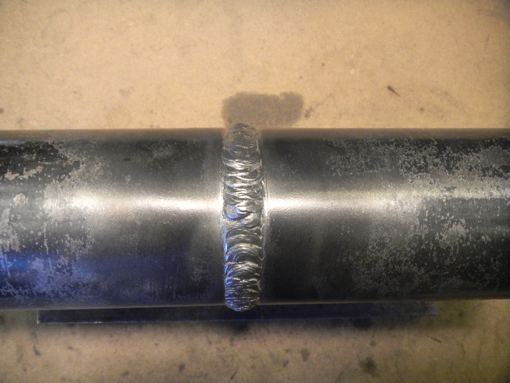

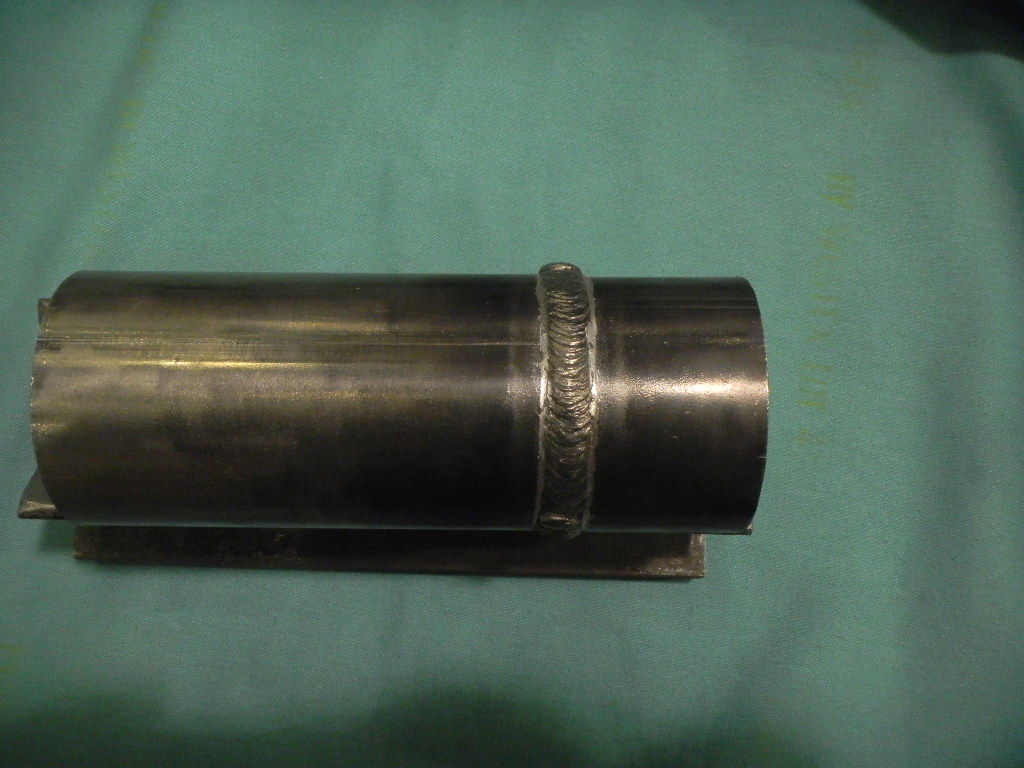

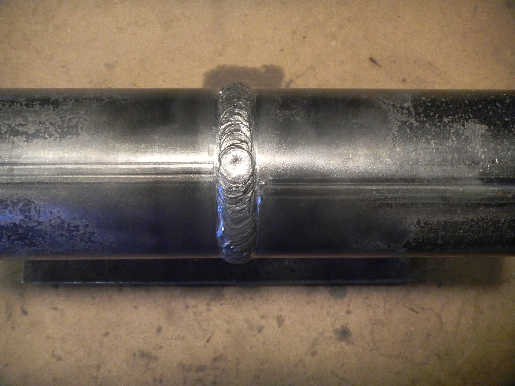

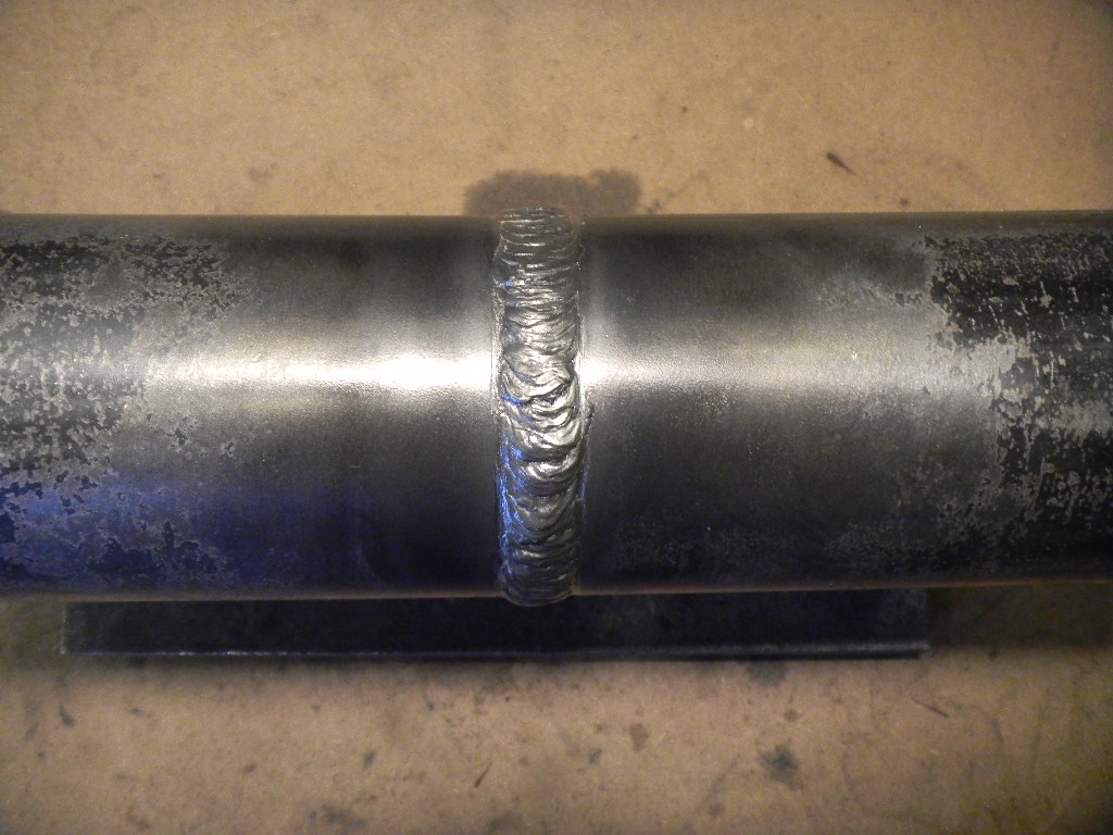

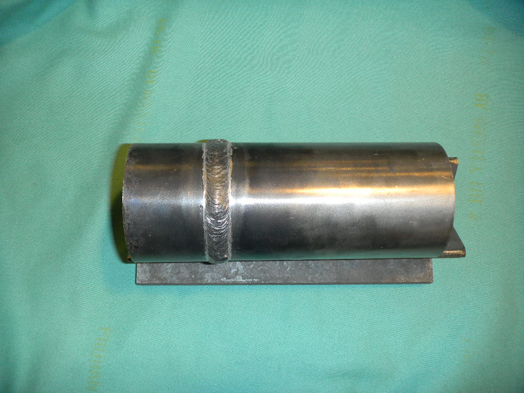

Oh I have lots of them!:eek:
to my utterly uneducated eye it looks like too much material on top, not always smooth.
Not hot enough?
Other than cosmetics, were these adequately strong welds?
could be all go and no show...
/ weld grinding tips needed #145
That pipe was done several years ago, so I don't remember any details. Most likely working on which rod I liked best with an Inverter welder, or working on which technique I liked best for small bore pipe. Either way it looks like dog sheet!:eek: I'm just like anybody else here, I make bad welds too.
/ weld grinding tips needed #146
Looks like 6011!
/ weld grinding tips needed #147

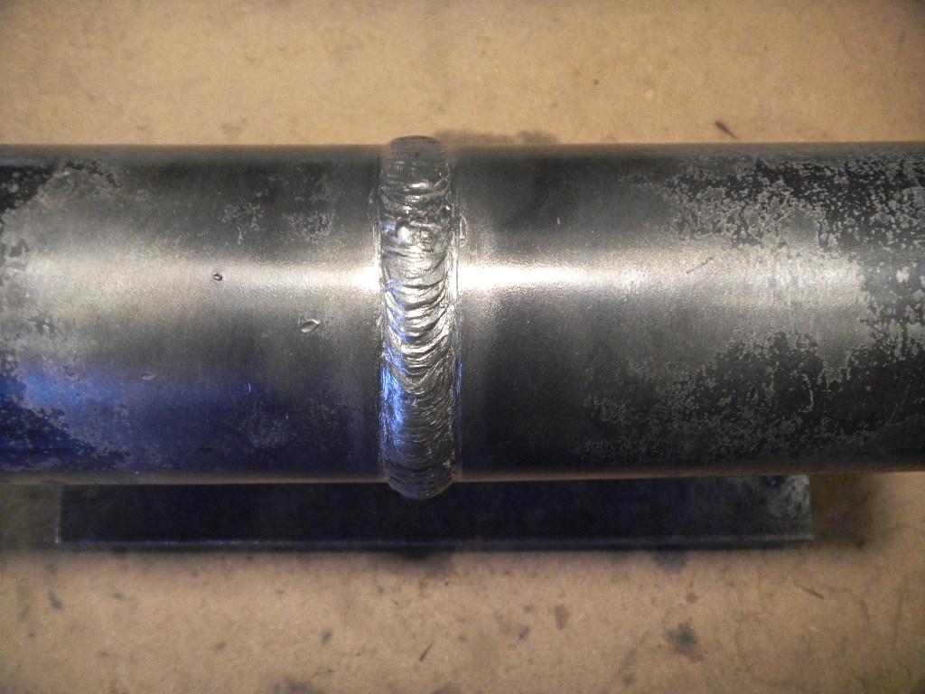

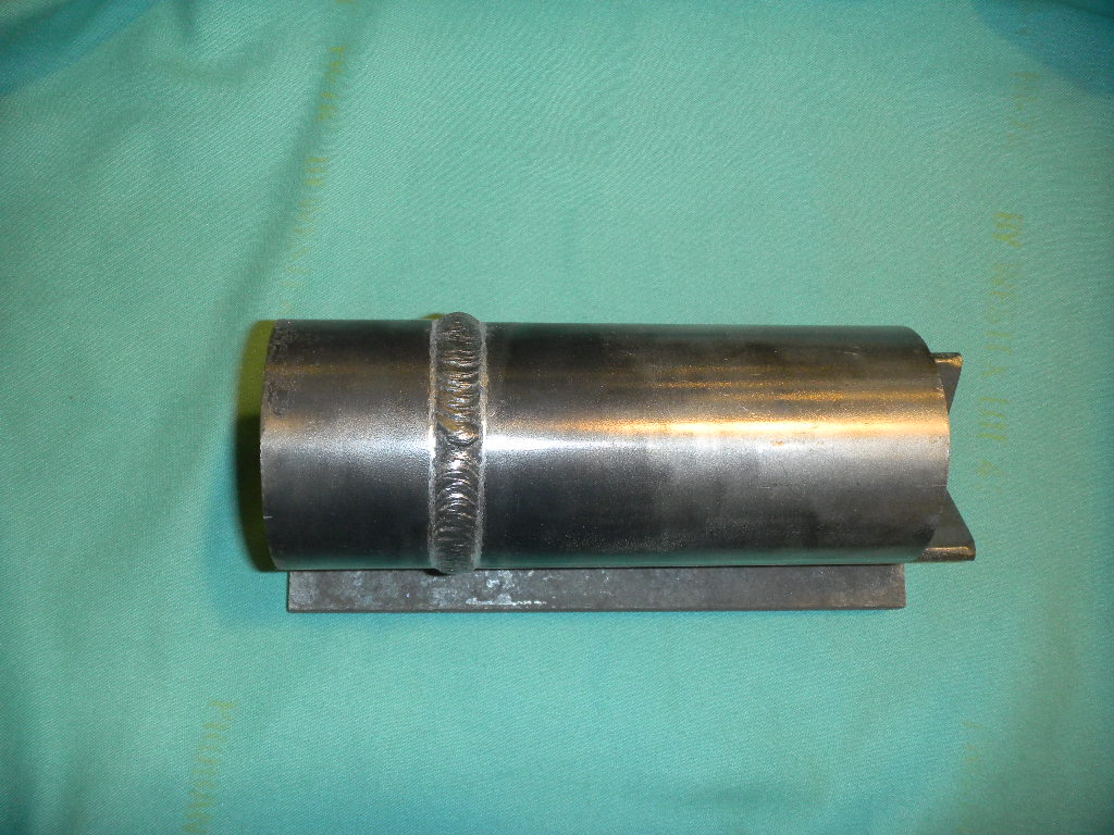

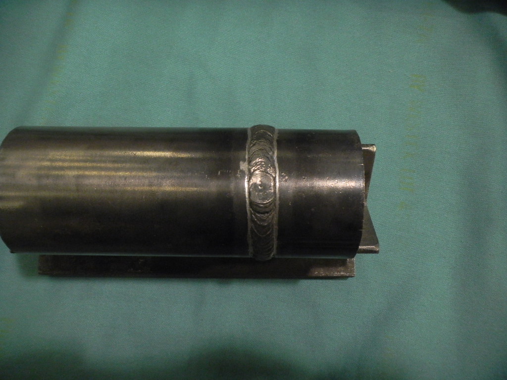

You know the more I think about this. I think it was 6010 run like 7018. Someone mentioned running 6010 like 7018 on one of the welding forums. I think this was my first attempt. Here is what I ended up with.
