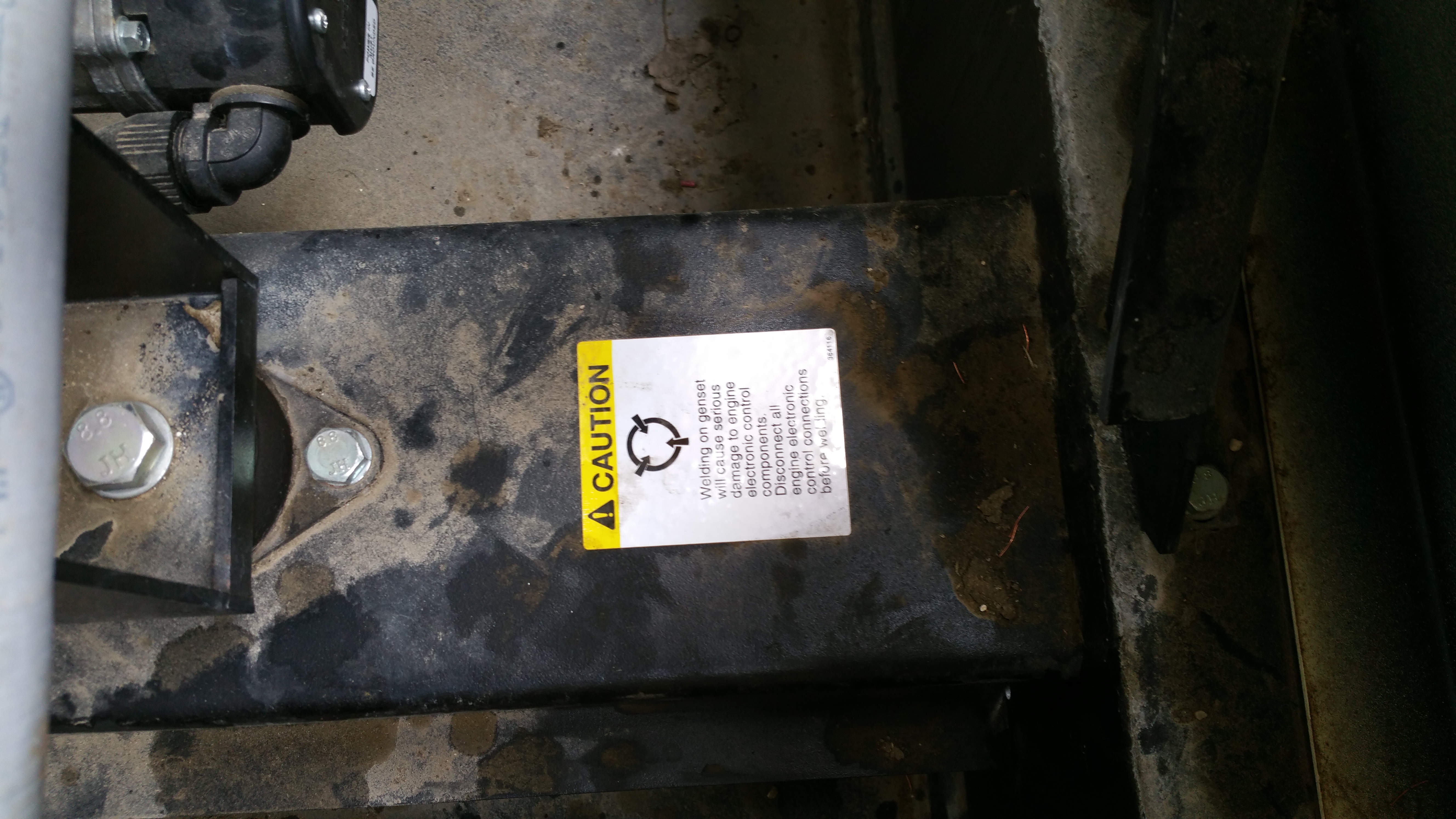

I would like to weld a tool box bracket onto my tractor and am wondering if there is any risk to the ECM or other electronics. I've seen welding ruin instrumentation at work, usually because the instrument is between the ground clamp and stinger so I want to be most cautious. Can it be done without ruining anything? Lift the battery ground clamp first then don't worry? I could build a jig and weld up the bracket then bolt the assembly on but it would be so much quicker and easier to weld in contact with the tractor. Are there threads where this has been discussed already?

Technically you need to unplug the computer. It’s the high frequency in TIG that is the biggest threat. If it was my machine I’d DC the battery if I wasn’t TIG welding.....that’s only if the ECU wasn’t easy to get to. If I was TIG welding I’d DC the battery and unplug the ECU without question.

At the very minimum, disconnect the ground cable on the battery.
