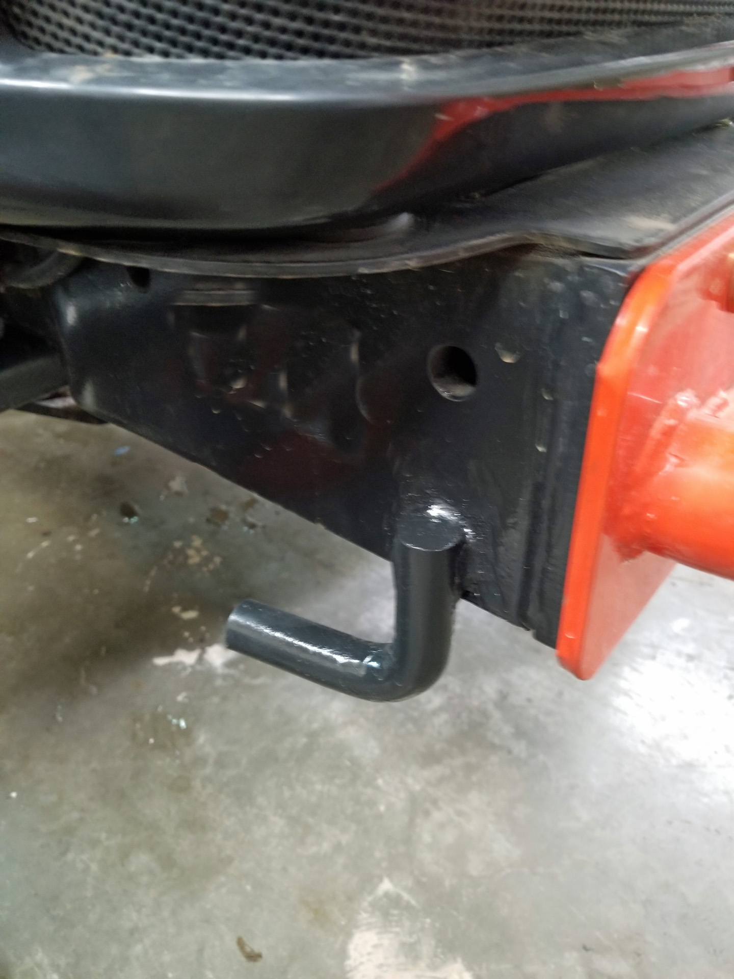

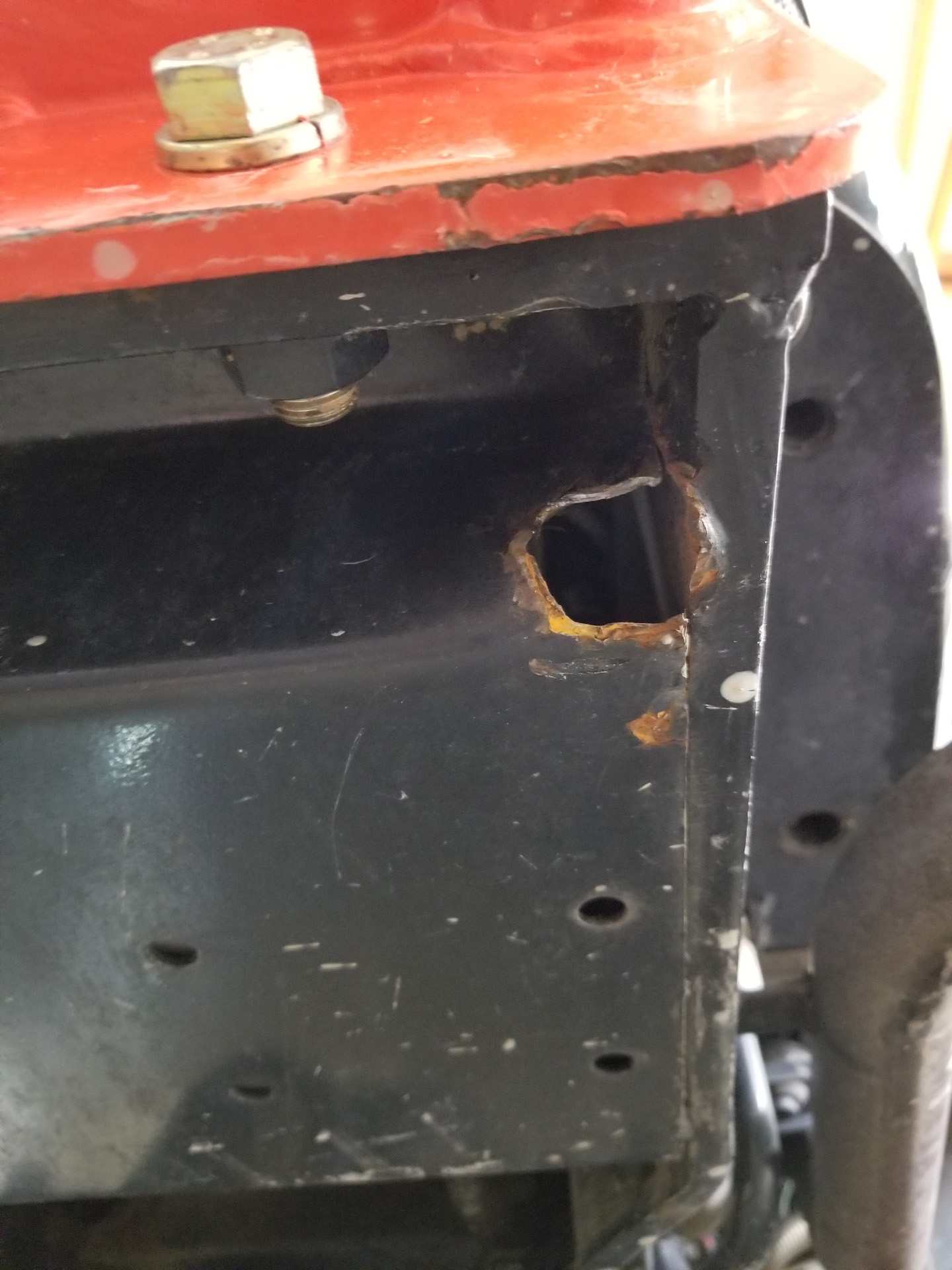

Ive had 2 occasions to weld on my DK45 and both times i unplugged rhe computer module and unhooked the ground on battery. Better safe than financially sorry. Just yesterday i had to reweld the tow hook on the tractor. Kioti didnt place it originally on a very sturdy part of the frame. They welded it to part of the thin metal battery support pan. It tore free when pulling a car out of ditch last winter. I welded it to part of the main frame up front. Its not going anywhere now. The original tow hook was welded to the 16 ga battery pan and one slight tack weld to frame. 20190403_113147.jpg
the new location is on the 3/8" thick frame. 20190403_113138.jpg

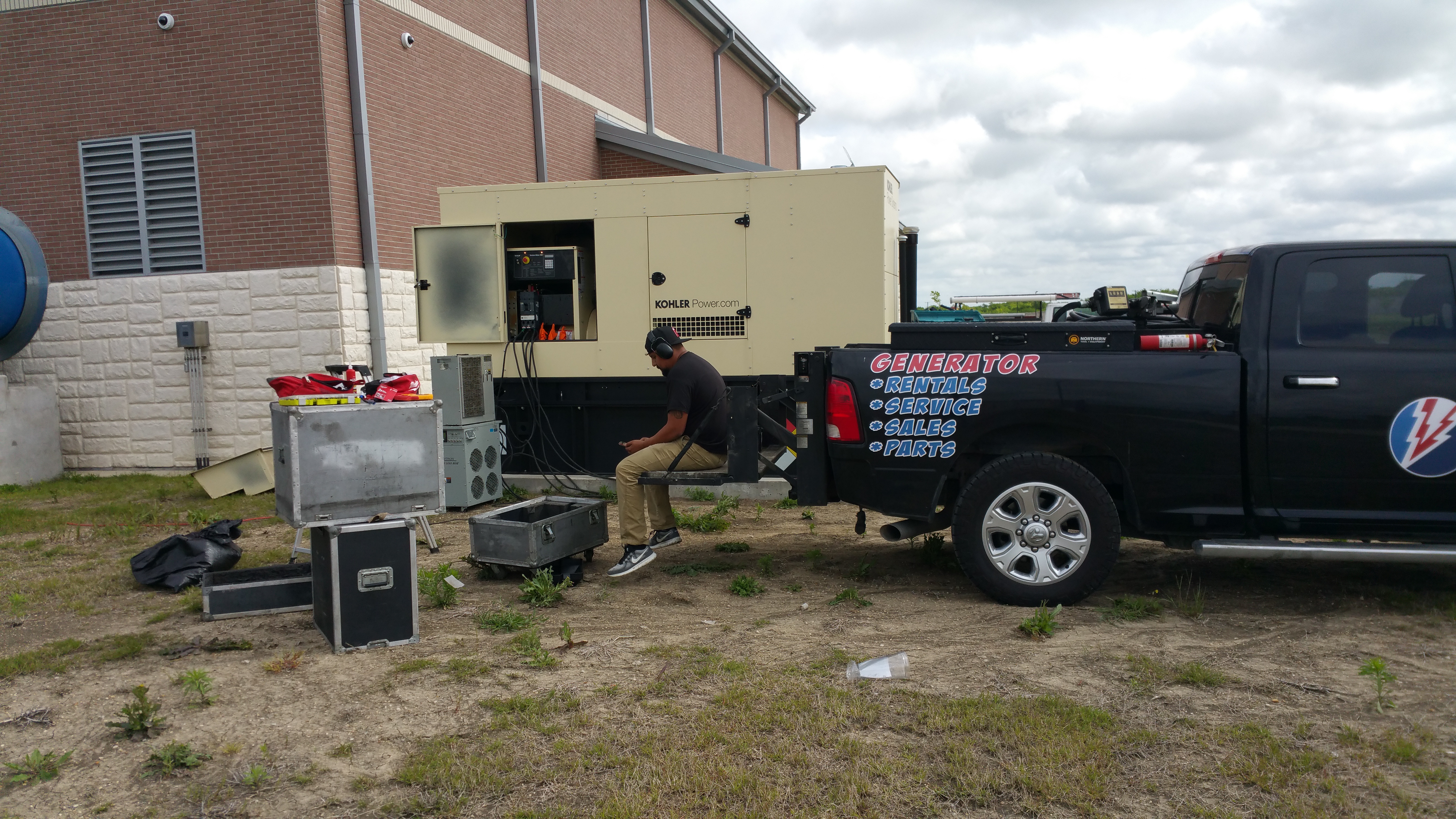

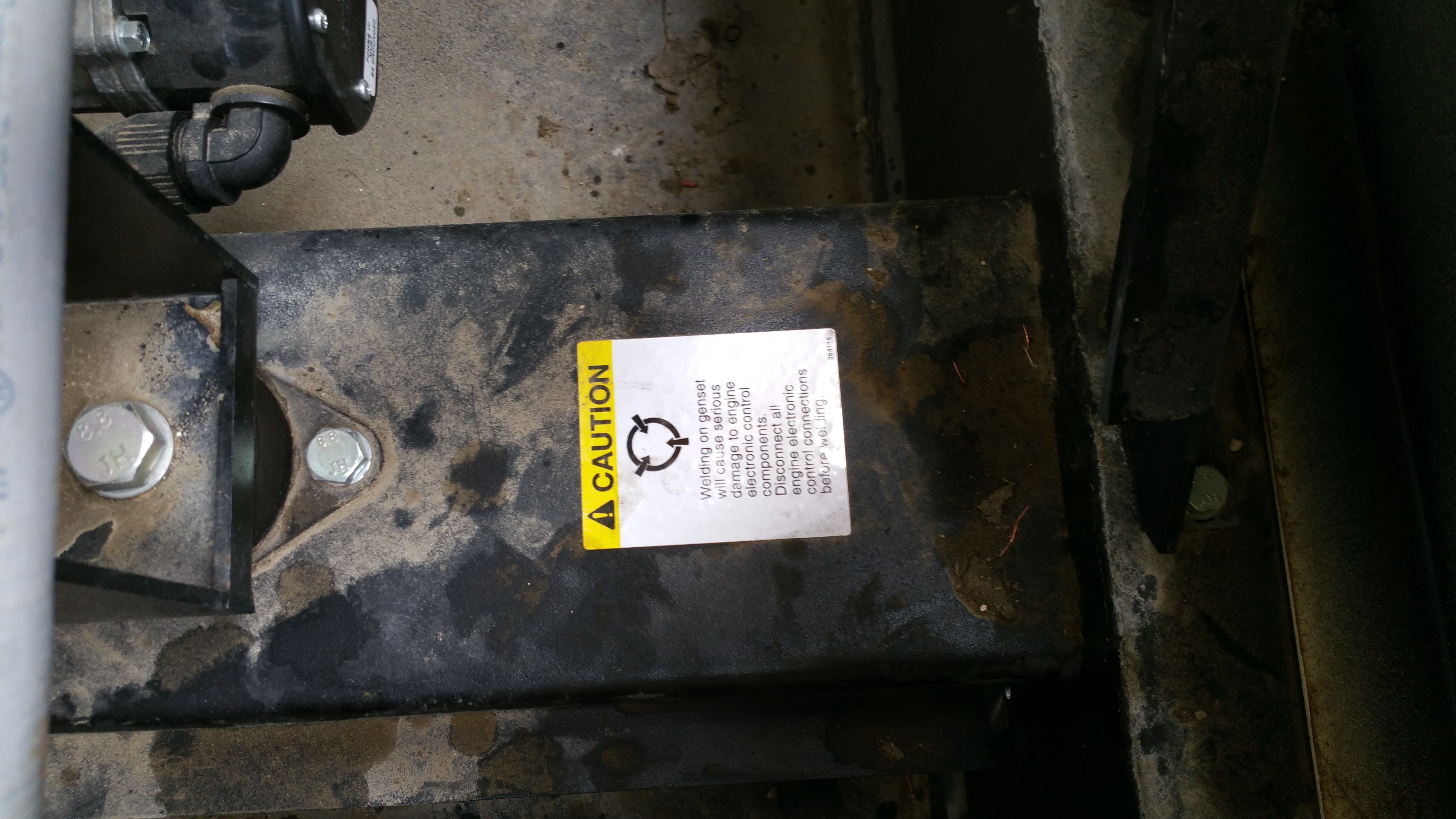

At work a few days ago:20190416_101405.jpg20190416_115657.jpg
Had an outfit come out for a load bank test on this 250 KW genset. While looking around found the tag inside the machine. I thought I have seen those before but wasn't sure. Side note, the air being blown out of one of the load banks was 431 degrees F! Twenty more and we could have caught paper on fire.
