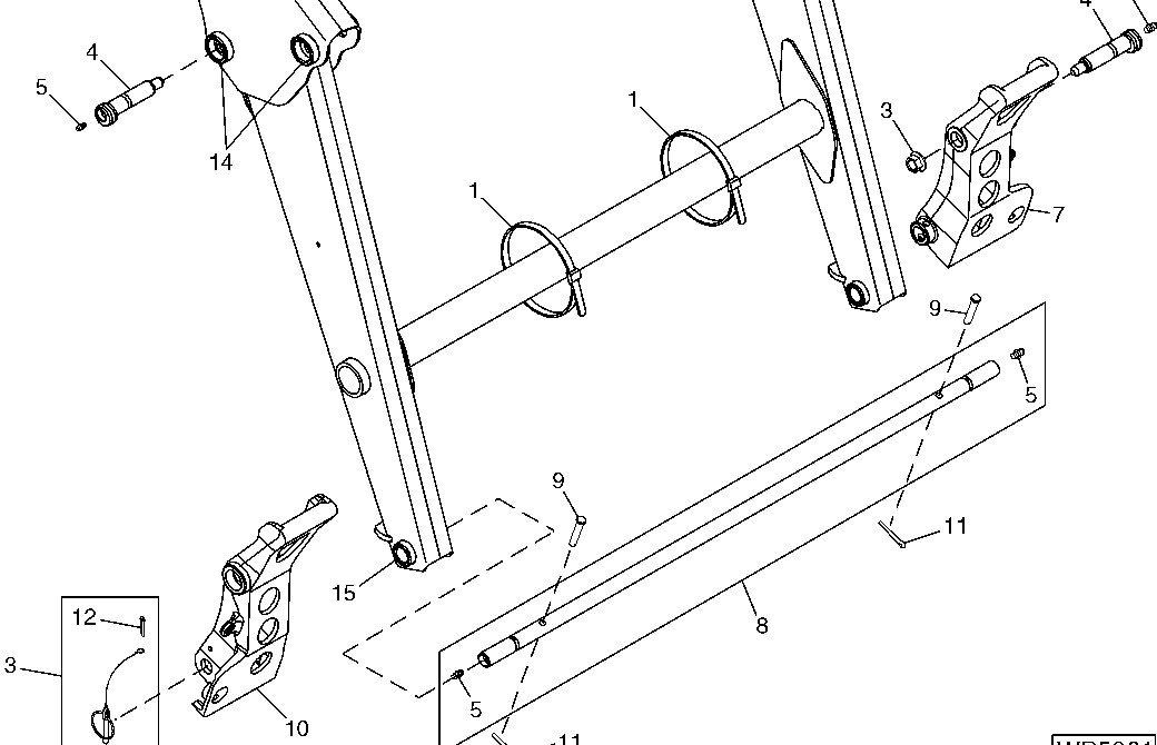

what I am trying to do is convert an old FEL that doesn't have the quick attach to the quick attach style on the current JD tractors.
Now I understand, I think.
I'd start at the JD shop and with your loader model # see if they can match pin sizes with a newer carriage casting.
Hardest part is going to be getting pin sizes to match older equipment to the new stuff.
Last resort you could liquid wrench out the old pin bushings and weld in ones that will fit the new carriages.
Again, If I'm finally on the right track as to what your trying to do is to find the parts numbered 10 and 7 to fit your loader ?

You can buy those brackets from your Deere dealer.

I looked at this too a while back. Pretty much found all the parts that would be needed from Deere. The downside is that the booms on the 70A are not the same distance apart as the booms on the 200 or 300 series loaders... so modern JDQA implements would not fit on the modified 70A due to the spacing difference.

The loader model number is a BIG help! John Deere 740 loaders were available with pin on buckets or Quik Attach. These use what John Deere calls the 600/700 series mounts. In pin on or Quik Attach.
On the bucket, your FIL has, is there a plate on the inside mounts of the bucket for the lower pins held on with three bolts? If so they can be replaced with Quik Attach latches. BW15457 std duty or BW15242 hd. These are whole goods bundles that you buy from JD Sales not Parts. John Deere also sells the mounts to weld/bolt to attachments part numbers AW28034 & AW28035. You will also need the Quik Attach latches for these. Aftermarket also makes the JD 600/700 series latches.
If you need the brackets for another implement, aftermarket will be cheaper than JD. Look for 600/700 series mounts or sometimes they will be called JD640 style mounts (JD 640 loader is in the 600 series family).
