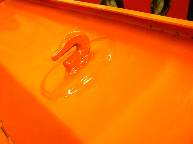

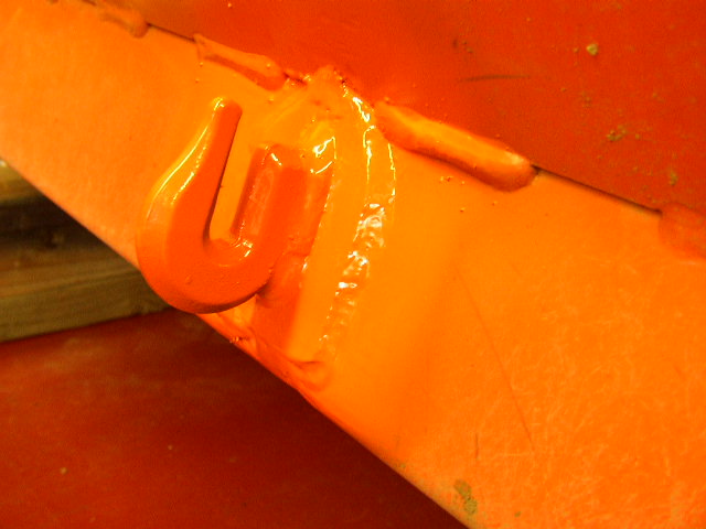

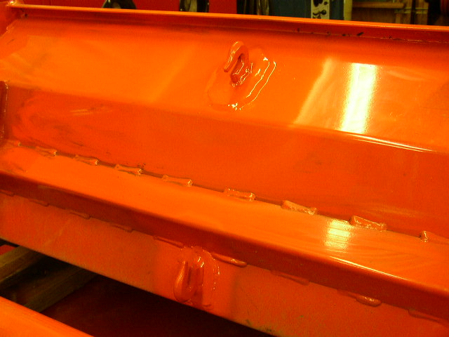

Yet another 'I welded on hooks post'. I thought it would be fun to see what you all thought, and what I did wrong or did not think of. I kept the hooks centered since this is a small machine. The low back hook will give me a bit more lift capacity and visiability over the top front hook which will be used most of the time. The FEL is on a B7510 so not much lift capacity to start with.

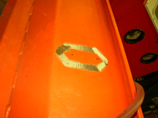

Here it goes, cut out some backup plates, welded on the hooks and sanded off the bucket paint....

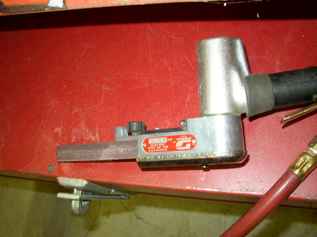

The 'air file' is one of my more favorite tools, it can remove metal, wood, paint etc, fast or with a fine belt or feathered throttle it can be very gentle.
Next time, take all of the paint off. I left the paint that would be under the plate but away from the weld. It smoked when heated and caused a bad weld, which I ground off and did over.
.. Painted Orange and off we go..
