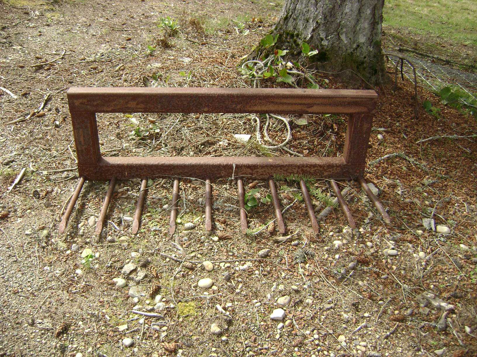

Ron years ago I built a brush rake to pick up cut down black berries. I used cold rolled round stock.
