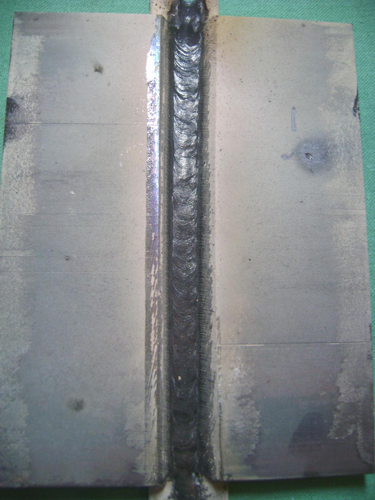

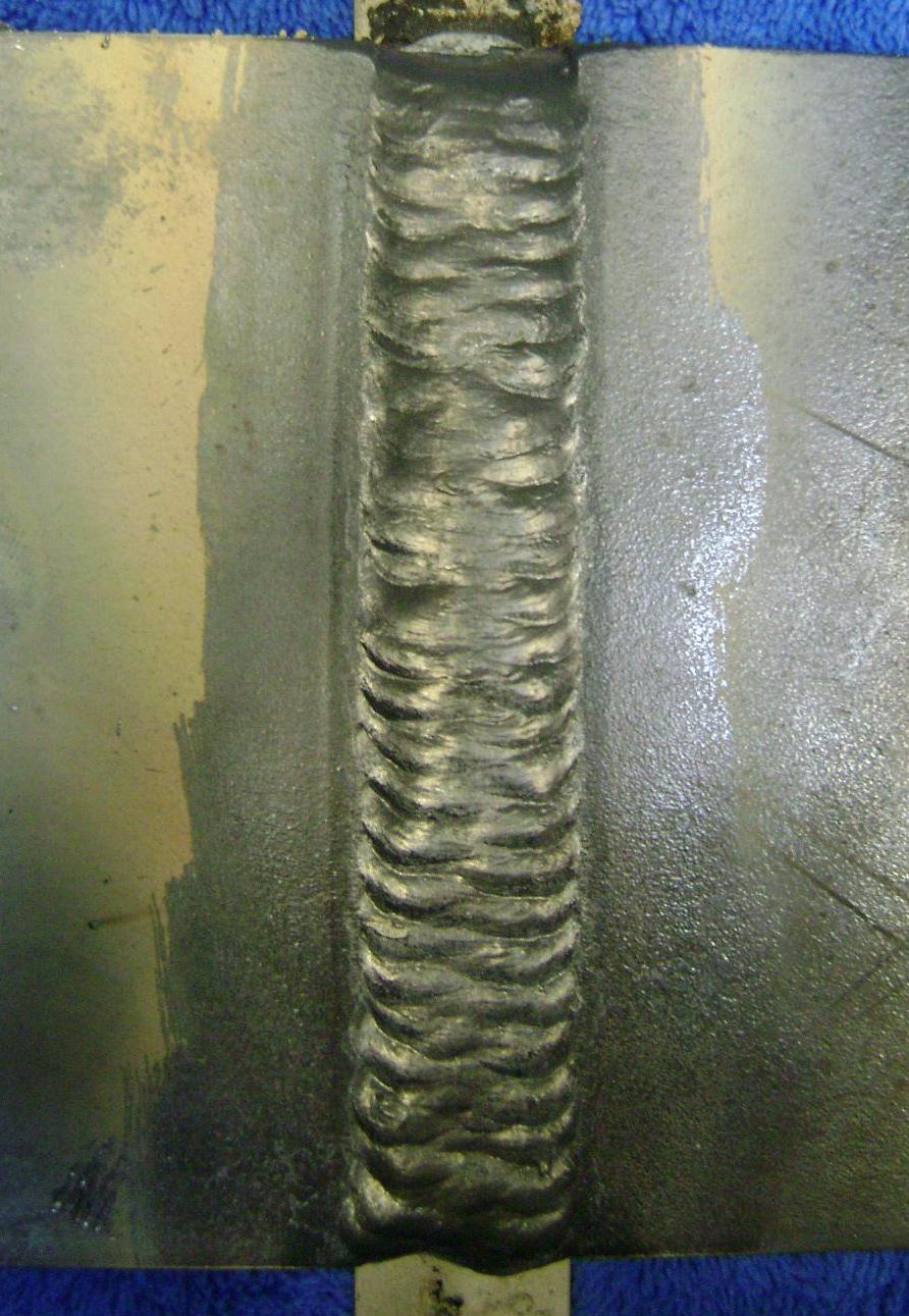

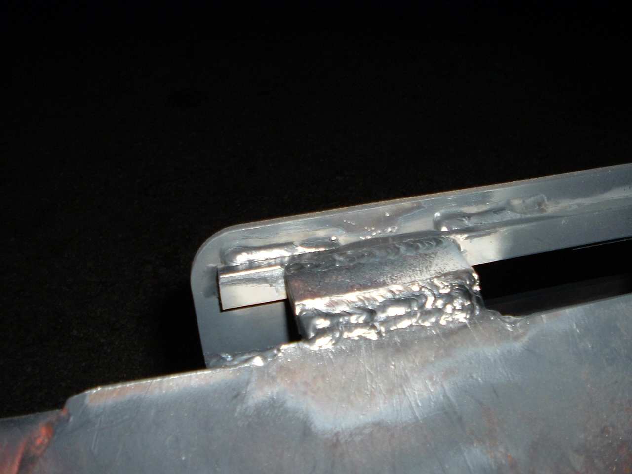

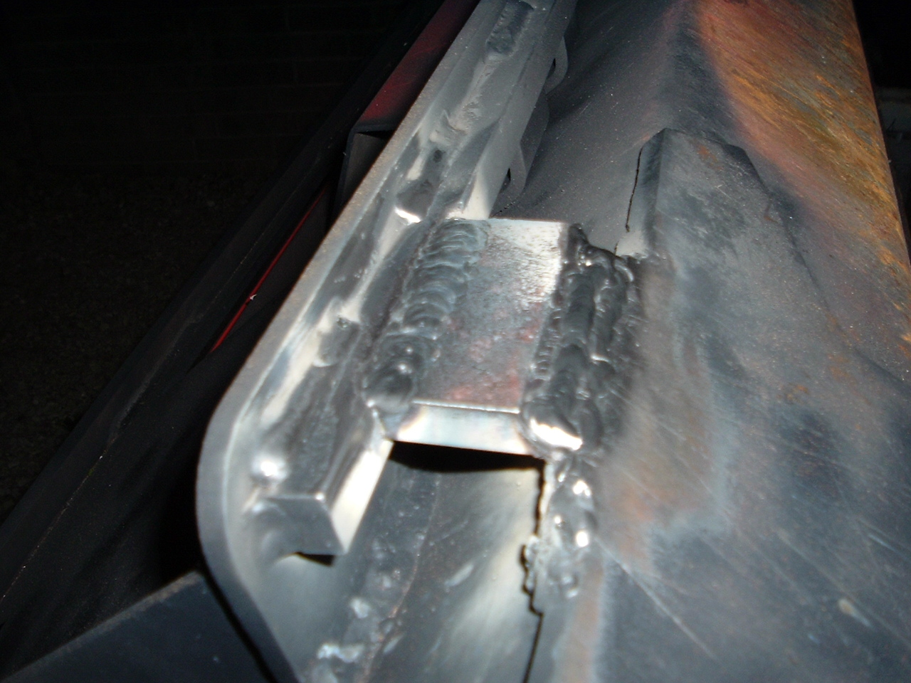

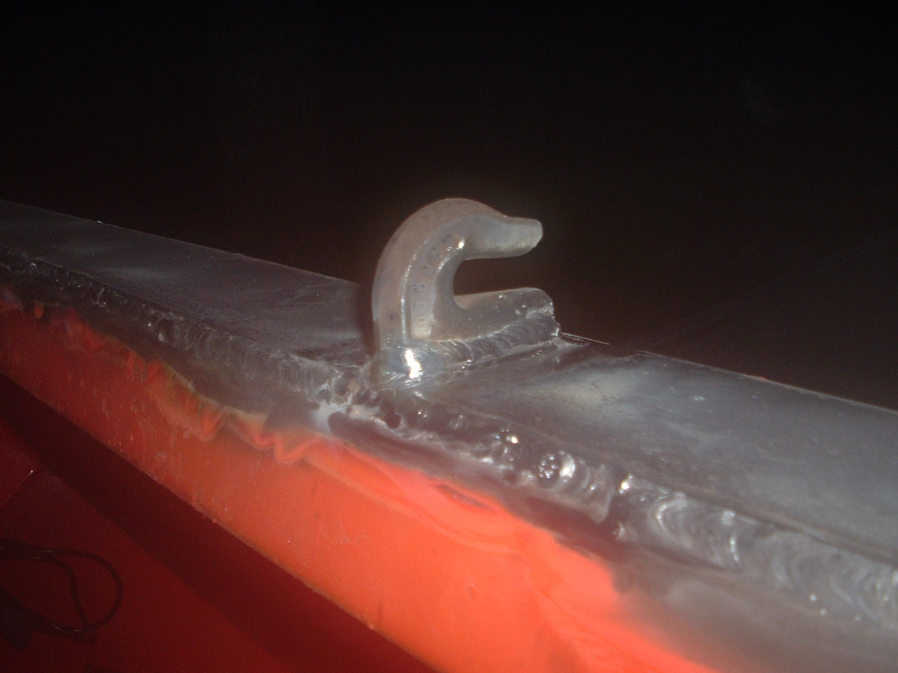

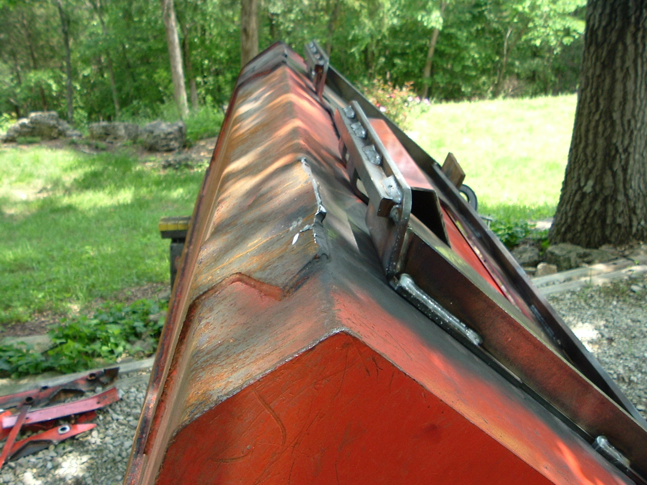

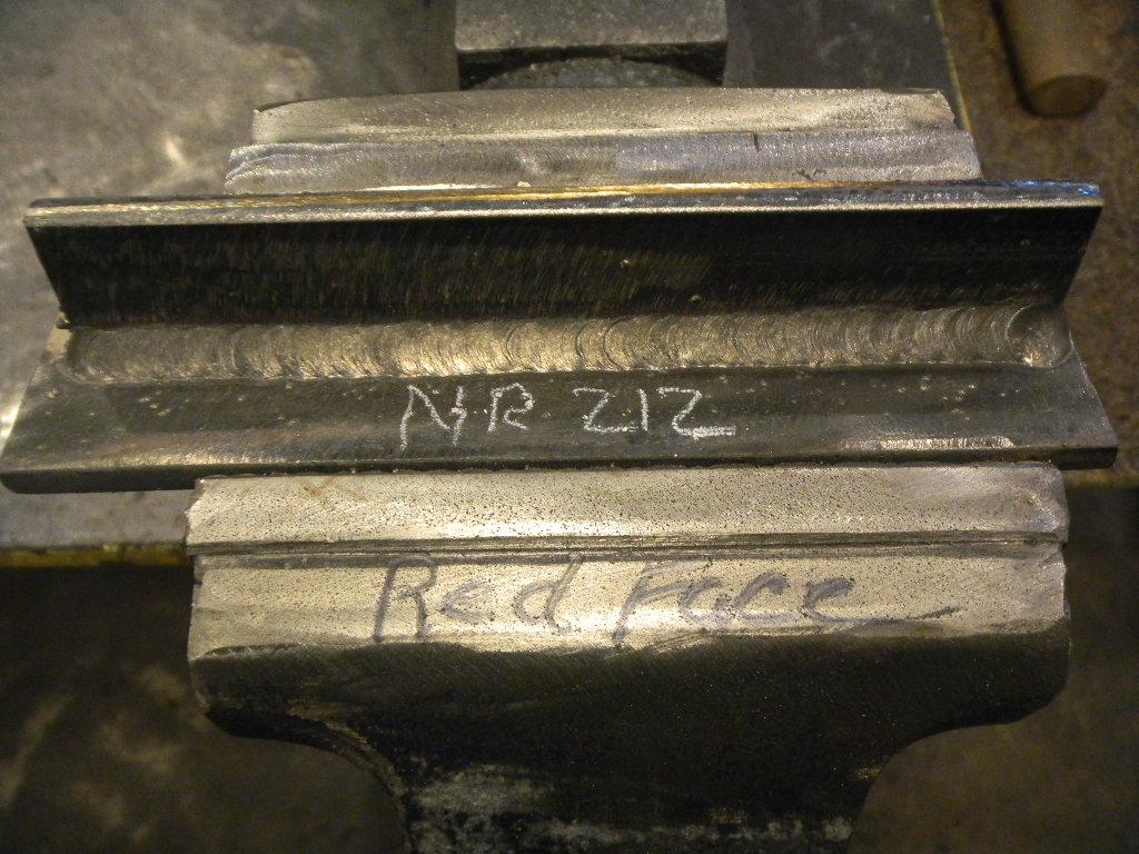

Here is what NR-212 looks like.
First picture is flat.
Second picture is vertical up hill.
Third picture is over head.

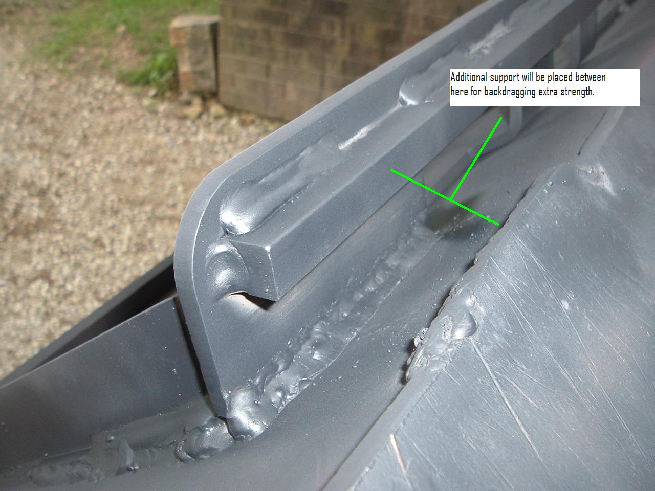

Consider drilling the qa plate on the flats and then plug weld it as well as doing the edges.
I drilled three 1" (?) holes on either side of mine (5/16" plate) and plugged 'em ... and then ground them smooth so the tractor-side qa would mate with no issues. Lincoln PowerMig 215 ...
Hasn't come loose yet ... :D
