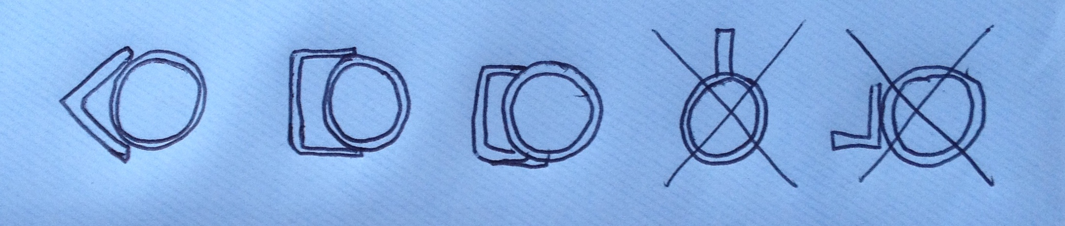

Stress risers can increase the stress at one specific location, causing problems. Lets say you have a trailer hitch "torsion tube" that is designed to flex a little and thus protect all of its mounting points by lessening road impacts (almost like a secondary 'suspension'). It is flexing continuously below the fatigue limit of that specific steel and can do this forever. If you weld something out in the middle where it flexes, you just created a hard point, and the material just adjacent to that hard point has MUCH higher stresses, perhaps beyond the fatigue limit, then cracks can start. If your weld is undercut at this hard point, even worse.
So back again to the Reese trailer hitch, which Teikas Dad has decided NOT to weld on (I think). I suspect TBN members are curious, they want to know, they want to build, create, increase understanding. As I said before, either reduce the load on it by adding structure, or increase the "torsional section" of that member (reducing the twist on it). Here are a couple ways to strengthen it. Method 1 is an OK newbie project (if the welds are good). Method 1 could even be bolted, which may even satisfy Mr Reese.
If it's not possible to add more structure (spare tire in the way etc) and you MUST weld on it then do it like this. These are methods to increase the "torsional section". The two crossed out do not increase the torsional section (not much) because they are not "closed". They increase bending strength but not torsional. You can skip weld this, but they should be good welds. But trailer hitches should always have good welds, right?
Well this thread has run its course I think, so I hope nobody minds my typing a book onto the end of it, but it was a good example.
