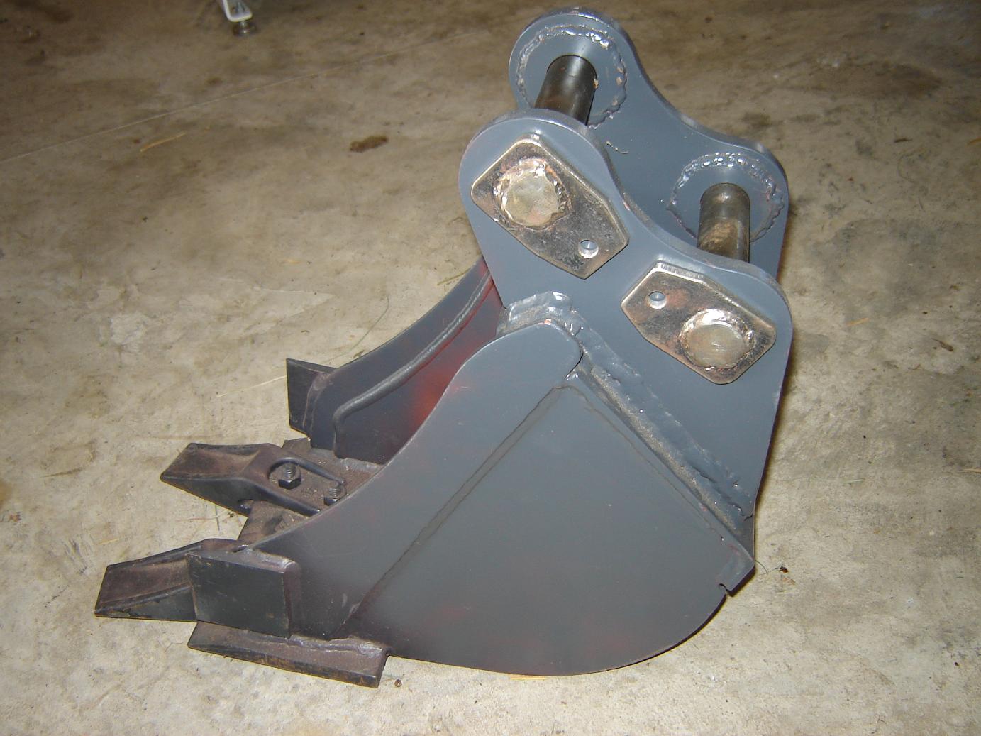

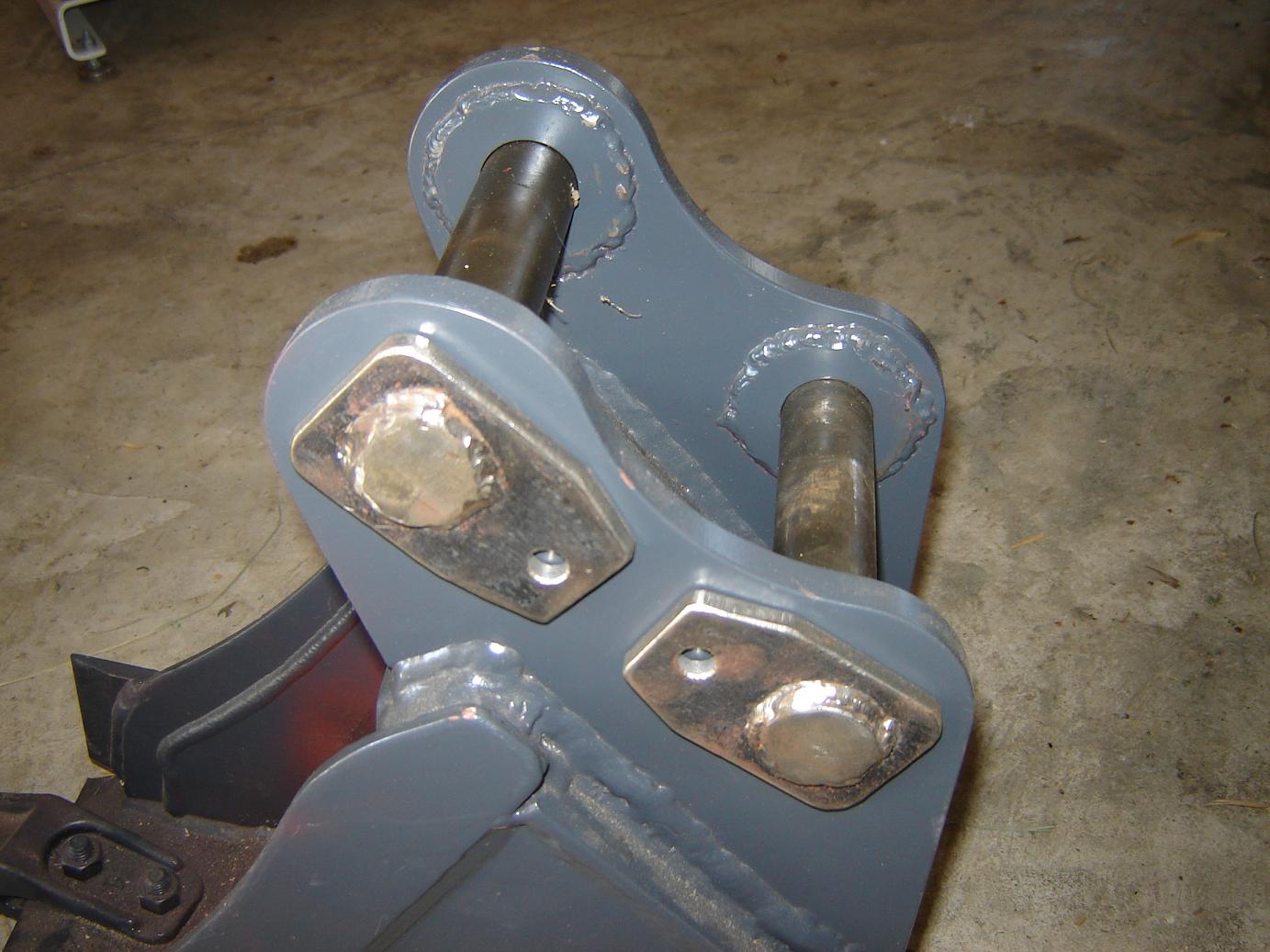

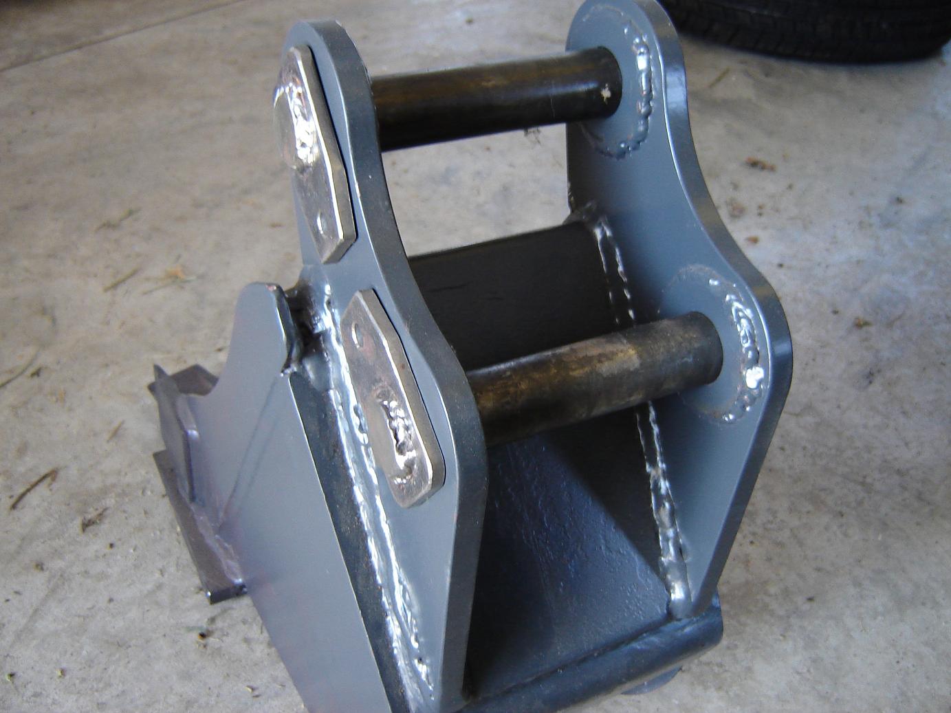

Pictures of the almost finished bucket.
All that remains is to drill and tap the ear for the pin retainer bolt. Bucket-1.jpg
   / Weldable Backhoe Pin Bushings
#16
GE222...looks good. Nice job.
Even though it eventually wears off, paint always gives things that finishing touch too.
I may try and take some pictures of mine for the benefit of the group as I put it back together.
~Greg
