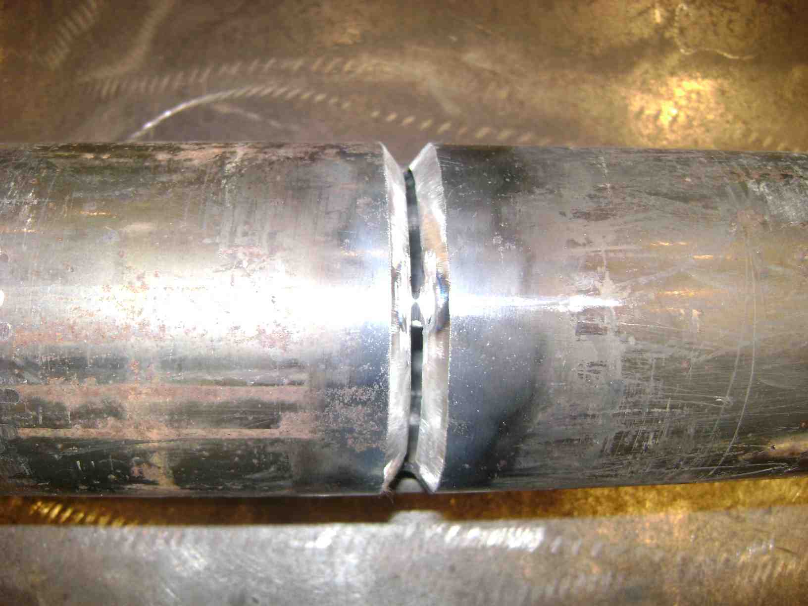

The first video of the 2G by Welders Lens (Treadway) looked like he had a very thick land on the pipe. I would have expected to see a bit thinner land on that. Not a knife edge, but that looked more than I expected. Maybe an optical illusion what is your opinion?

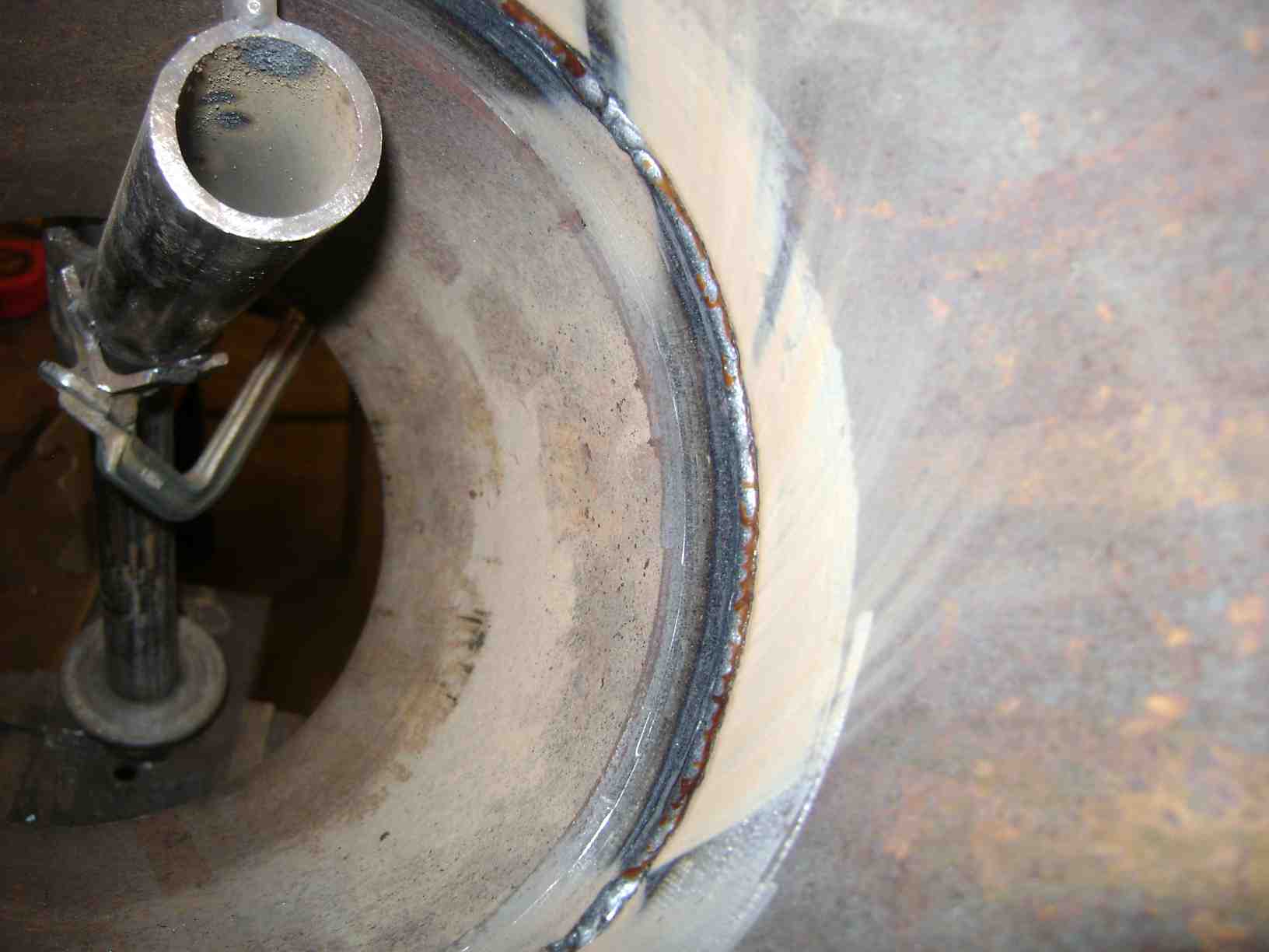

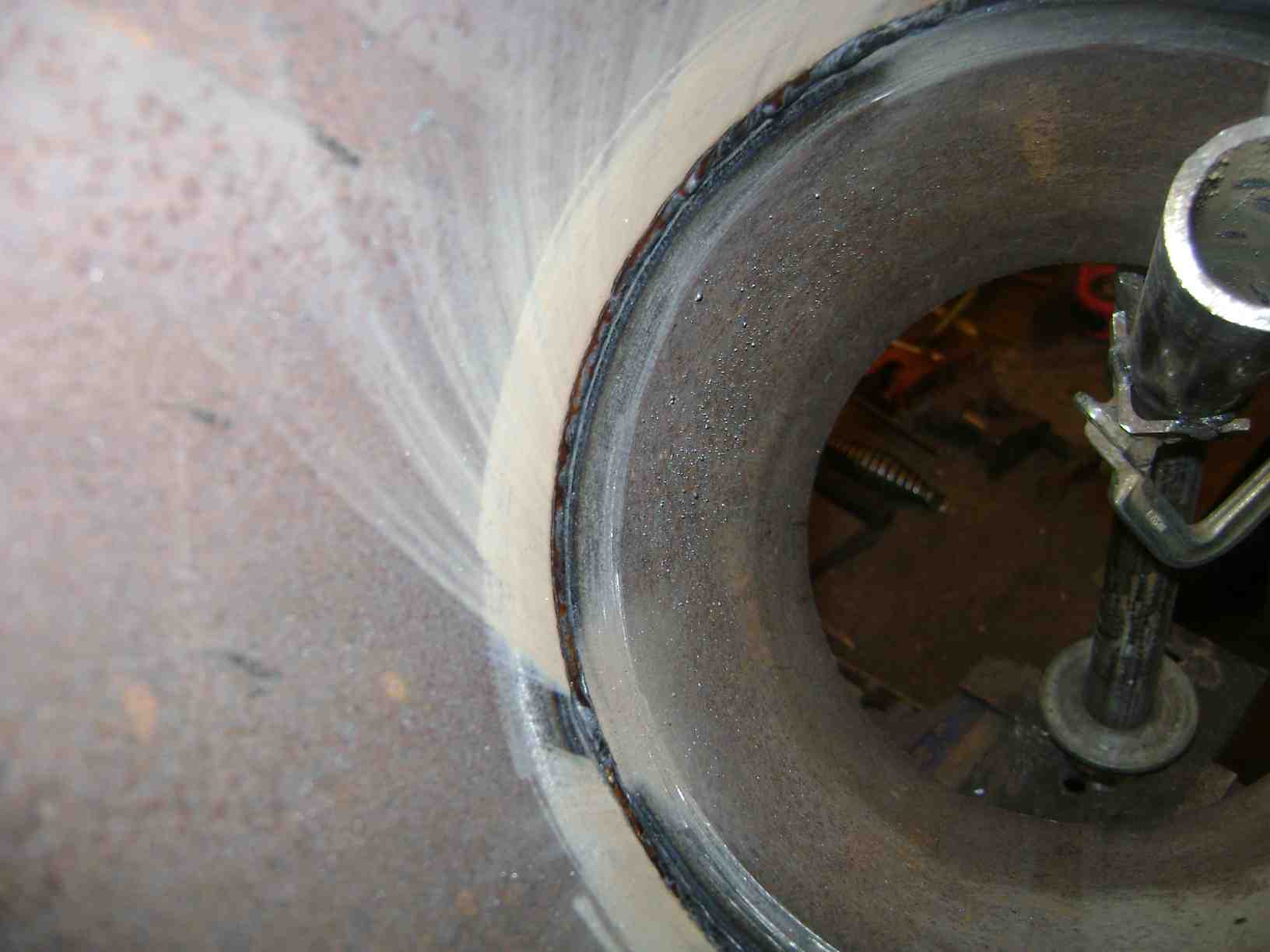

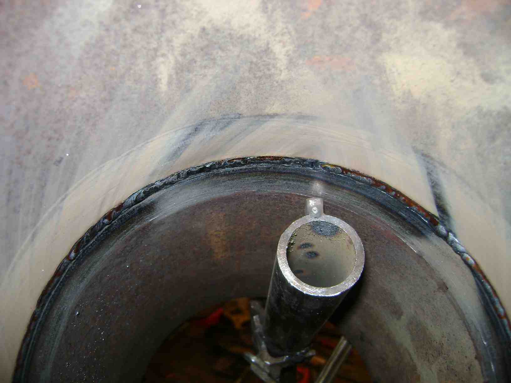

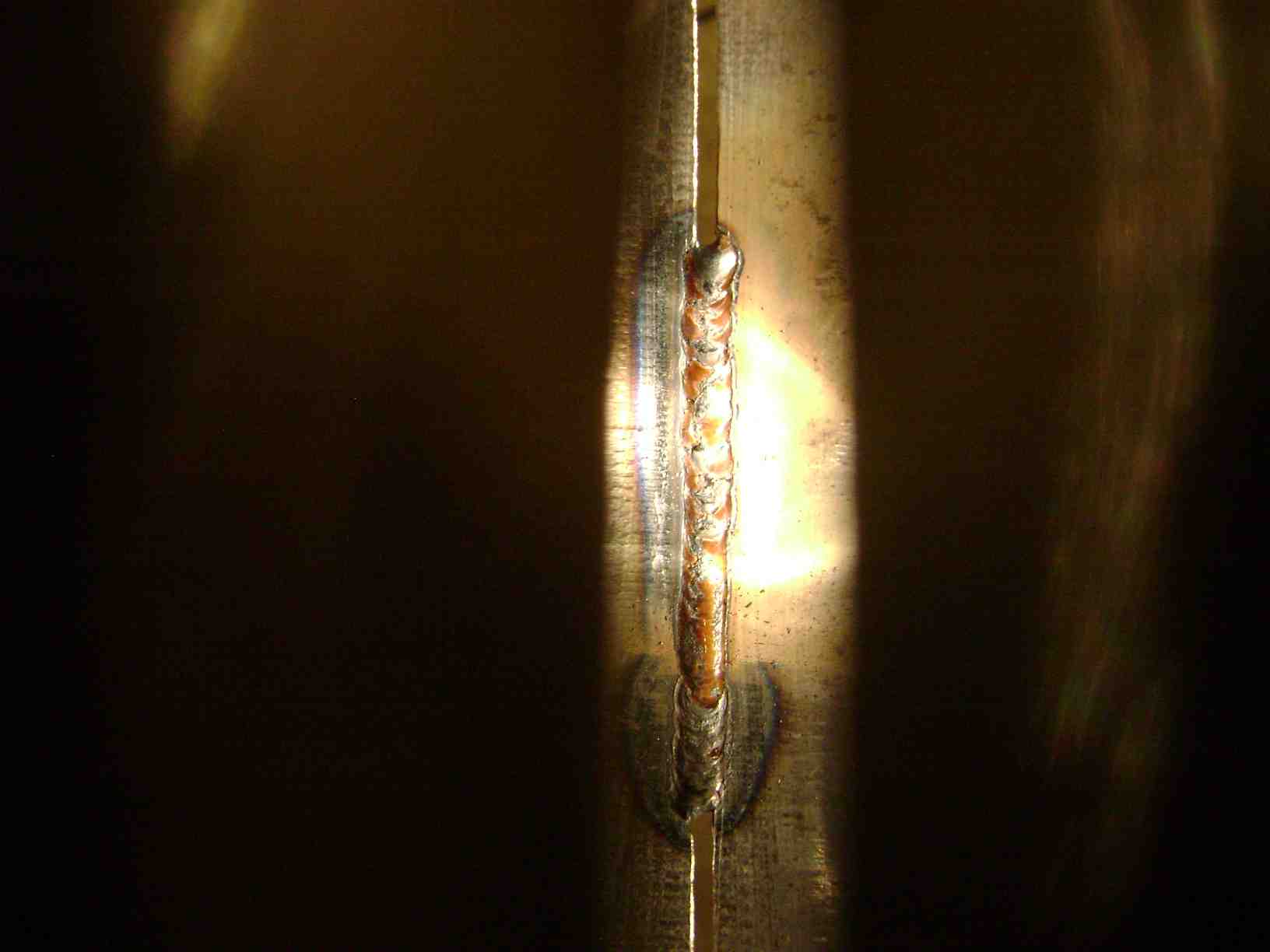

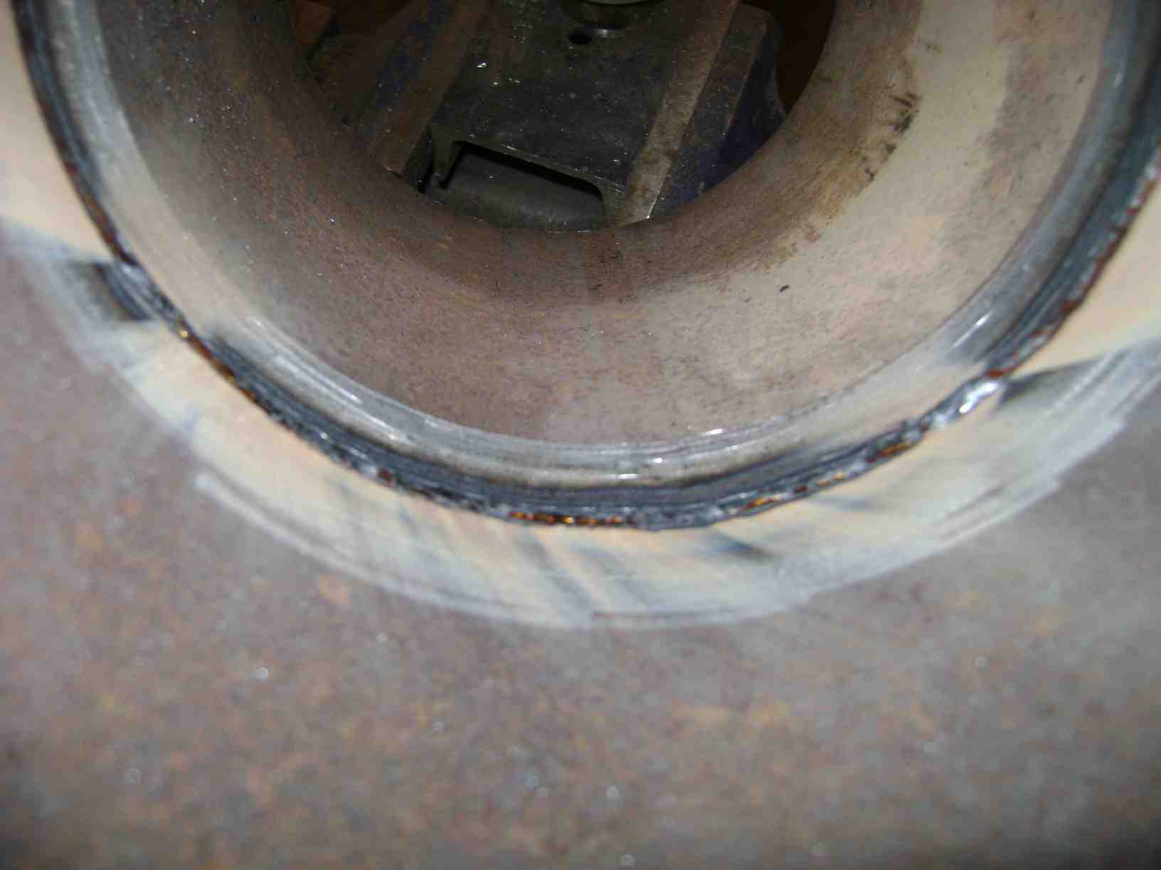

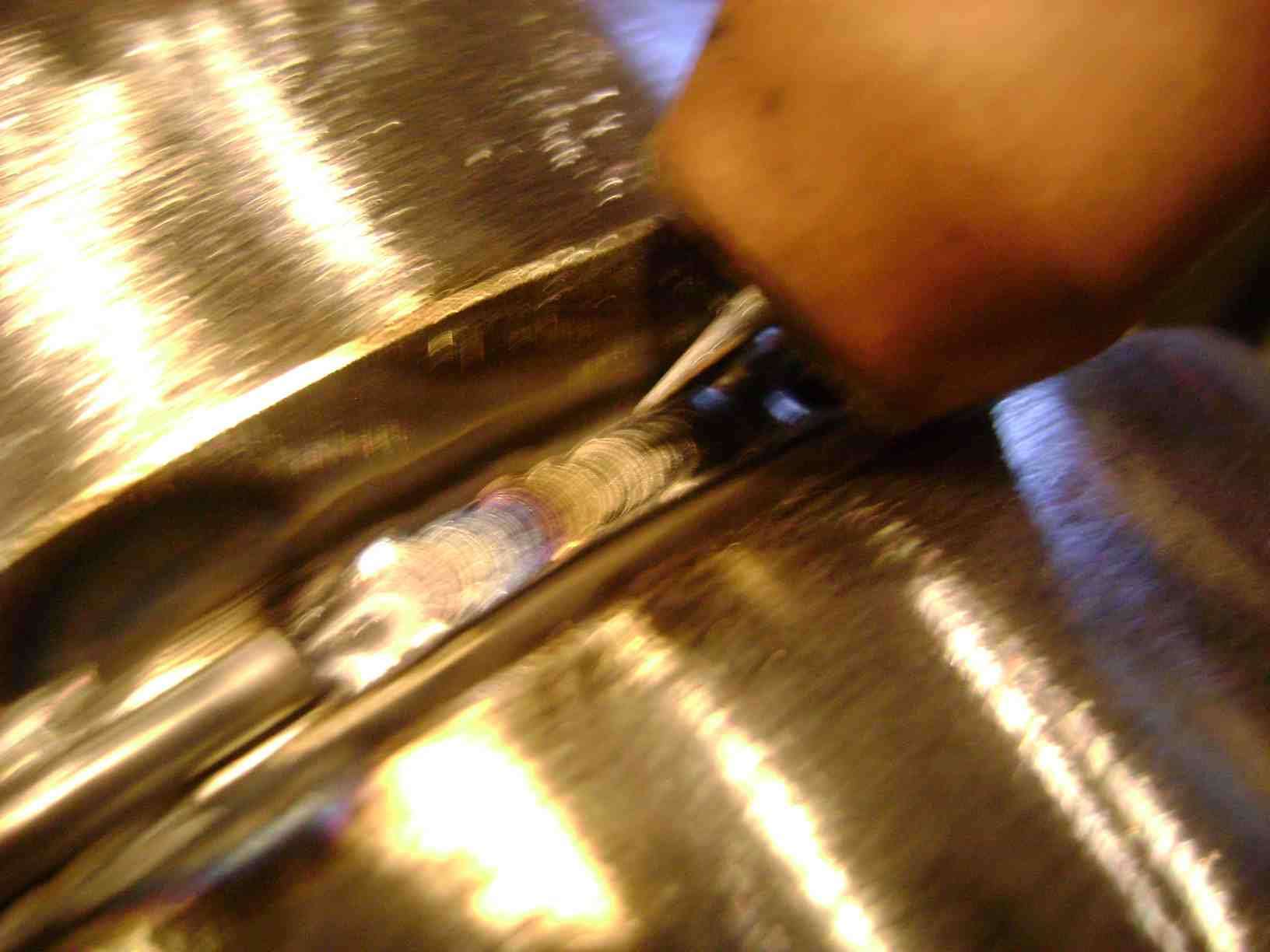

I use about 1/16" land, and a 7/64" drill bit to set the gap. I use 1/8" filler for the root pass. I use 3/32" filler for the hot pass. I do not go up more than 10-amps for the hot pass! This helps prevent suck back! I run about 95-amps. With a very long sharpened tungsten. Most of the time I use the lay rod technique, but I have been known to dip the filler too.;)

Always thought I'd watch videos but never could really pay attn to TIG because I had no EQPT to apply it to. Man those guys are GREAT teachers. Really looking forward to TIG. I've done a lot of gas-welding (but not in 20 years) and always wanted a TIG. Wish I could wind the clock back and get a TIG 20 years ago.
One thing that struck me is that this TIG puddle (& bead) appears to have a very little "penetration" into the parent metal. It seems to me (on a theoretical level) like all you'd have to do is penetrate one molecule into the crystalline structure, and two pieces become one (ignoring flaws for the moment). I understand there can be a grain structure that differs at the edge of the melt. But what is it - that is different - between a low-power MIG weld and this tiny TIG root weld? Isn't this guy welding with 95A? That's not a lot of power going into that parent metal.
I have no doubt this is stronger, and better result. But what's the deal with penetration? Does penetration come into focus with MIG simply because MIG is crude and un-controlled?
