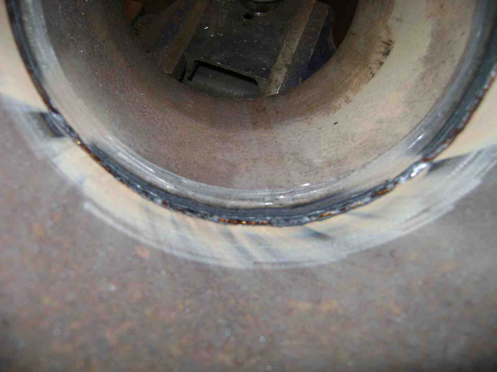

Is the Miller 200 limited to DC only? If so you could always pick up a bottle of helium, to weld aluminum. This is the results I got with my import DC only import SMAW welders. No foot pedal, which really makes life easy when Tig welding aluminum!

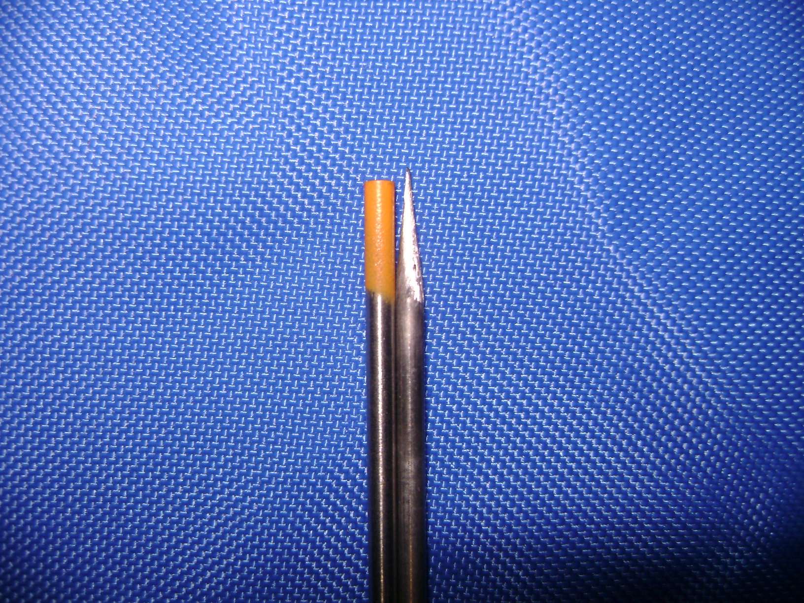

Does the tungsten tip stay sharp with DC? What tungsten did you use? Might want to try this.
/ Welded a Cat 650 Dozer stack (MIG) #28
I've got to the point where all I use is 2% ceriated tungsten. And yes it stays sharp all the time.

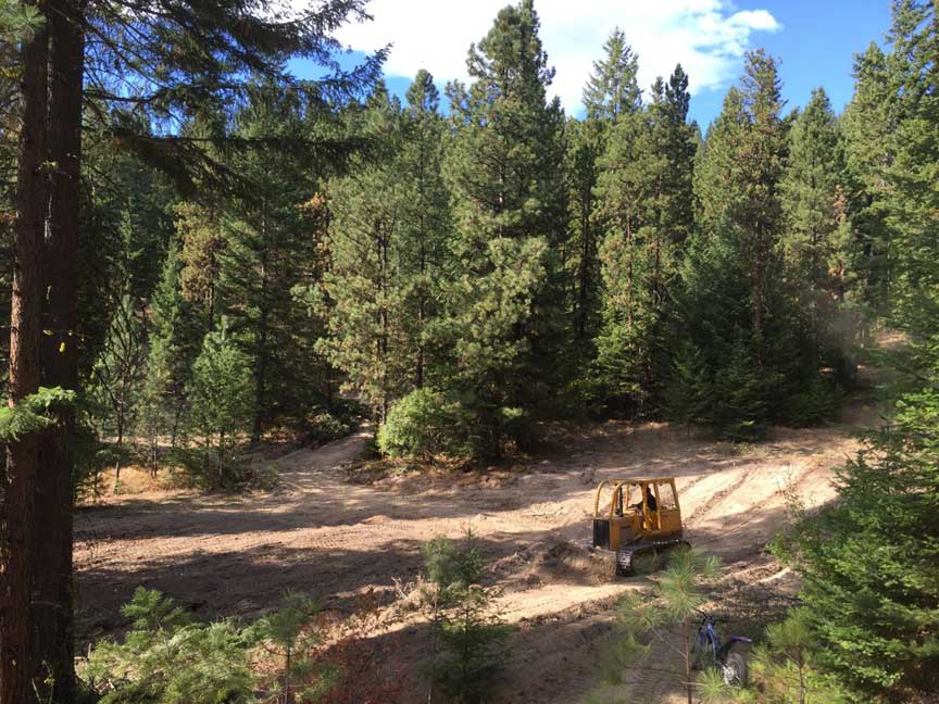

Ditto. That is going to be miserable to run with the exhaust coming out of the holes.
Dusty that's not how it worked out. Even when he Rolls Coal :D, nothing comes out the slits.
442593d1443852905-welded-cat-650-dozer-stack-deere650g-jpg
Happy to finally get time to make this clearing. 4 hours later it's like getting free land!

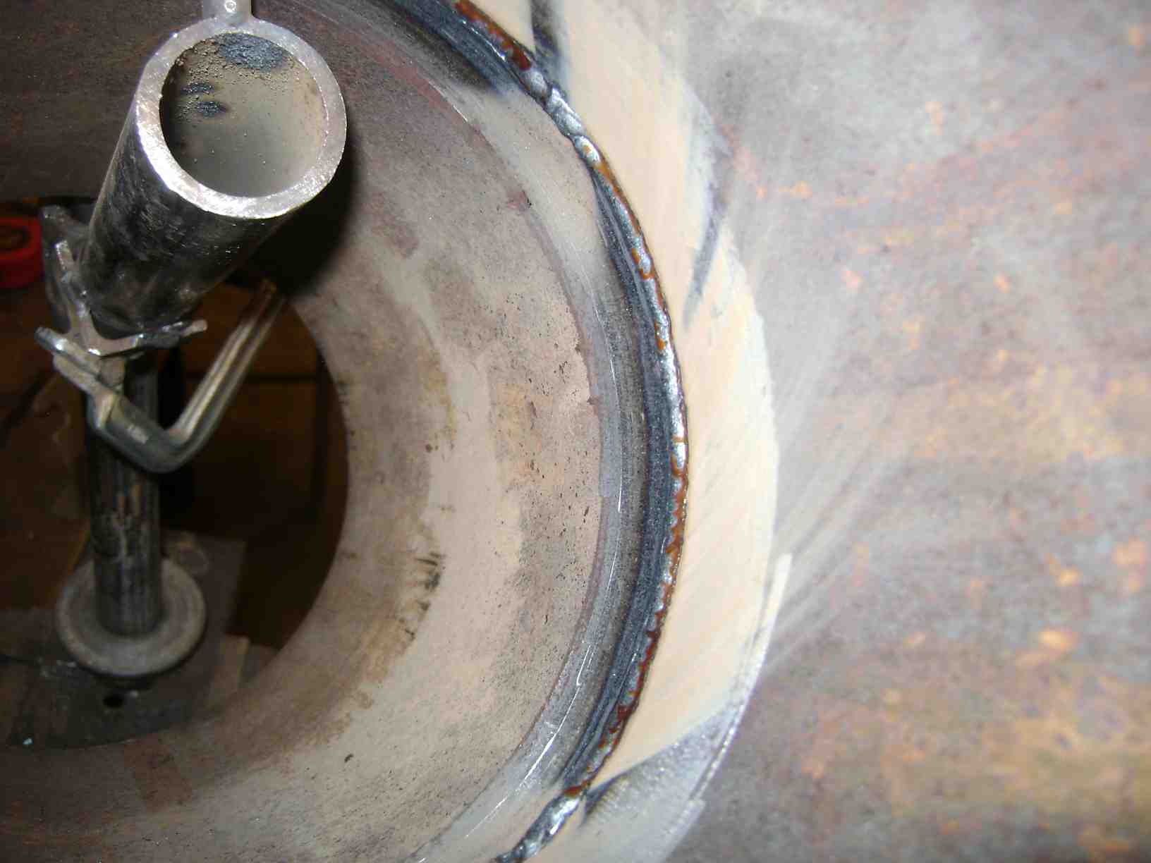

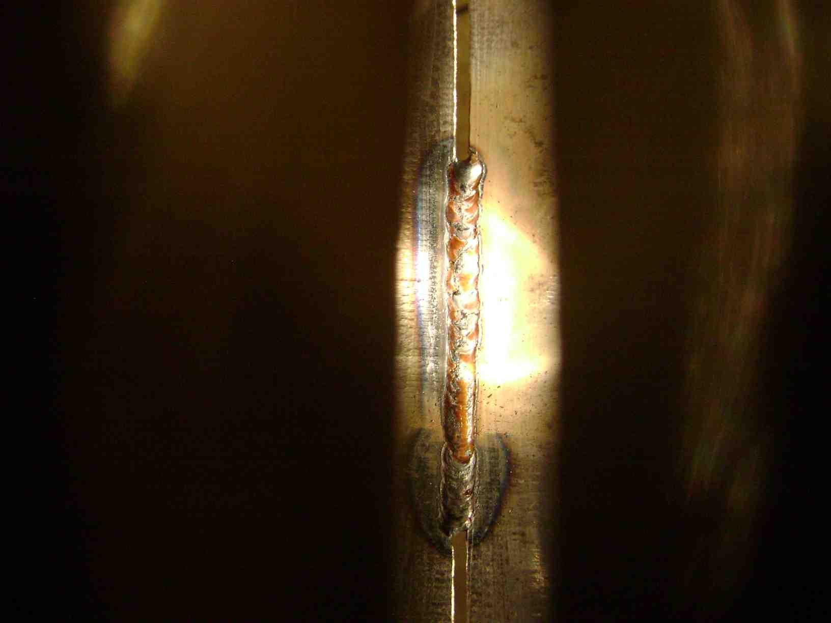

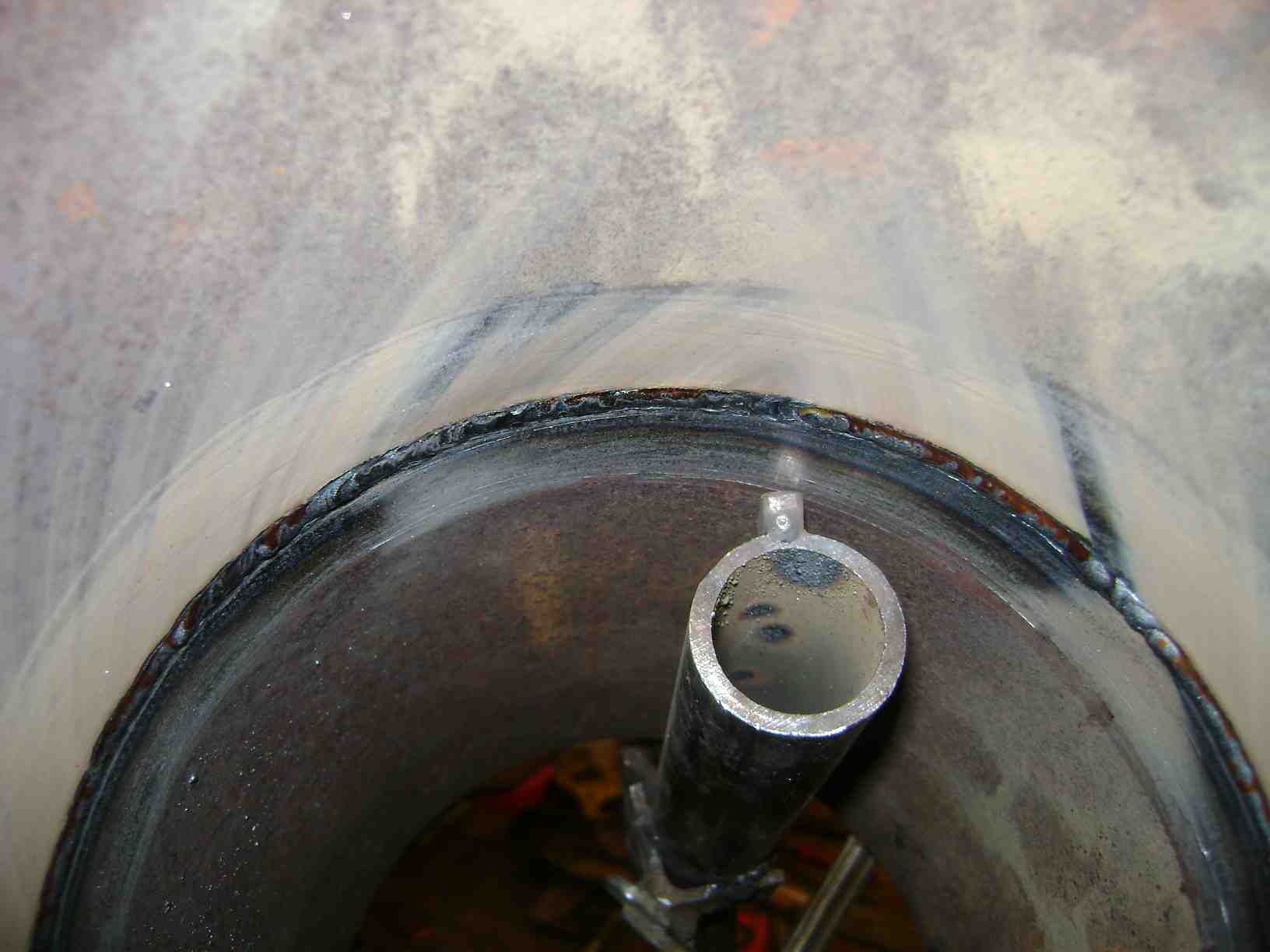

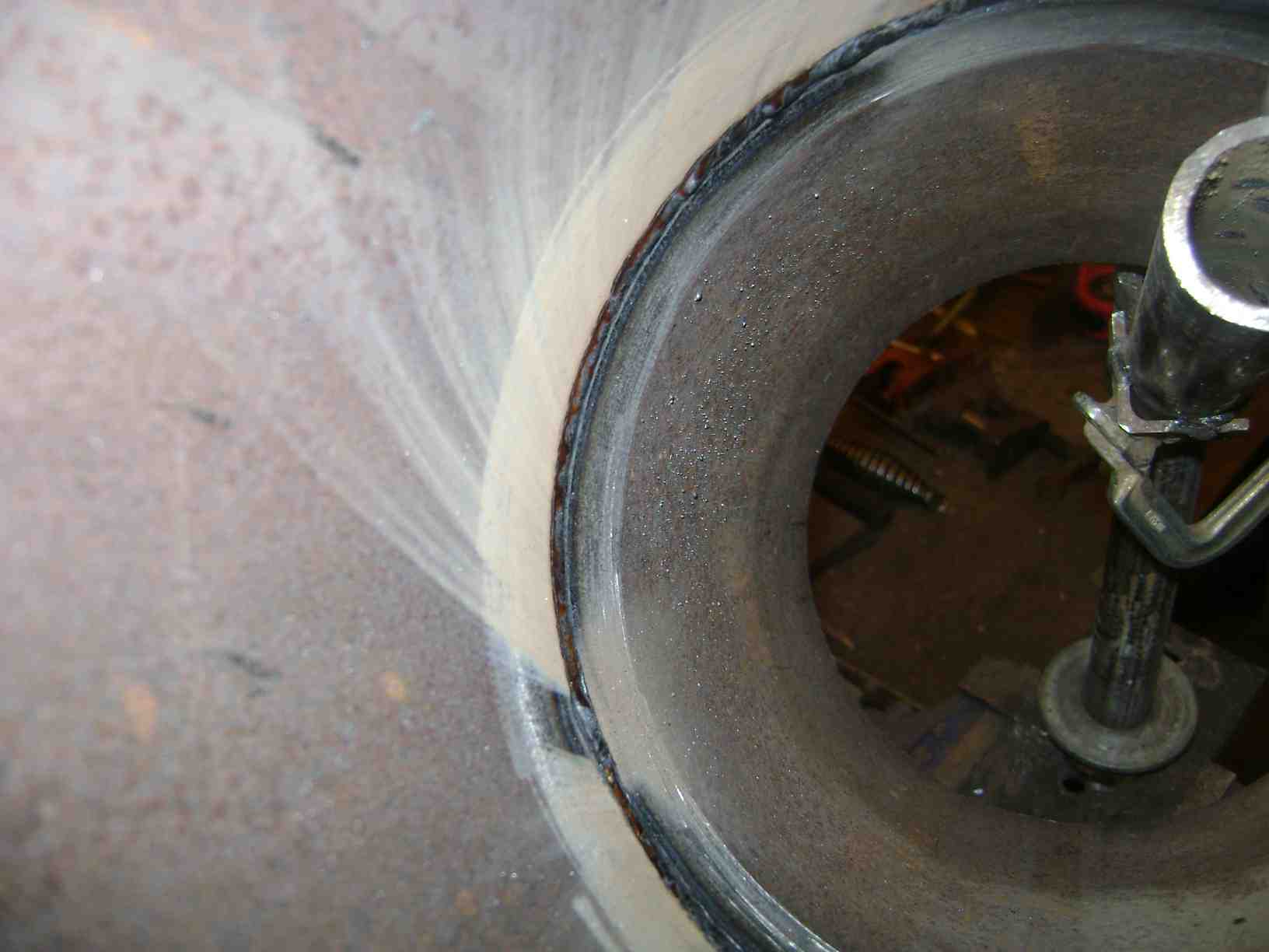

I use about 1/16" land, and a 7/64" drill bit to set the gap. I use 1/8" filler for the root pass. I use 3/32" filler for the hot pass. I do not go up more than 10-amps for the hot pass! This helps prevent suck back! I run about 95-amps. With a very long sharpened tungsten. Most of the time I use the lay rod technique, but I have been known to dip the filler too.;)

Always thought I'd watch videos but never could really pay attn to TIG because I had no EQPT to apply it to. Man those guys are GREAT teachers. Really looking forward to TIG. I've done a lot of gas-welding (but not in 20 years) and always wanted a TIG. Wish I could wind the clock back and get a TIG 20 years ago.
One thing that struck me is that this TIG puddle (& bead) appears to have a very little "penetration" into the parent metal. It seems to me (on a theoretical level) like all you'd have to do is penetrate one molecule into the crystalline structure, and two pieces become one (ignoring flaws for the moment). I understand there can be a grain structure that differs at the edge of the melt. But what is it - that is different - between a low-power MIG weld and this tiny TIG root weld? Isn't this guy welding with 95A? That's not a lot of power going into that parent metal.
I have no doubt this is stronger, and better result. But what's the deal with penetration? Does penetration come into focus with MIG simply because MIG is crude and un-controlled?
