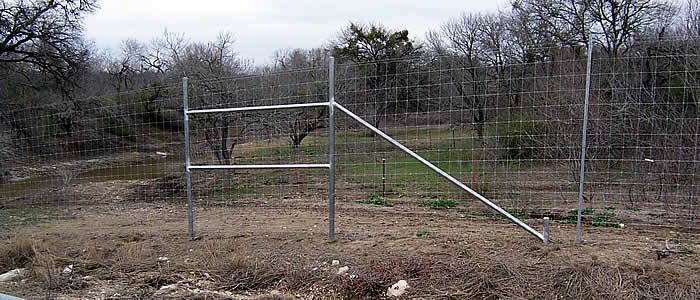

Eddie, I dont understand what you meant:
" Usually you set a post, or pipe straight into the ground with about a foot sticking up. Then weld it all together."

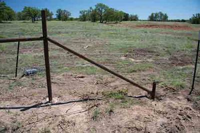

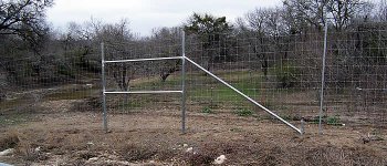

Couple of pictures showing what I'm describing. Just the H brace might be alright, but if you have a long run, bad soil or you just want to make it as strong as possible, you need to add diagonal bracing. The way I've seen it done is that they drive a shorter length of pipe into the ground somewhere around 4 to 5 feet down with one foot sticking up. Then they cut and weld their diagonal brace from that short length of pipe sticking up to the end of the H brace.
