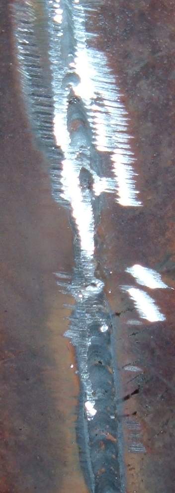

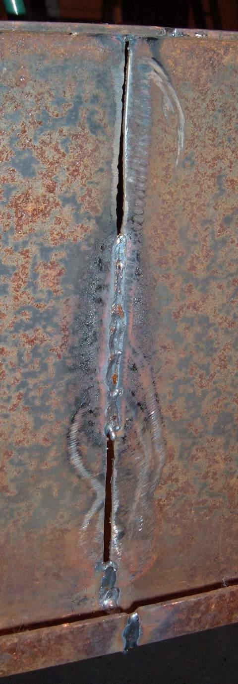

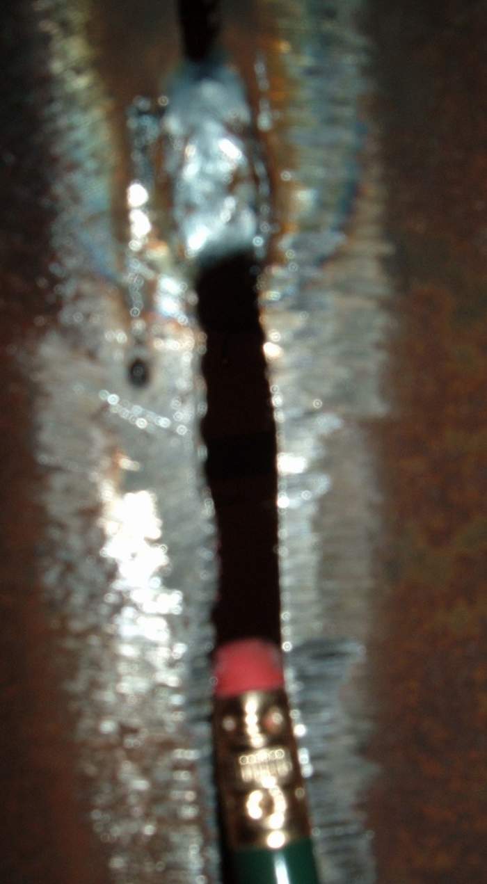

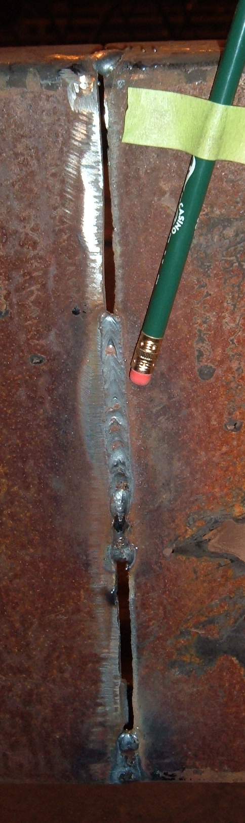

These are some gap fill pics. I will elaborate later a bit but you can really make it hang in there with the 210 on this 10 or 11 ga. Pic 5 and can see how far it could be ran to fill without stopping The pencil was to show width which was 2x as wide as the thickness maybe more. The cuts were crude and made it too short, we stretched it to make the overall perfect for this light beam splice and simply fill the gap.
The last 2 are actually welded from the other side. In one you can see the line, we salvaged this and it needed a couple stitch welds for security and instead of fussing over it simply melted them thru in semi plug weld fashion really.

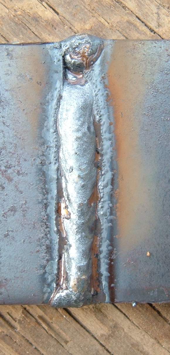

So the last two pics are not of an applied weld?
/ welder circuit #44
No, they are the back. The weld was applied from the other side.

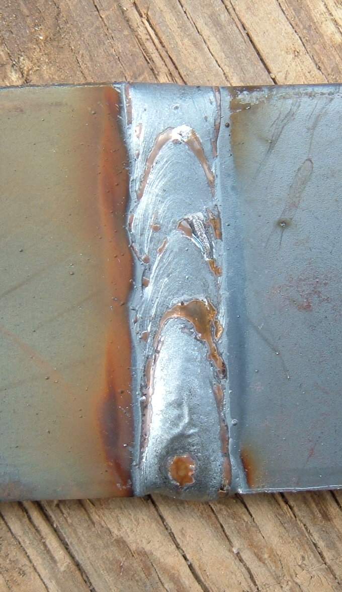

Something escapes me then. The fitment looks dead touch. How can a weld seep the fitment to the other side and not glob to the floor or not have burned through the top?
/ welder circuit #46

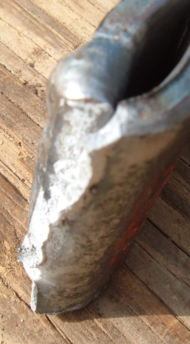

It was dead touch. I melted thru till there was just a keyhole and then filled it. I been at this a while, when I weld regular it becomes almost automatic. I left a little spot with this one, left a gap in the fit though. Left is so the fit was visable. Bout had to do it to get it to break. If it was ground flush and comp-lete it prolly wouldnt have. Welded one side, the first pic is the face.
Ok S thanks. You simply exist in a different skill realm than I. I would have had weld globs on the floor. You type guys don't even have to bevel it seems.

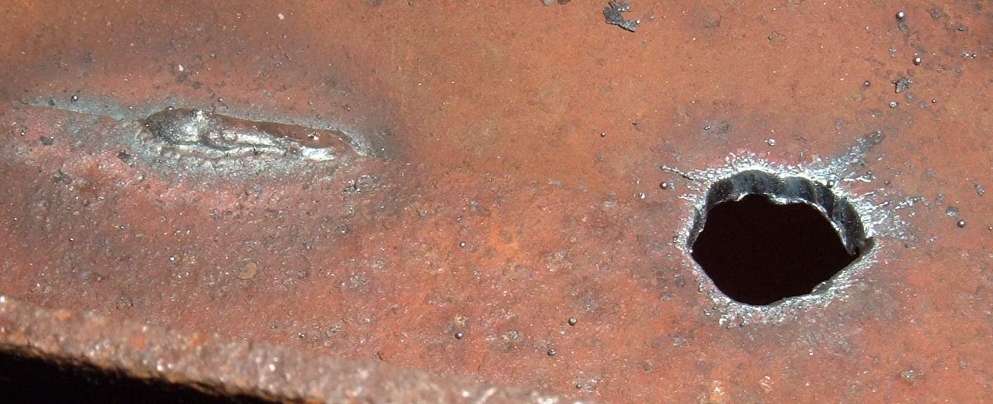

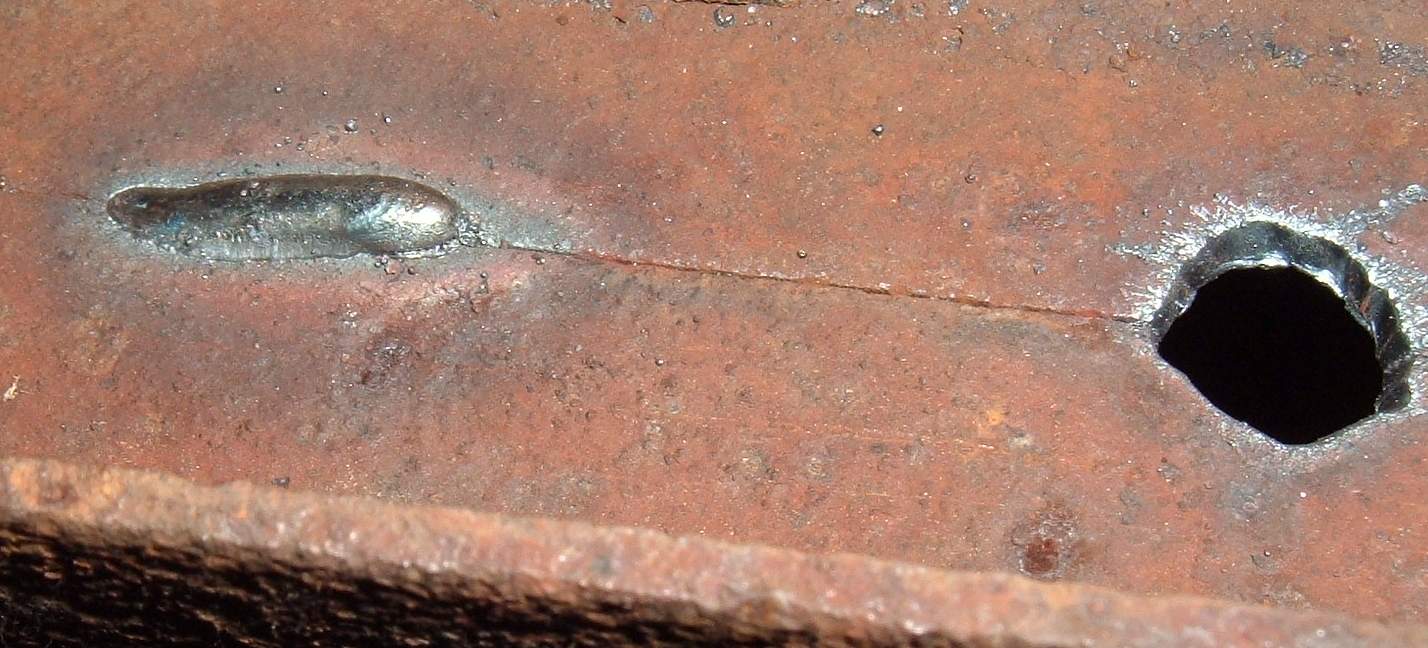

Yes, can do it with stick, up and overhead. I believe the pic 2 is the back of 1 and pic 3 is overhead with plate clamped to bench and a reach under. I use an HF hood with cheater in it. I like it as good as another I had but havnt usedreally good ones so I dont know. I am guilty of not changing clears which makes for a lot of difference.

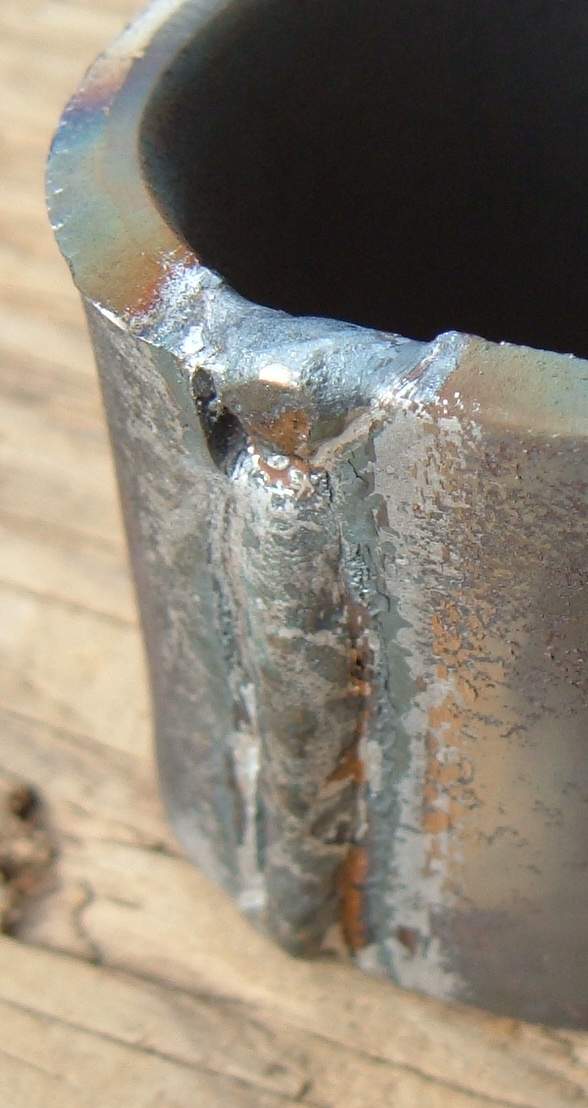

Here is a gem. Old 7018 rod ran up on old fire damaged scaled plate. I bought this machine and hooked it up for a test.
