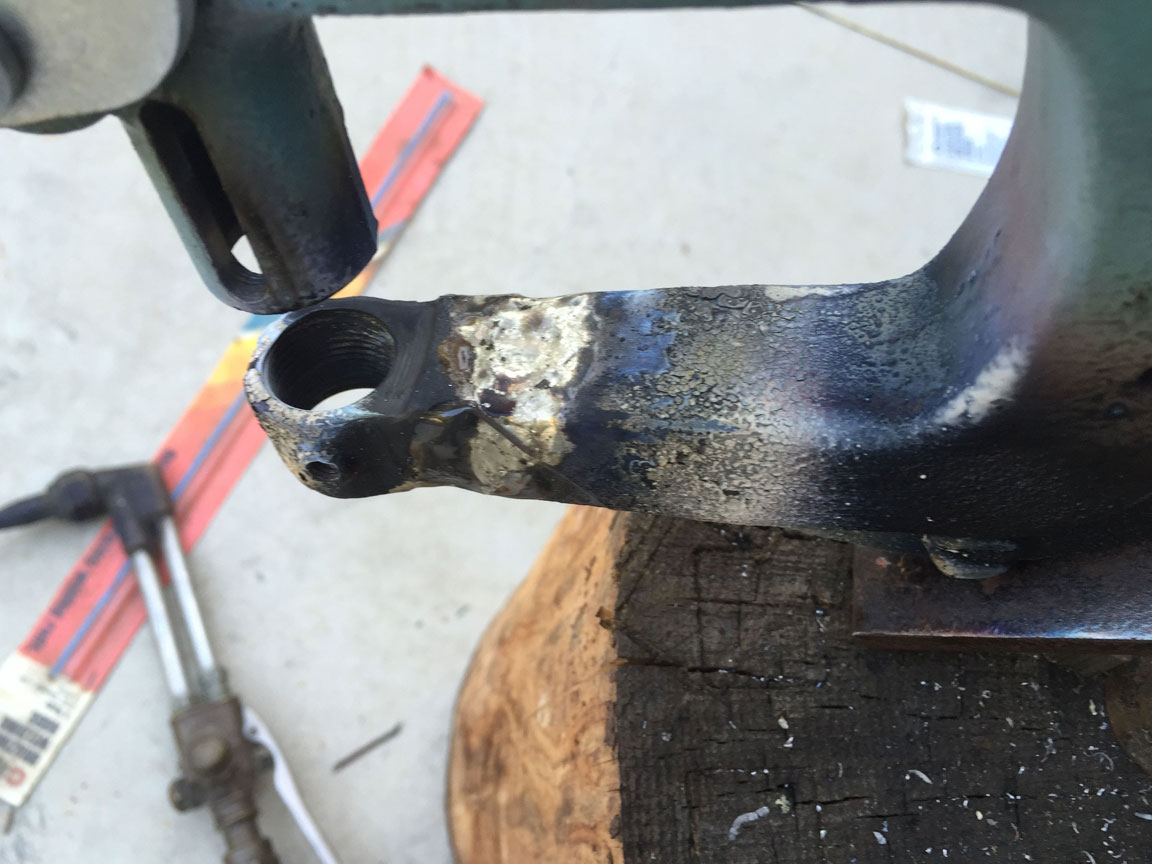

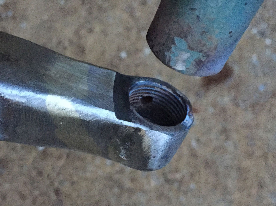

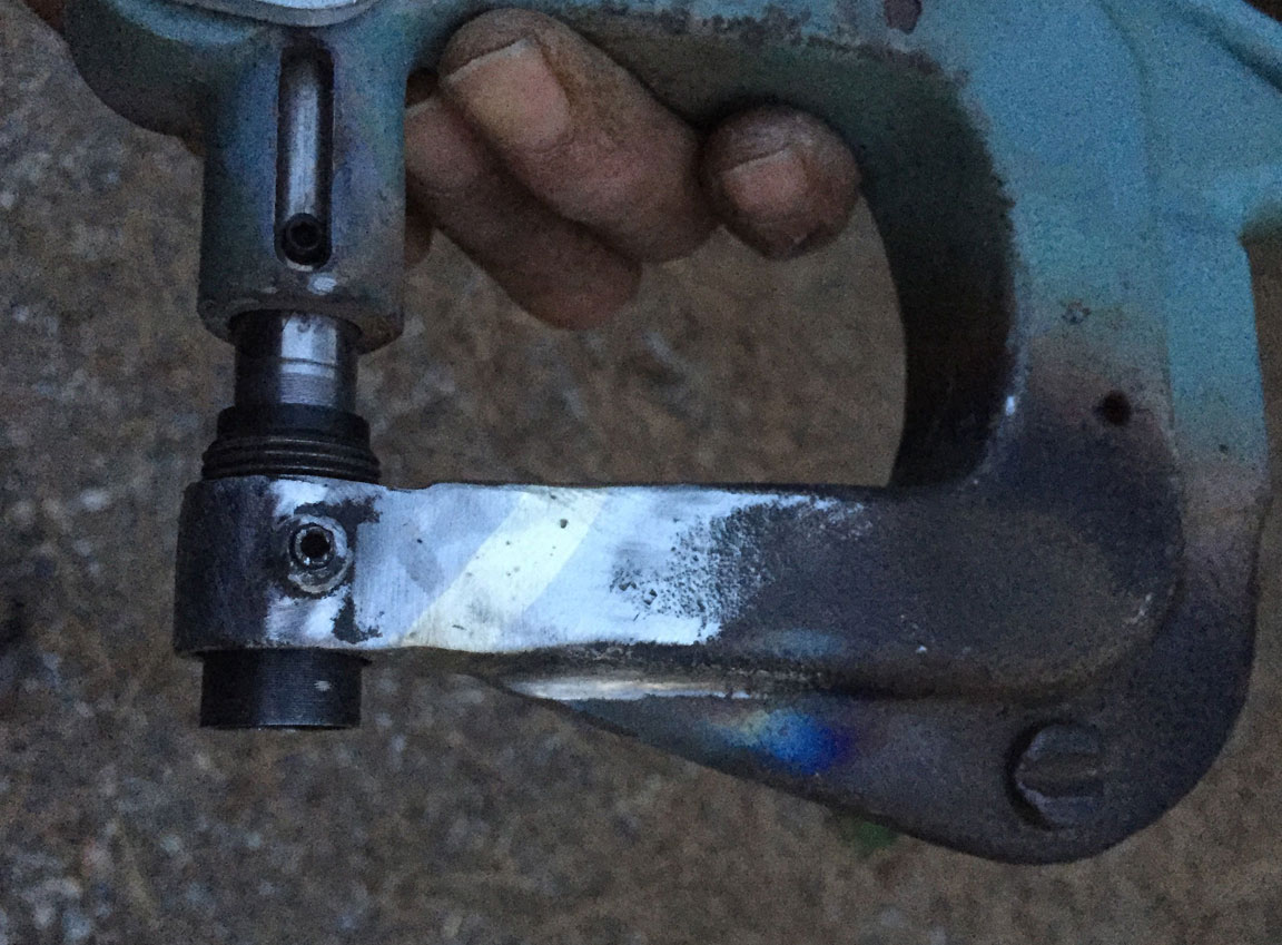

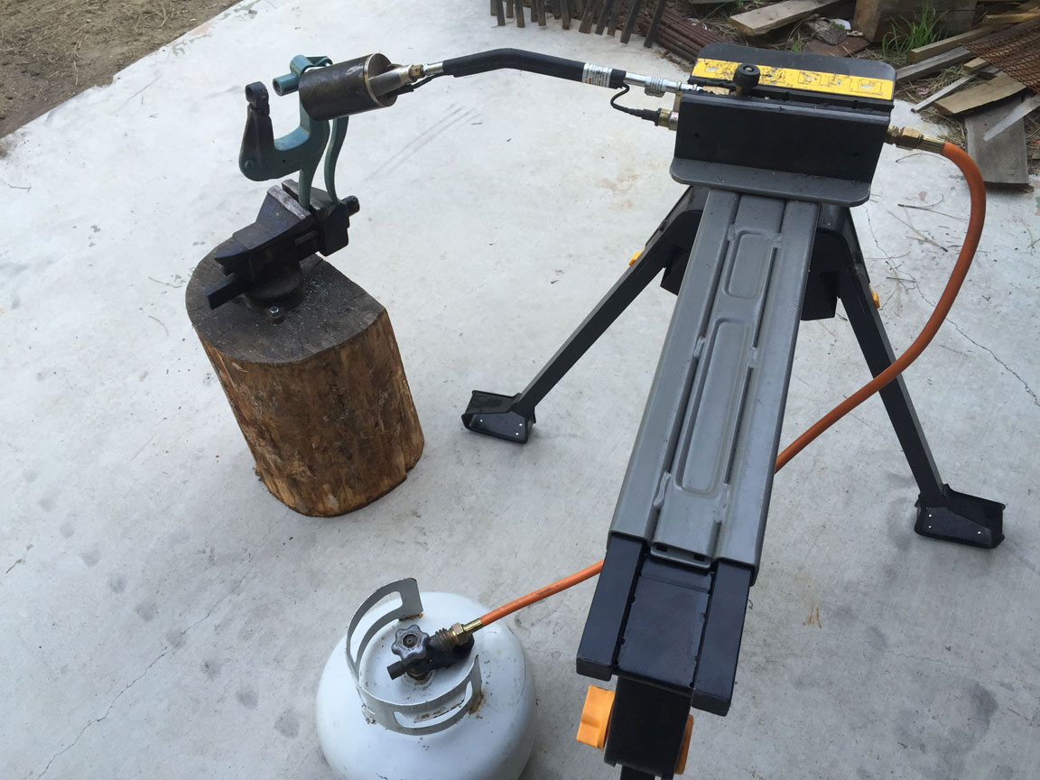

Ok got it all done.
Used a propane roofing torch to preheat. The brazing went well except all I had was a cutting torch, which boils the brass on the surface quickly. It's not ideal.
I can't imagine this ever breaking. Nice to have the kit back together and functional.

Nice job of making do with what you've got.
Have you tried it out on anything yet?
FWIW, Rustoleum makes a line of hammer finish spray paints that are perfect for covering up irregularities in welds. There's a light blue metallic one that's perfect for old timey tools like that punch...
