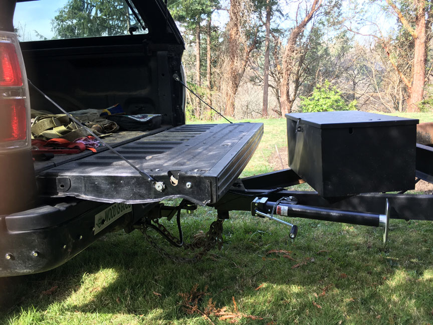

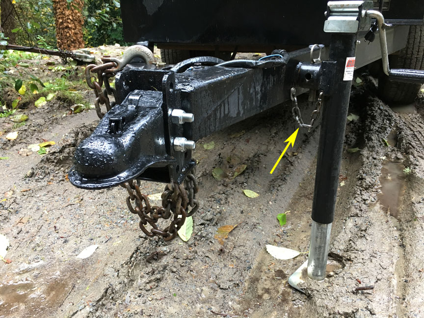

Thanks guys, glad you like it. Surprised though; not a single naysayer. We'll see what we can do about that.....heh heh.
Now, in use I've realized what a hassle it **was** having that centerjack blocking me from stepping over the trailer tongue.
Which happens often in a landscaping scenario.
545004d1521657376-welding-side-mount-jack-onto-img_1161-jpg
AND when the tailgate is perched on the center jack, EVERYTHING you WANT, is out of reach, cuz you can't put your weight on the tailgate to go after it.
545005d1521657376-welding-side-mount-jack-onto-img_1161-jpg
Much better now.
I have a car-trailer with jack pad that telescopes up and down with a pin. THAT is a nice feature, BUT a major hassle compared to the side-mount type that rotates 90* with a SINGLE pin pull. It's probably be stronger though.....depends on the application. For example if you had to disconnect a loaded trailer from the vehicle you (may) want a strong jack that can handle a side load for some conditions.

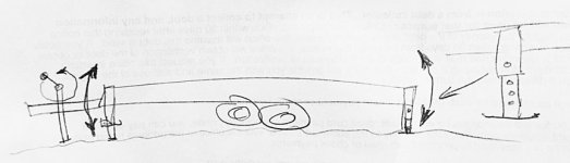

   / Welding a Side-mount jack onto dump trailer #12
In my almost NEVER humble opinion :rolleyes: there's nuthin' "nay" to SAY; excellent job, ditto pics and 'splainin'... I wuz, in my "endearing curmudgeonly manner", gonna comment that you now had a "free cup holder" for when you're hitchin' up, but thought better of it (oops, guess not :D)
"For example if you had to disconnect a loaded trailer from the vehicle you (may) want a strong jack that can handle a side load for some conditions. "
I have a tentative plan (for if/when I EVER get around to my own car trailer) to use FOUR of the jacks like yours, probably beef up the stake pockets on mine and make the jacks "plug-in" - then, just use the FRONT pair for the loaded trailer scenario - and for the majority of times when it's EMPTY, use ALL FOUR and jack the weight off the tires/springs...
Of course, they'd ALL need to be fairly stout since the BACK pair would get used to keep trailer tilt to a minimum if loading a tractor...
Just thought I'd throw that out there as an idea, not sure that'll make it to the top of MY project list before I (don't) feel 'em "pattin' me in the face with a shovel" :confused: ... Steve

Here's what I have on my "shovel list" for my CAR trailer. The main jack lifts up and down to load the corner supports. The support swings down 90* then has an adjustable foot.
545114d1521729521-welding-side-mount-jack-onto-img_1170-jpg
My list had them only on the rear corners (then Steve had to go and up the ante). I want them on the rear, and prob never actually put them on the front. I like 4570s ramp type but my CAR trailer has the hidden ramps that slide into slots, which are lighter duty, have some benefits too (easy). The trailer's only rated for about 8,500 lbs.
