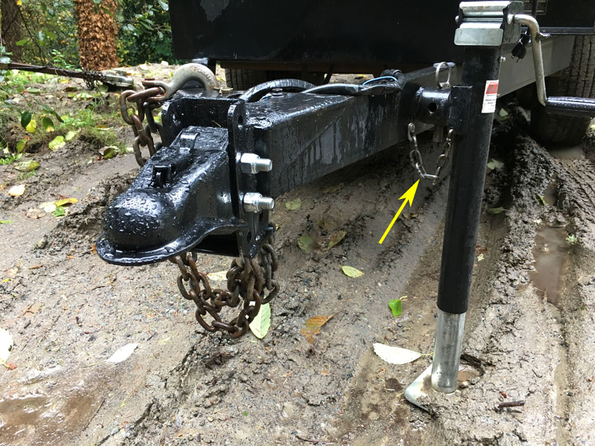

Here's an example. I thought about someone un-pinning my side-mount jack and stealing it, perhaps just to be a PITA. So I chained it.
But the only time the jack can be stolen is while the trailer is attached to my truck, which is not that often, and usually it's not parked somewhere unwatched for weeks; as the trailer is. But when the trailer is parked on its own, the weight of the trailer is on the jack. Thief has to find some blocks and off-load the jack first - thus not a likely snatch&grab. if I'da thought about this maybe crossed this project off the list.
