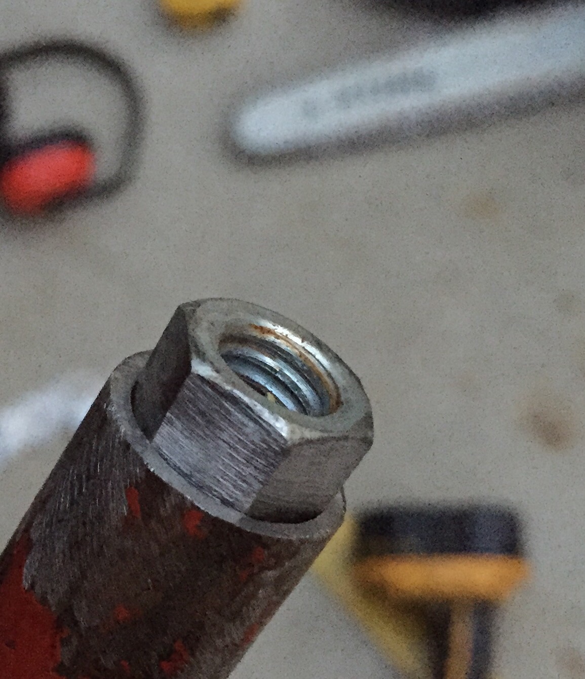

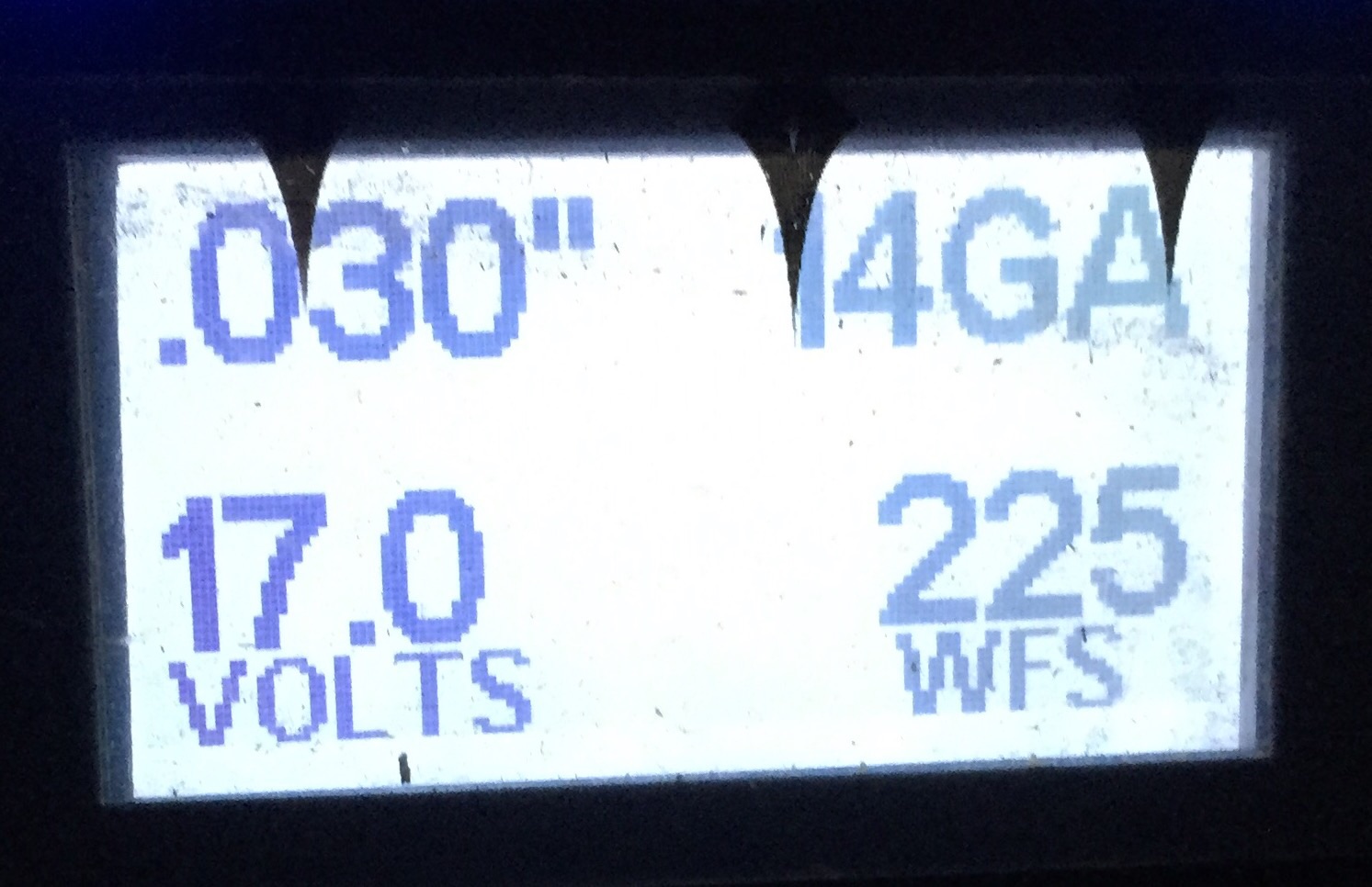

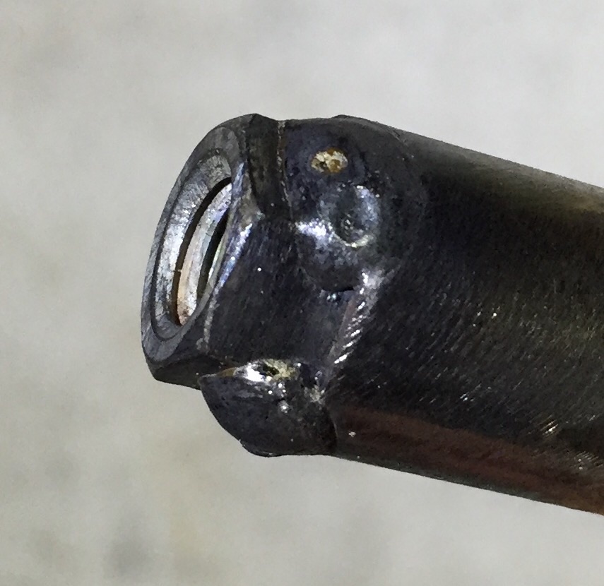

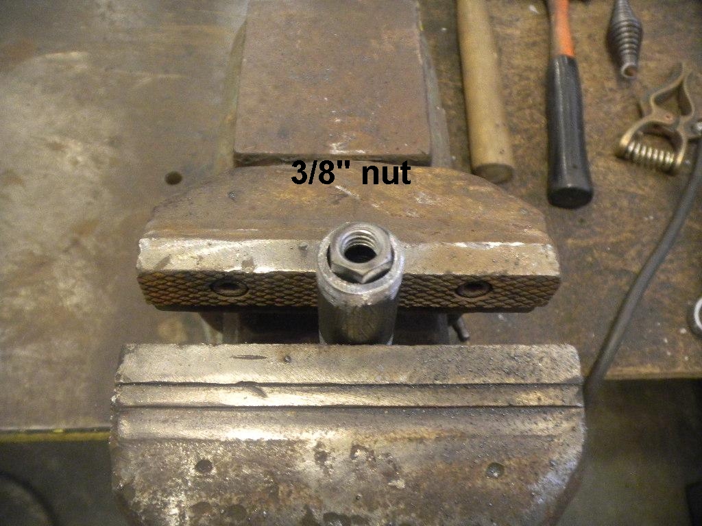

Heres an example with a 3/8-16 nut.
Probably should use 1/16" thickness settings on the MIG. This is using the 14ga setting, and its a little too hot. I wouldn't use 1/8" thats too much heat for this tiny part.
Not sure if this fits the bill for appearance. In my mind I thought I could have welded it nicer but in reality this might be as good as it gets (without grinding). If it were mine though - it would be rattle canned & "done" :D
Could try the pulse method. What is this thing for?

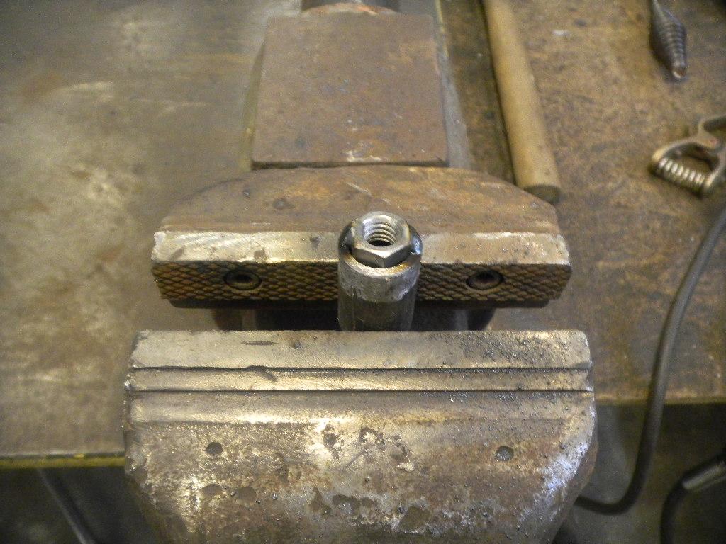

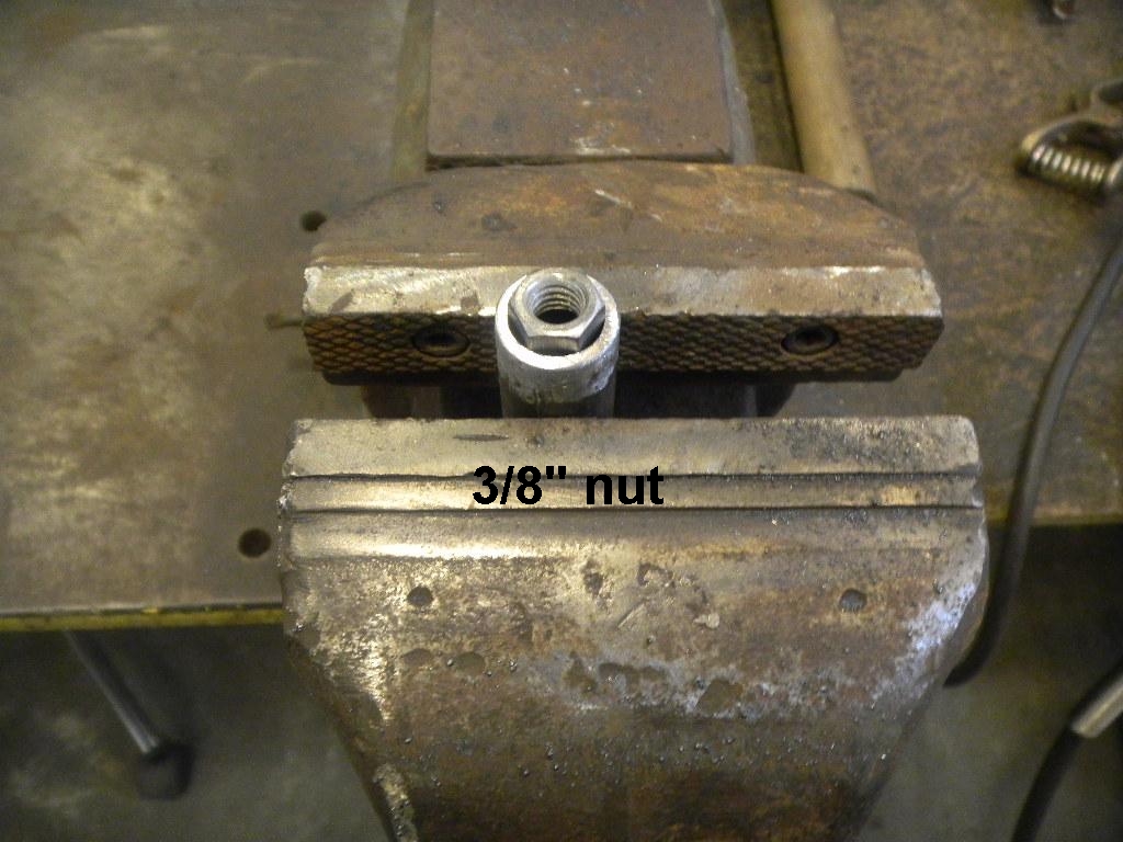

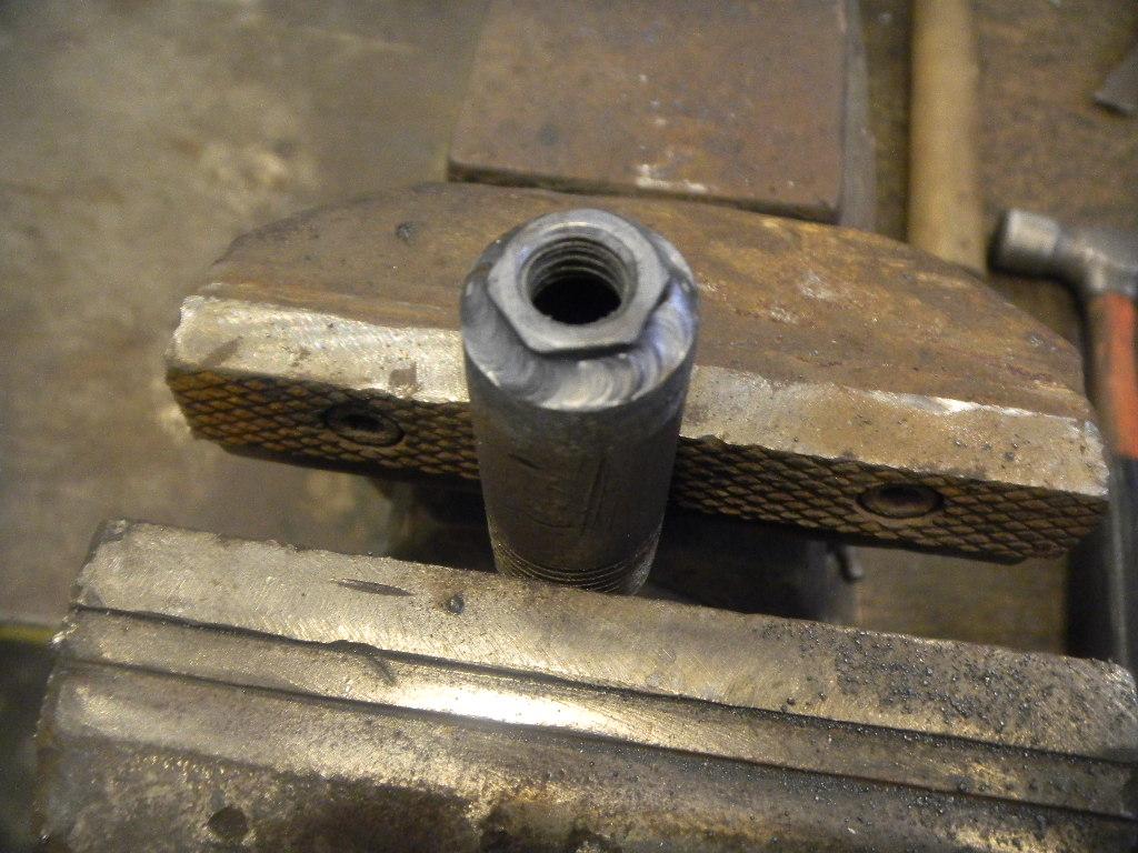

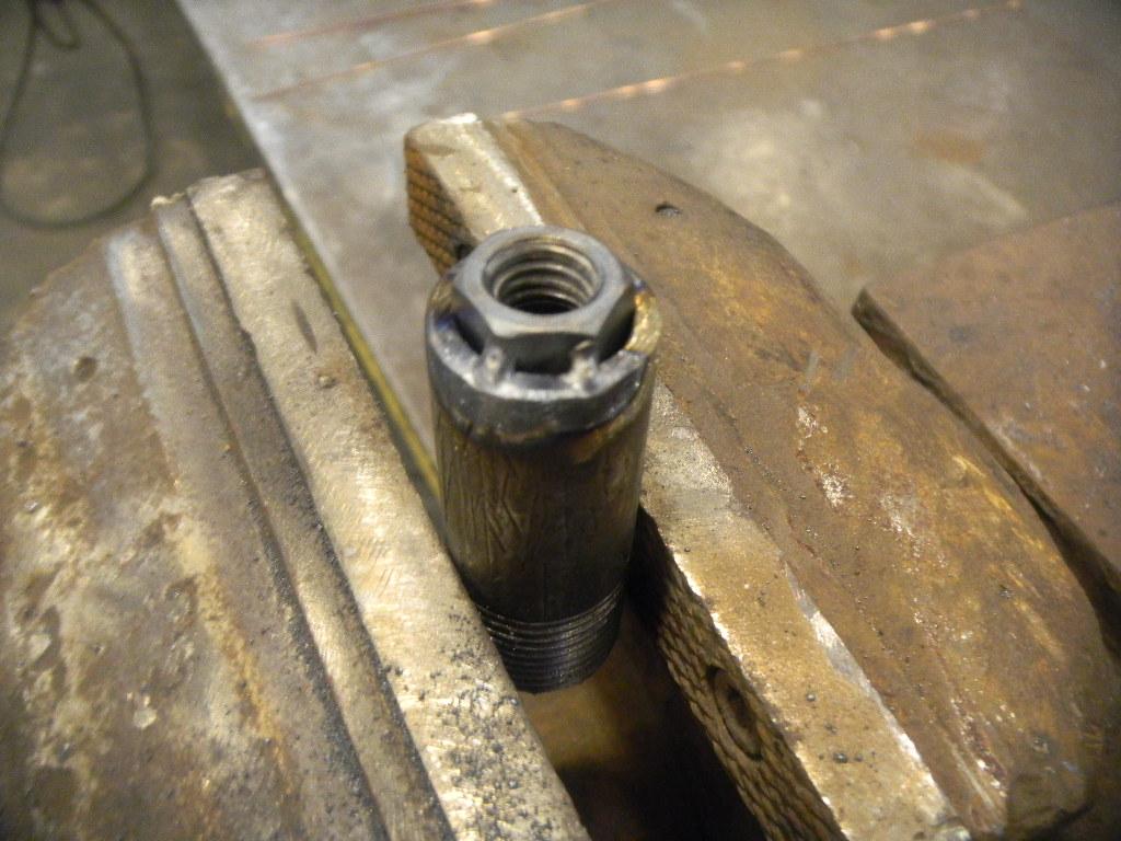

Tig welded.
   / Welding a Small Part
#67
Sodo thx for illustration. That would do the job, I might be tempted to get the other faces same way.
Shield now do it MIG!

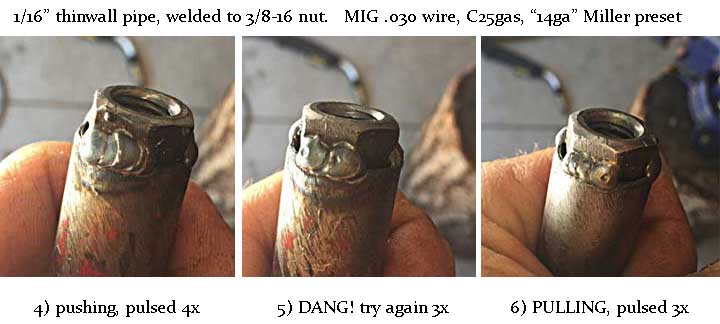

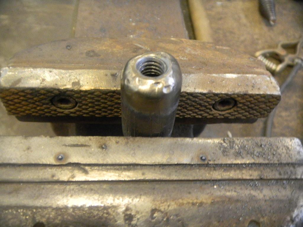

TIG rules for small welds. Someday I will have one.
Here's welds 4,5 & 6. I think I got it.. By welds 7,8,9 I'd have it dialed in & ready for the final part. Hoping SA will get the MIG out!
428802d1433793088-welding-small-part-weld456-jpg
I recall now that "pulsed" is not the proper term for this method.

As requested;), Mig welded.
