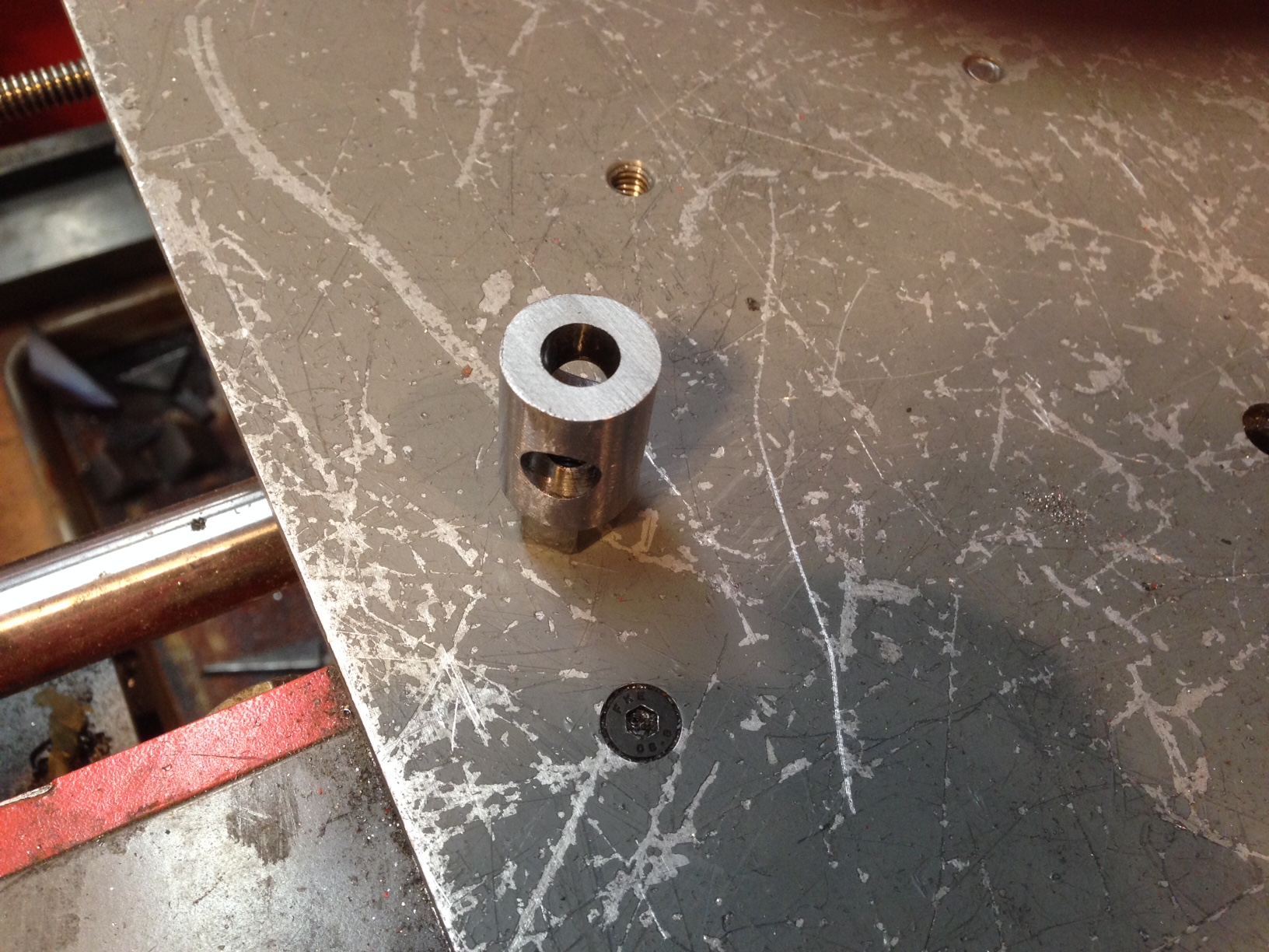

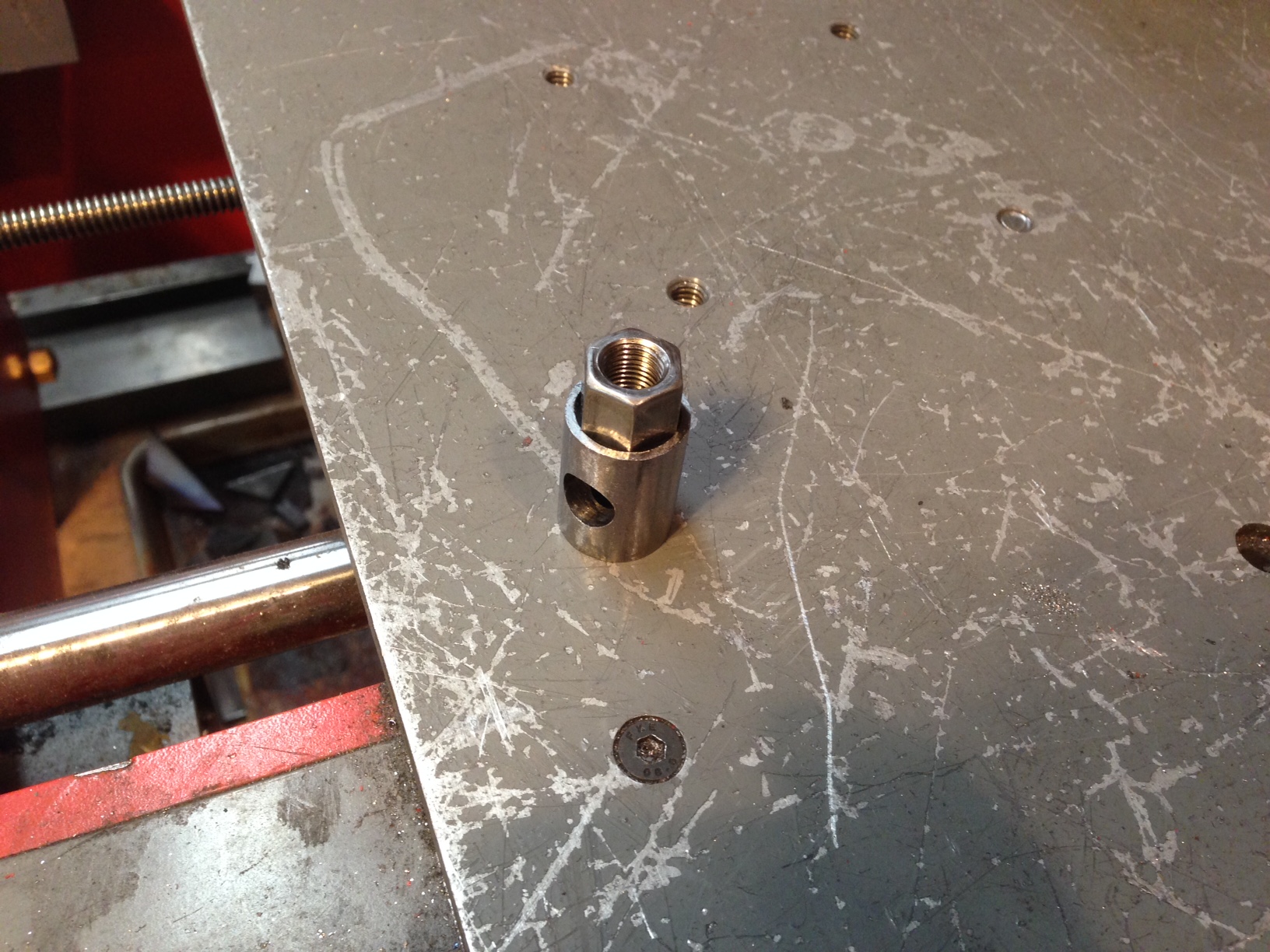

Trying to decide MIG vs gas to make this clevis. Weld has to be strong.
The nut is 3/8 -24. Tube is 3/4" DOM, 3/16" wall, 1" long.
The tube is drilled out on the end to make a press fit lip for the nut. To hold it straight and also improve the weld. The lip is 1/16 wide and 3/32 deep.
For gas I am thinking #2 tip and maybe 3-4 lbs pressure.
For MIG I would use settings just under 1/8" and .030 wire.
I don't want to screw it up. I did make a third part to practice on first though.
Wonder what others would do here.
Thanks.

I'd put a bolt with copper anti-seize through it to hold it in place, use Mig and tack opposite points like cross-torqueing a set of lug nuts (1,4,6,3,5,2). Don't try to weld a continuous bead all the way around - get it solidly tacked down at the corners of the nut first, then the faces in the same pattern. Avoid putting a lot oh heat in one place, and heat opposite sides to even out the temperature.

It's a 3/8" bolt, guys - how strong does it have to be? Mig will do the job, and is far easier for a non-pro welder on a part this size. I'd Tig it, but that was not mentioned as an option - but neither was stick.....

Then you don't know how to MIG weld properly. They put ships together with MIG welders. If you're worried about penetration, then you're using wire that's too small with not enough amperage.
I have a 300 Amp MIG and with 1/16 wire I can do 1/2-inch steel with a single pass.
Welding is:
1. Correct weld joint preparation.
2. Clean metal at the weld joint.
3. Matching the electrode size and amperage to the metal thickness.
If you do those three things correctly, there is no problem with penetration no matter what kind of welding process is used.

Tig welding would be my first choice, then Mig. I too would put a bolt through it. I'd use .023" wire, tack 4-corners, and weld opposite flat spots.
To get good penetration with Mig, all you need is power! :D

Many thanks for detailed suggestions. I do have a stick welder, old Thunderbolt AC/DC, but no TIG.
I think I will use the MIG (Miller 211), corners first, then faces, .023 wire.
I was just going to let it cool in the air but I can drop it in a bucket of oil if there is an advantage to that.
