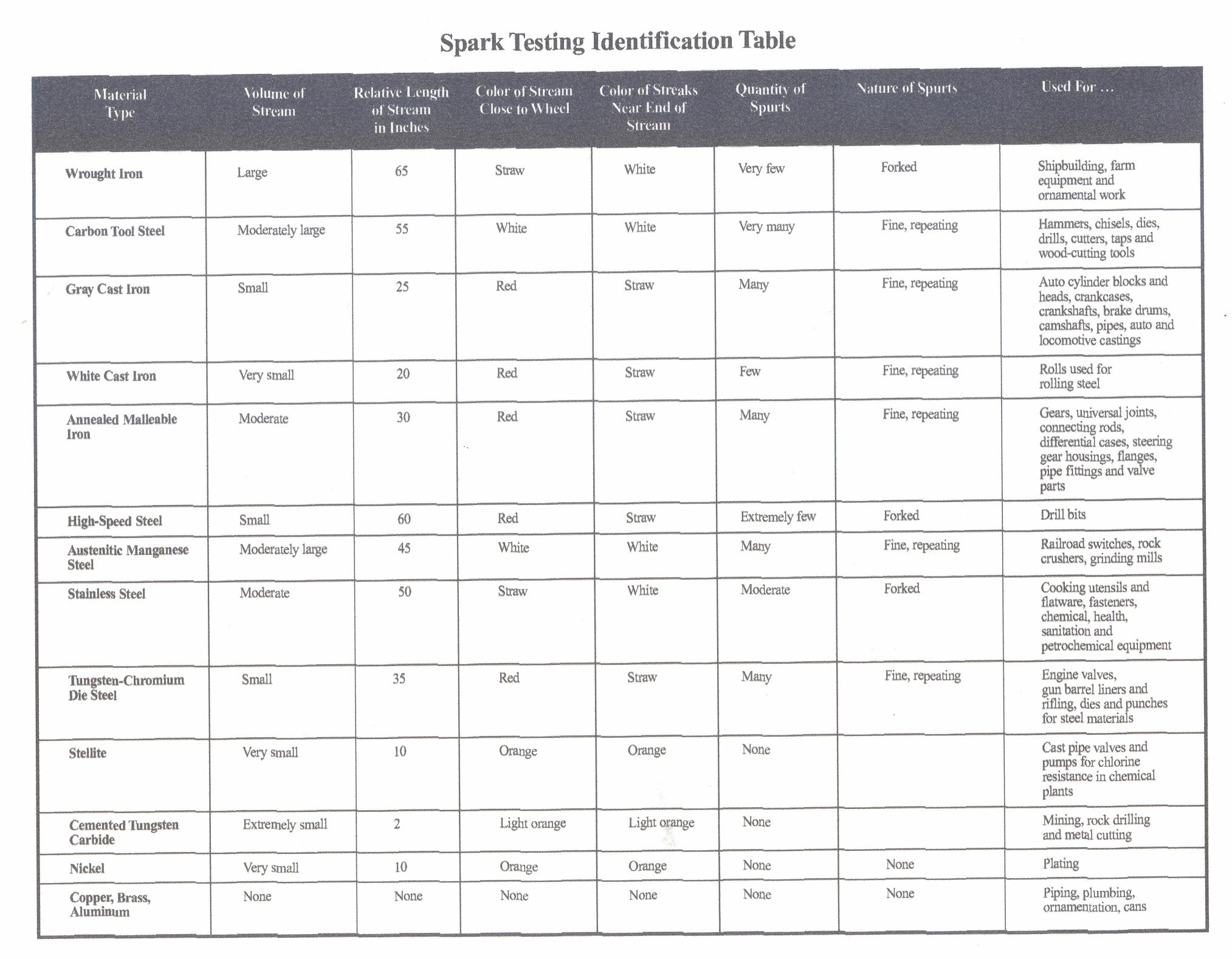

If it is in deed cast steel, I've had amazing luck welding cast steel pile driving equipment with just 7018, also used 312 stainless steel, and Super Missile Weld, (same thing as 312 stainless steel just cost a lot more;)) Little pre-heat, and very slow cool down.
