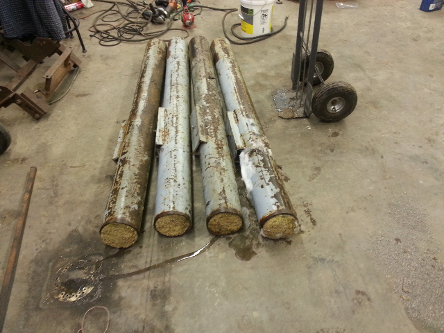

at most I'm thinking maybe 3/4" long welds. Would enough heat build up from short welds like that? Do you think they will blow up in my face? Am I worrying too much?
No
No
Yes :laughing:
All the action is on the outside side of the pipe, concrete is on the inside. I predict that you can weld it as you wish. Even 1+ inch long welds, and NOTHING will happen.
   / Welding and concrete?
#15
No, the ends are not capped- wide open. I'm not welding them together end to end, just going to lay about 4 of them next to each other and weld angle across them, then flip over and weld angle across again, then stand up and put pins in the angle for 3 point arms.
Thanks guys for putting my mind at ease. This all pretty much agrees with my original thinking, I just started having doubts and figured I'd ask before doing something stupid.
I see people ask stuff on here with similar situations and I feel some people have been saved from some pretty severe injuries or close calls by asking first, so it seems the smart thing to do, often there are things we overlook. Thanks again.

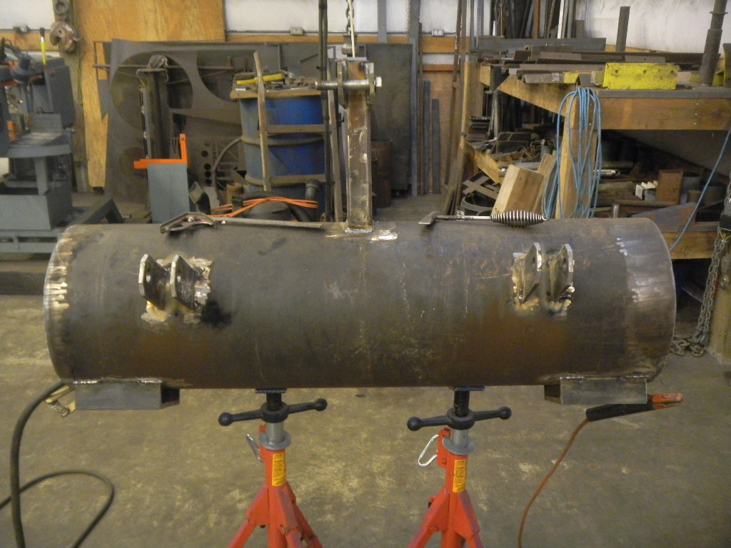

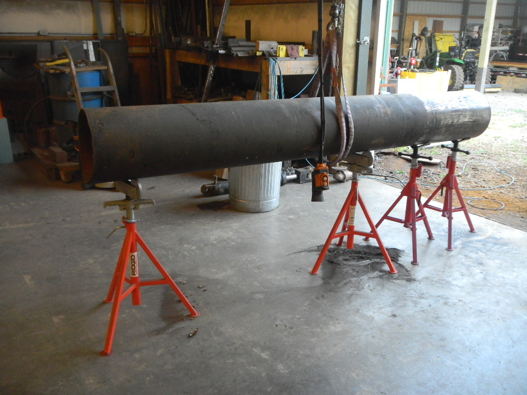

When I built that log splitter for my brother-n-law, I also built him a counterweight something like you have planned. I took a piece of 16-inch diameter fender pile that came out of the local Navy shipyard. Welded the ears on it. I had planed for him to stand it up on one end on some visqueen and fill it with concrete. I understand he hasn't done that yet.:rolleyes:
Mike for what you have planned I wouldn't think twice about doing it. :thumbsup:

Well when I went out to get them a few days ago they were frozen to the ground. We've had a warm weekend so I was able to get them. Now I just have to plan how to build this thing! They are about 300# each so manageable one at a time but once I start welding them together it won't be so easy to move them around. Wish I had a gantry!
