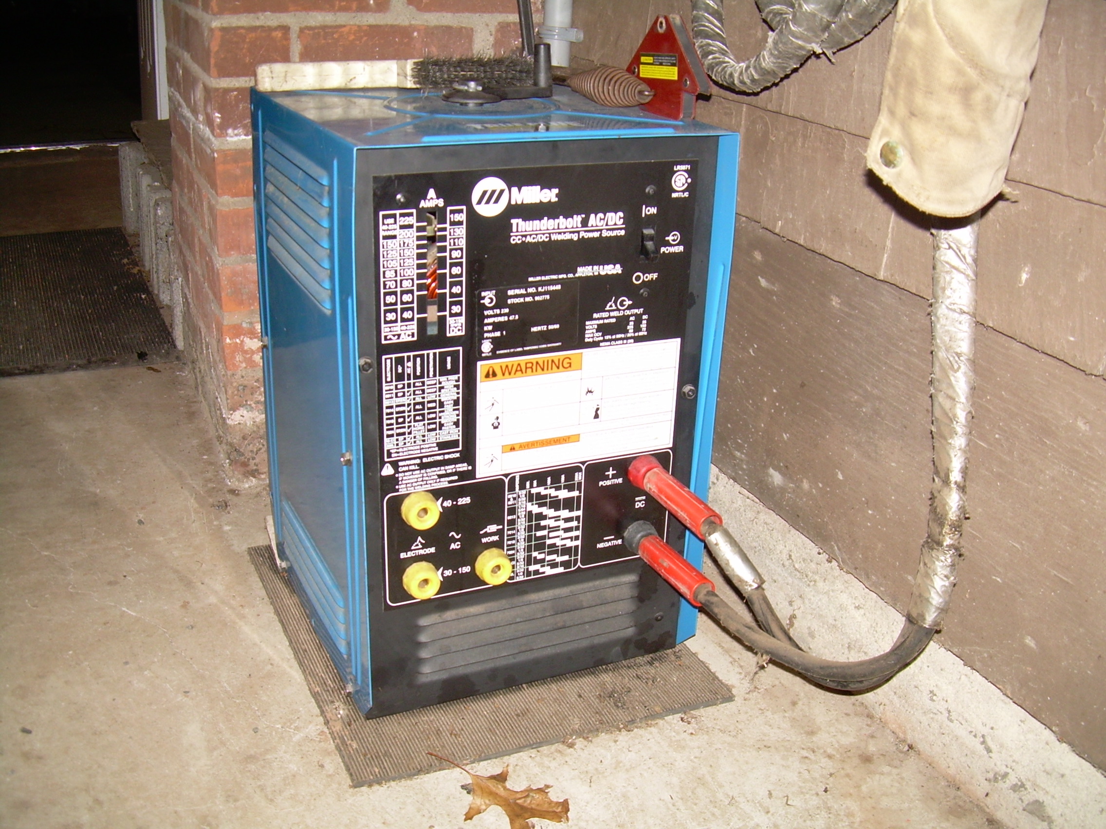

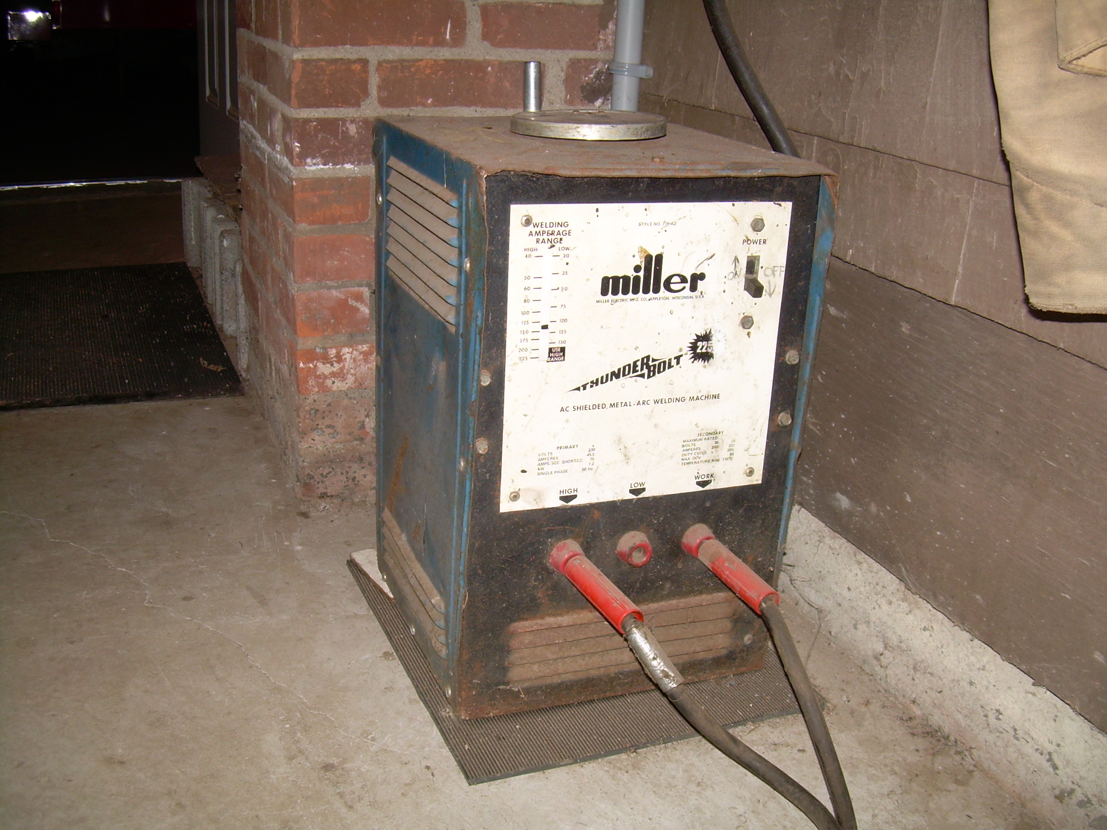

I just bought this off Graigslist for $225. it's 10 years old but was unused. Replaced the 30+ year old thunderbolt that was still buzzing, the newer one has DC now which most will tell you is a necessity.
JB.

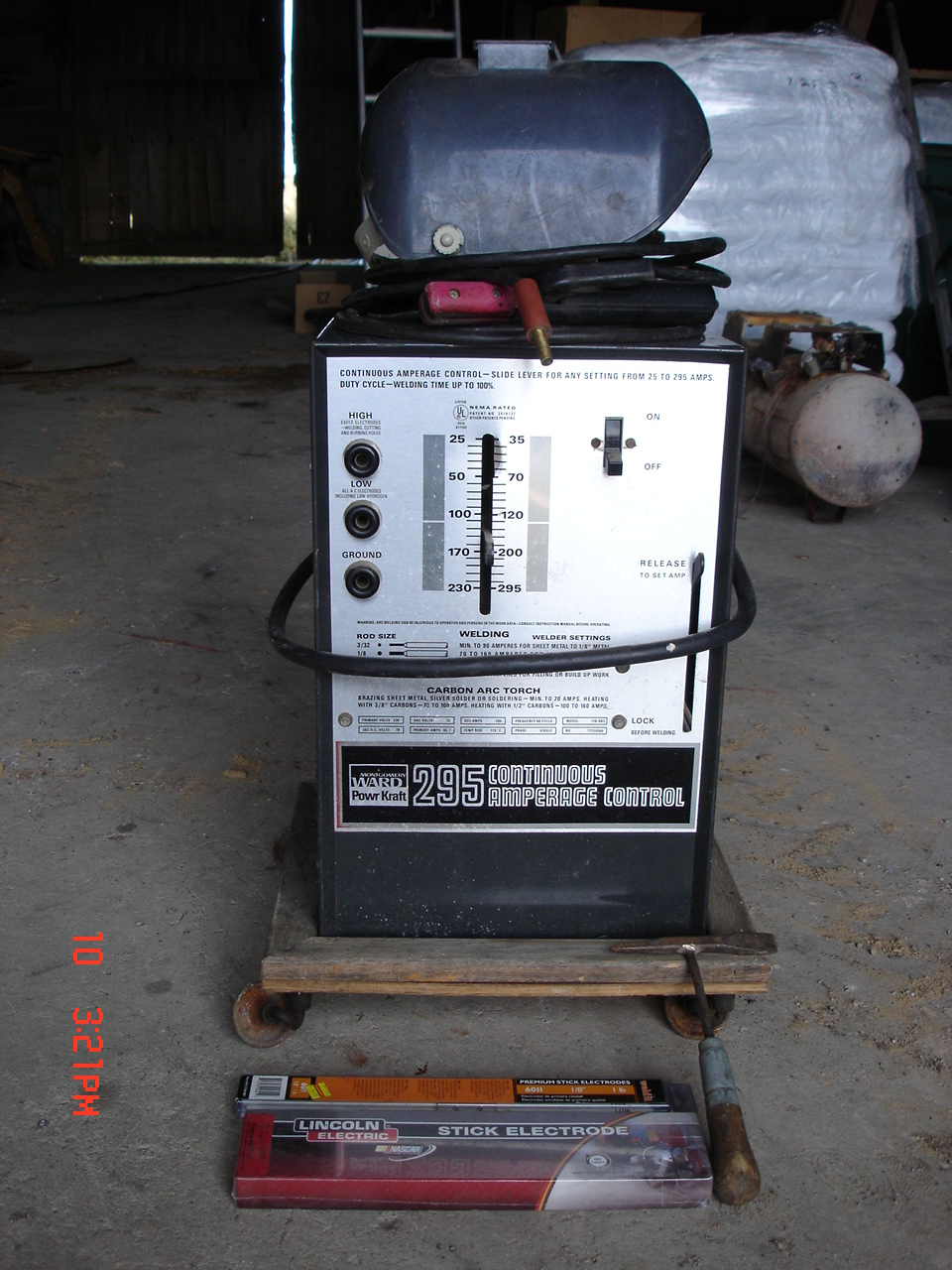

This is the little treasure I found on our local Craigs list for $75. It was only about 3 miles from my house. Welder, chipping hammer, cables, hood, one small unopened pack of 6011 and a small unopened pack of 6013. It also came with a hard cover Lincoln "how to weld" book. I think it is typical of what is available if you are not in a big hurry. I have used a friends identical welder a couple months ago and I was impressed with how good it made my welds look. When I saw it available so close to home I just had to have it.
Now I have a welder for every barn.:D:D
