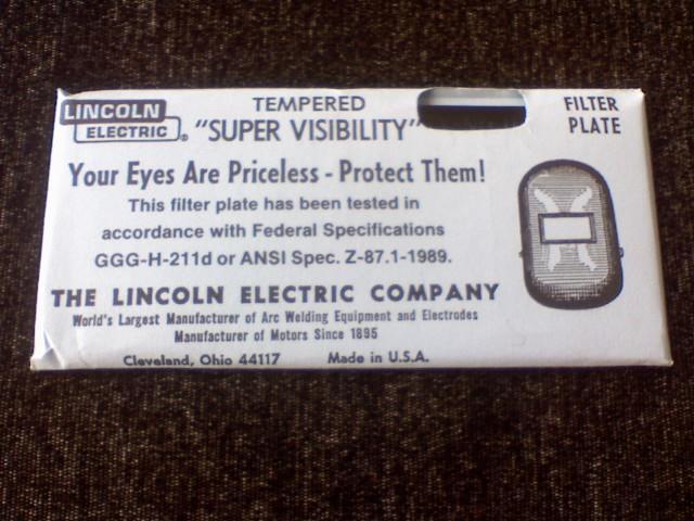

Don't know if you're old enough to remember the American Optical Cool Blue lenses? They were amazingly clear! The Lincoln Super Visibility are a close second, but these ArcOne lenses are just as clear as the Lincoln lenses.
Welding Lens American Optical Cool Blue Shade 10 | eBay
