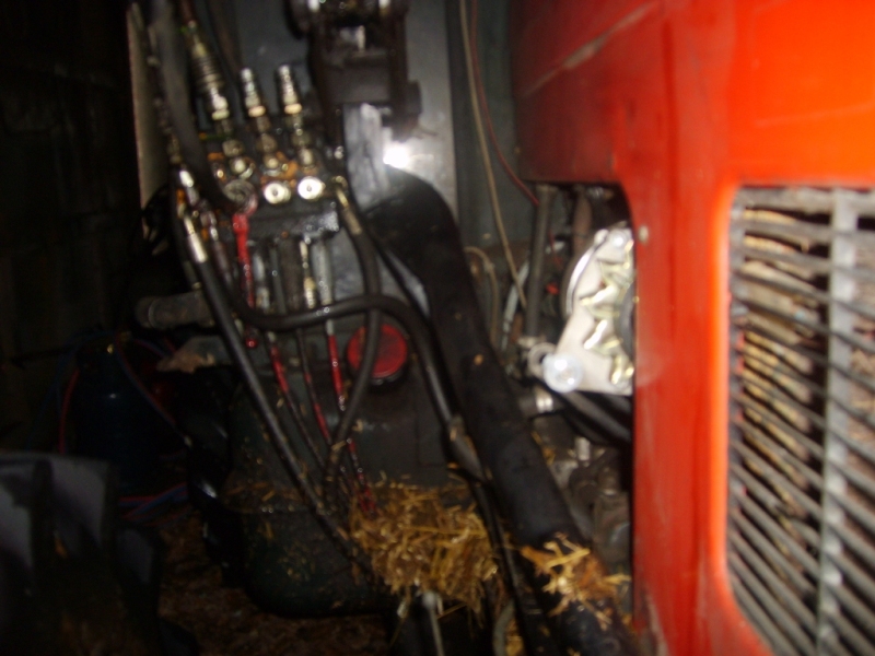

I dont need an inch of penetration... but welding a solid 45mm push bar to 25mm (1 inch) front loader consoles, the chunk of steel is just too much of a heat sink to get it hot, and keep it hot with only 180A. The 180A died in action, so i brought it to the repair shop and ordered the 350A, and he borrowed me the 250A because i needed my front loader again for the feeding. The 250A was a totally different animal, it burns deep and creates flat beads. the 180A just stacks some caterpillars back to back, because it cant penetrate and melt them together.
After using the 250A and feeling the world of difference between the two, i was in doubt if i hadnt spent too much by ordering a 350A. However, i felt i needed overcapacity so i would never use more Ampere than the welder can deliver at its 100% duty cycle rating, to make sure it will last at least a decade without repairs. The repairs of the 180A welder in the past 2 years, are as much as the extra cost of buying the 350A right away. I certainly didnt buy it for bragging rights, I see it as an investment that will pay back over time due to lower, or even non-existent repair costs. At the same, or even lower operating cost per year, i can run a way nicer welder... What would you do ? ;)

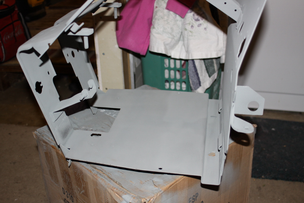

If I had a need for doing something like that regularly, I would get the larger welder. If not, I have two other options available to me. The shop you mentioned, and also a friend who retired from 30yrs as a heavy equipment mechanic and still does it on the side to supplement his retirement. I've used him when I needed welding in the field or when I needed repairs that were beyond me or I simply didn't want to do. Although, this costs me, as I believe that as a friend, I should be the first to step up and pay because he does this as a business. There are often times he comes over and does things for free, but I always offer to pay and let him make the choice. It's the same with the shop I use. I just had them rebuild the bottom of the cowl for the used tractor I recently purchased. The batteries sit in the bottom of the cowl and it was rusted out. They cut out the old bottom and replaced it. James keeps telling me not to worry about it when I ask how much. I feel quilty though, because I know that he subs out the sheet metal fabrication. Here's a pic of the cowl with the new bottom installed.
