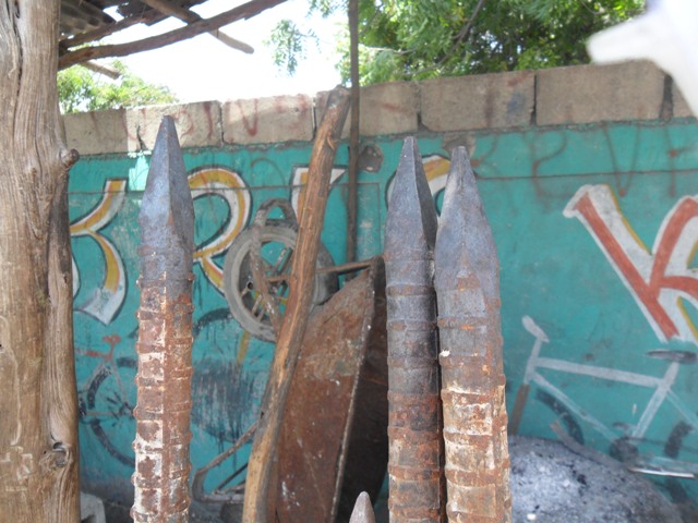

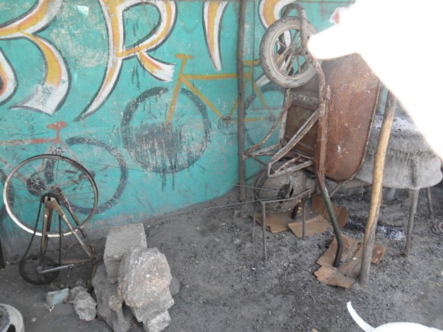

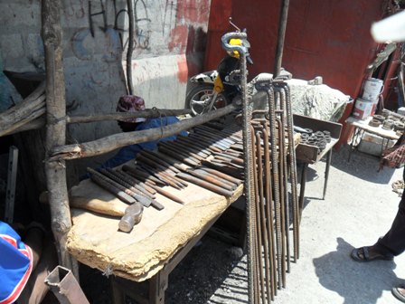

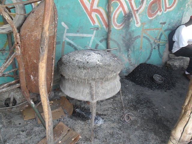

Friday we went out and about the city. One of my first finds was a master blacksmith's shop. I have forges etc and I can do some things with a hammer and anvil. But the most important lesson my blacksmithing has taught me is an appreciation for good work by real blacksmiths. This shop is in a small space along a road filled with shops. If you have ever been to a swap meet then replace the aisle with a highway filled with vehicles and you have the street this shop is on.
He makes chisels and pry bars along with digging bars etc. I'm sure he is capable of much more because of some of the materials on hand. Keep in mind that making a chisel or crow bar isn't just making a point. Hardening the point without making it brittle is even more important. His work is esquisite.
One of the photos shows the forge. A helper pedals a bicycle crank and that operates the blower. Too ingenius for words.

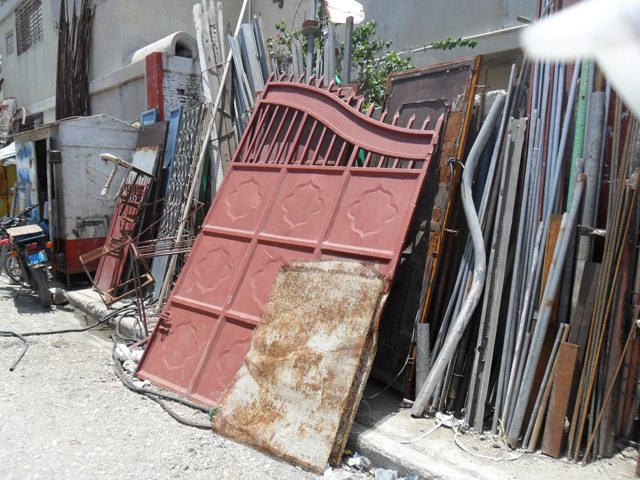

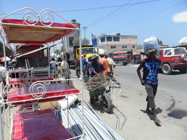

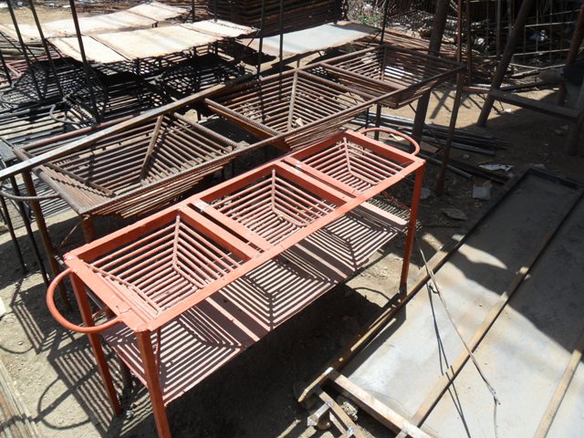

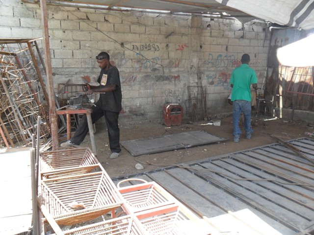

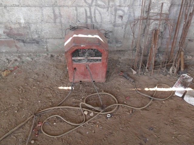

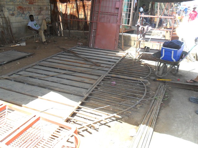

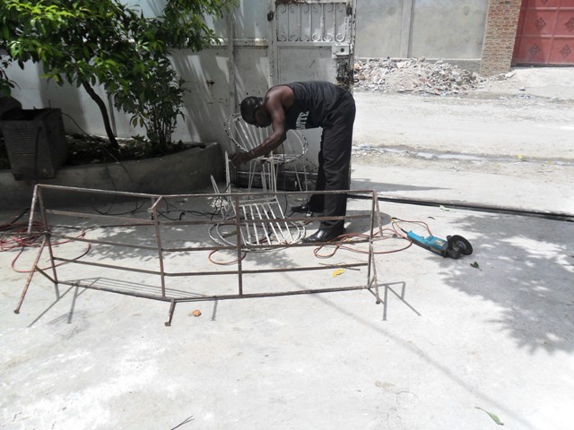

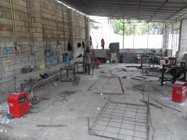

In the same block with the blacksmith was welding shop that was making a gate. You might find the equipment interesting.
Haitians cook with charcoal. The grills you see in the pictures are their stoves. The design defines cultural genius. The design maximizes efficiency while minimizing distortion and failure caused by the heat. But what impresses most of us most is all of those cuts are done with a hack saw.

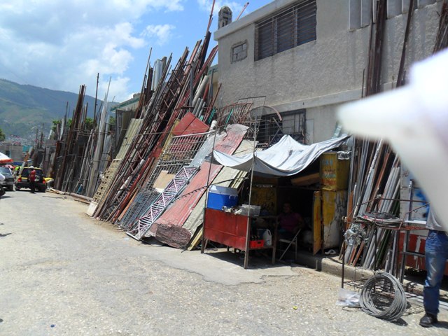

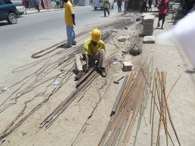

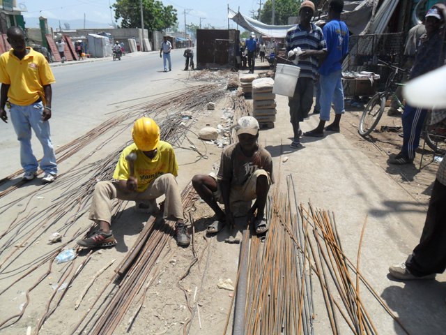

There were two men sitting on the ground with hammers and pieces of rail road track. They were straightening out bent rebar so it could be sold. Minimum wage is about five dollars a day. But think about earning minimum wage doing this in the sun in Georgia. Right now our temperature and humidity is comparable to that.
Used steel sales are to be found. If you don't like haggling price then settle for new or pay twice new price on the street. I don't like haggling price but feel I am competent at it. Haitians are experts. I hope to improve.

They sent me photos of the tools I would have available when I got here. The welder is a Lincoln tombstone buzz box. Tombstones are my last choice for this job with the thin materials. My choices for amperages range from way too hot or difficult to work too cold.

If I was asked what would be the worst welder to use for welding thin material I would scream out an old Lincoln tombstone without thinking. Yup, that's what I got. Forty amps is too cold unless you have a pretty good gap. 60 on the other hand is like welding with a plasma cutter.
I would be discouraged about that but for the fact that the frames I'm using for material was made in a jig by some kid in asia using 6013. If he can do that then I can do better with 6011. I'll just complain the whole time I'm doing it.

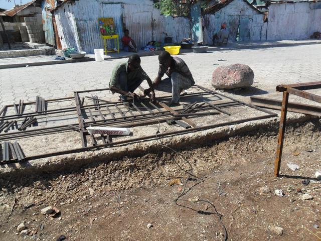

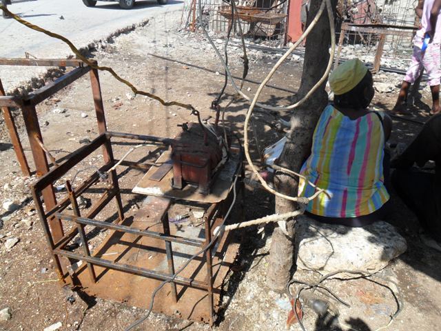

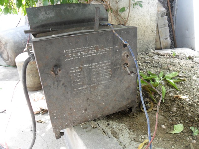

Here are some photos of a Haitan gate shop. The power is stolen off the grid. A home made transformer is hot wire to the power lines. The vise ought to interest you as much as the fact that they use 1/8 inch rod and no adjustments.

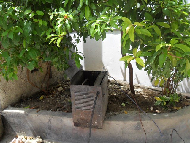

I've been to two welding shops where they had tombstones. All the machines are set to the max and all I've seen is 1/8 and 5/32 rods. The welds I've seen are tacks, some one on top of a kazillion more.
Yesterday I watched a welder repairing some stuff at a house. The machine was maxed out but only plugged into 115 volt and he was using a large rod, again tacks.
Even in the shops the welding hoods were hand held. On the street they use sunglasses.

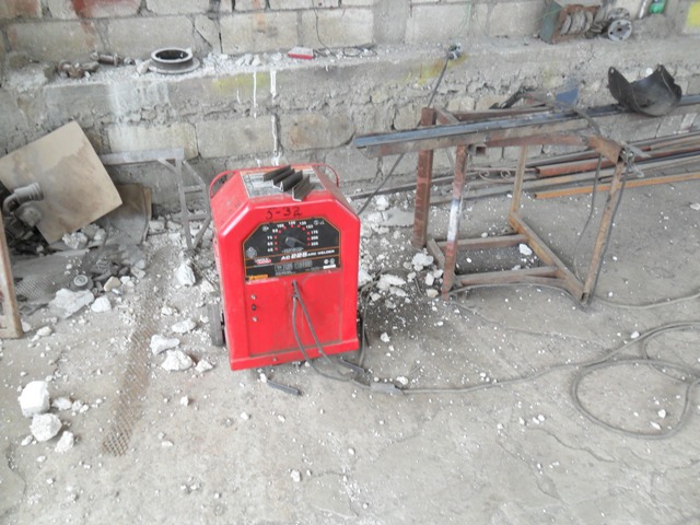

/ Welding in Haiti
#16

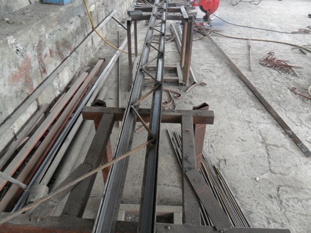

These pictures were taken in a the welding shop at a recycler. We had went there to find some steel. That wasn't going to happen because any steel of value was for sale on the street. The stuff brought in here is worth nothing but for pure scrap.
