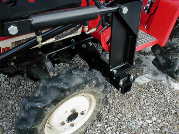

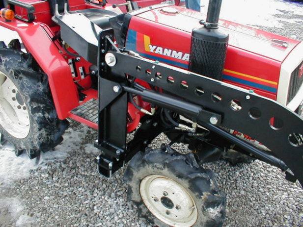

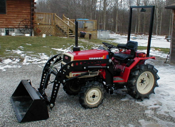

   / Welding Loader Mounts
Here you go Whiskey!
Don't laugh too hard at my welding.
#9
Mount
Other Side
