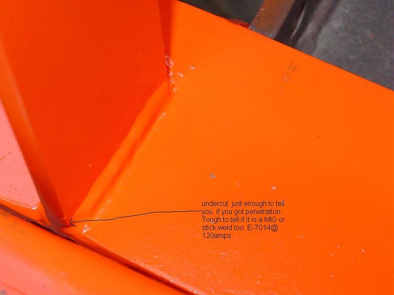

I have a set of 40cf oxy/act torches and a Hobart AC Stickmate. With a 115volt MIG you will have to bevel your thicker 1/4 inch thick metal to get acceptable penetration. With a stick welder, good penetration is easy obtained by extra heat a 220volt stick welder provides. The pix of my recently made tractor grill is a 7014 elecrode at 120amps. Tought to tell if it is MIG or stick.
