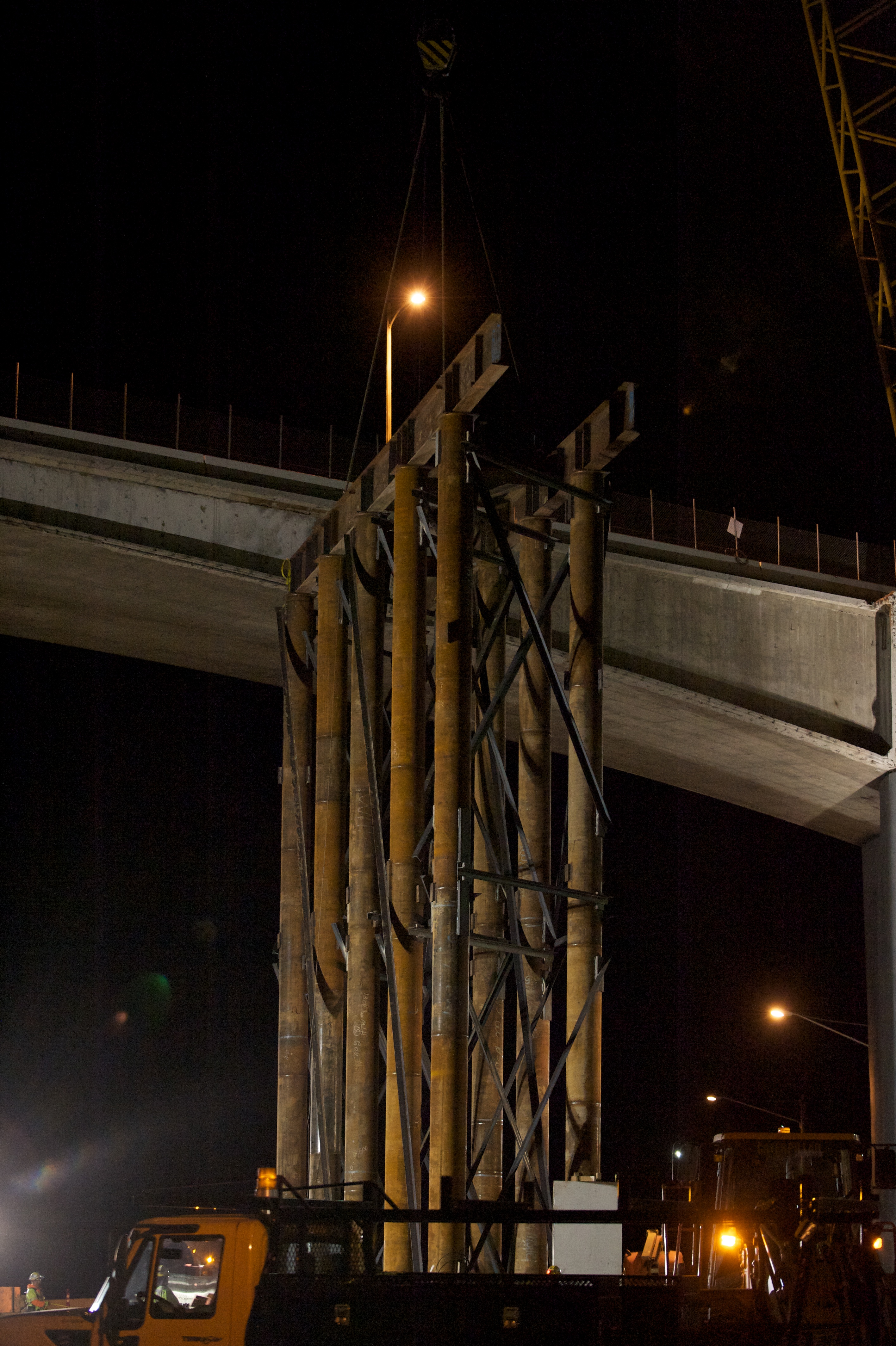

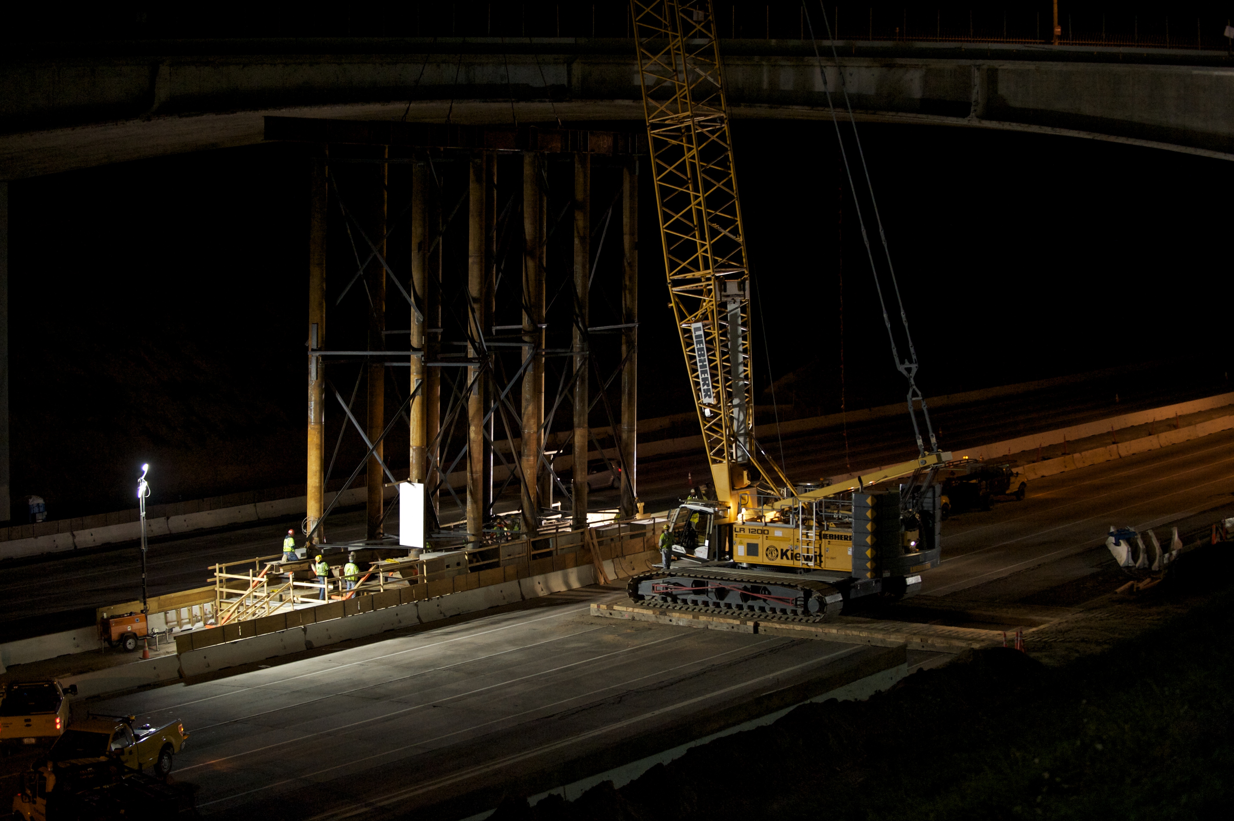

sixdogs you wouldn't believe the amount of bridge, and over pass falsework that is built with self shielded wire. And nobody takes the time to wire brush the rust off the weld zones.
Yeah, that's with somebody like you welding it. I've seen pictures of your welds and we're pilgrims in comparison. :D
