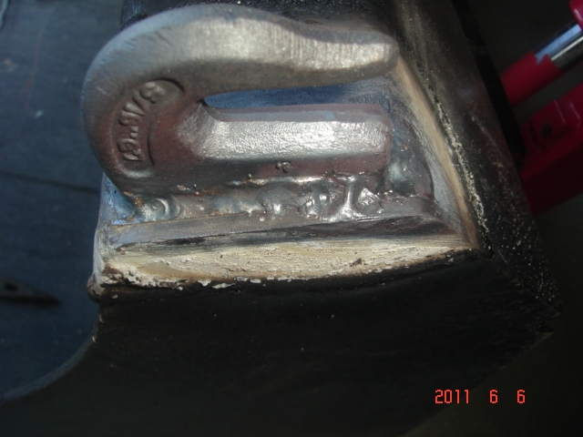

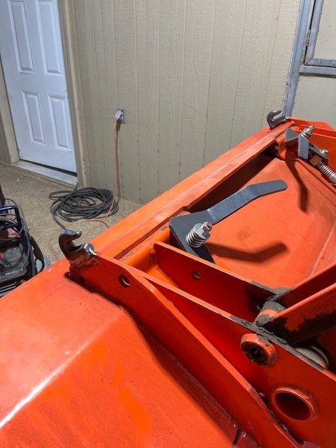

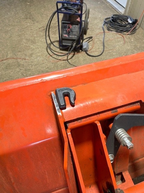

I have welded several times on my tractor without disconnecting the battery. I simply grind a bare spot for the ground clamp close to the work area to ensure the path way.
My work included some heavy bucket hooks.
