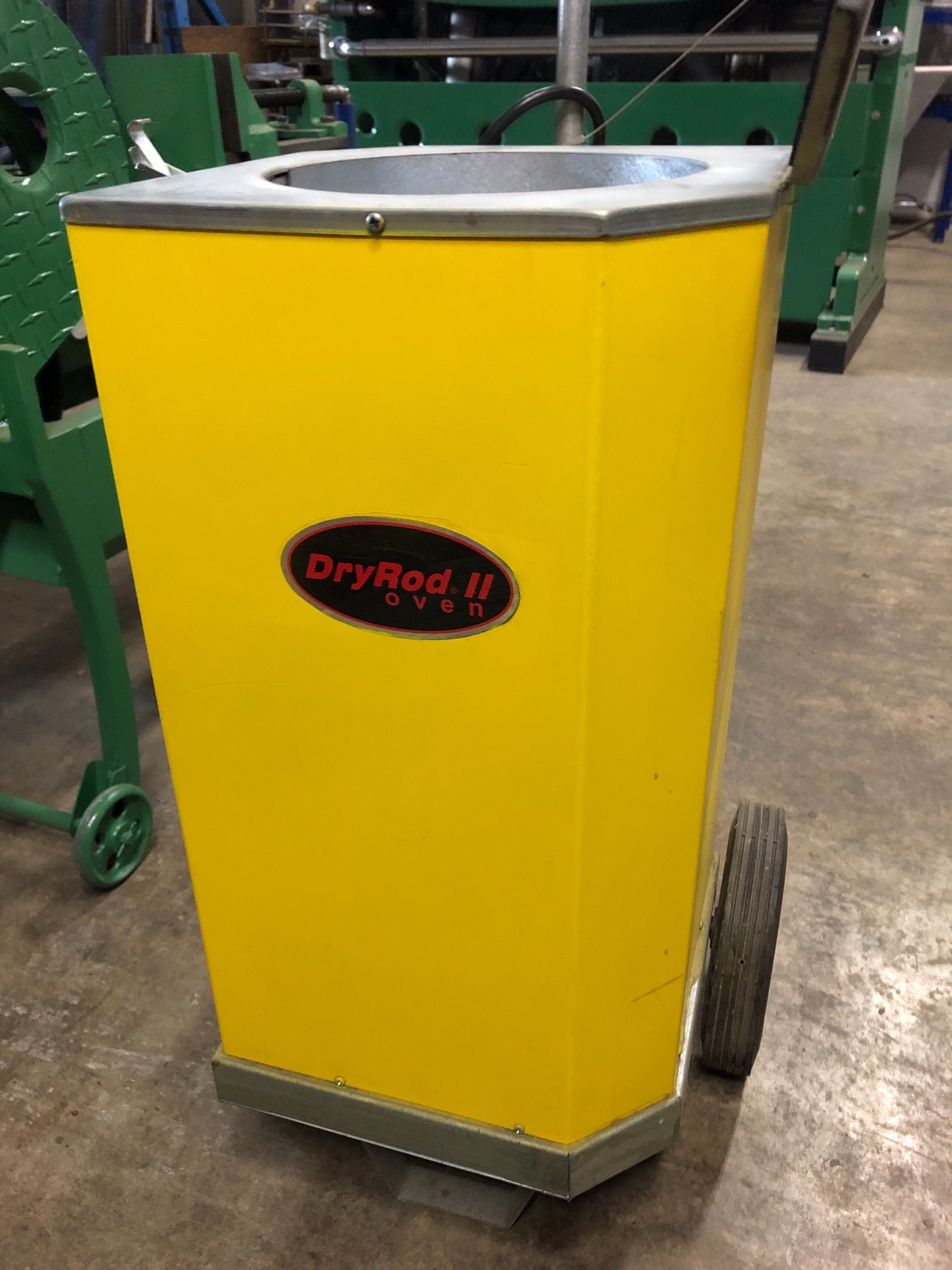

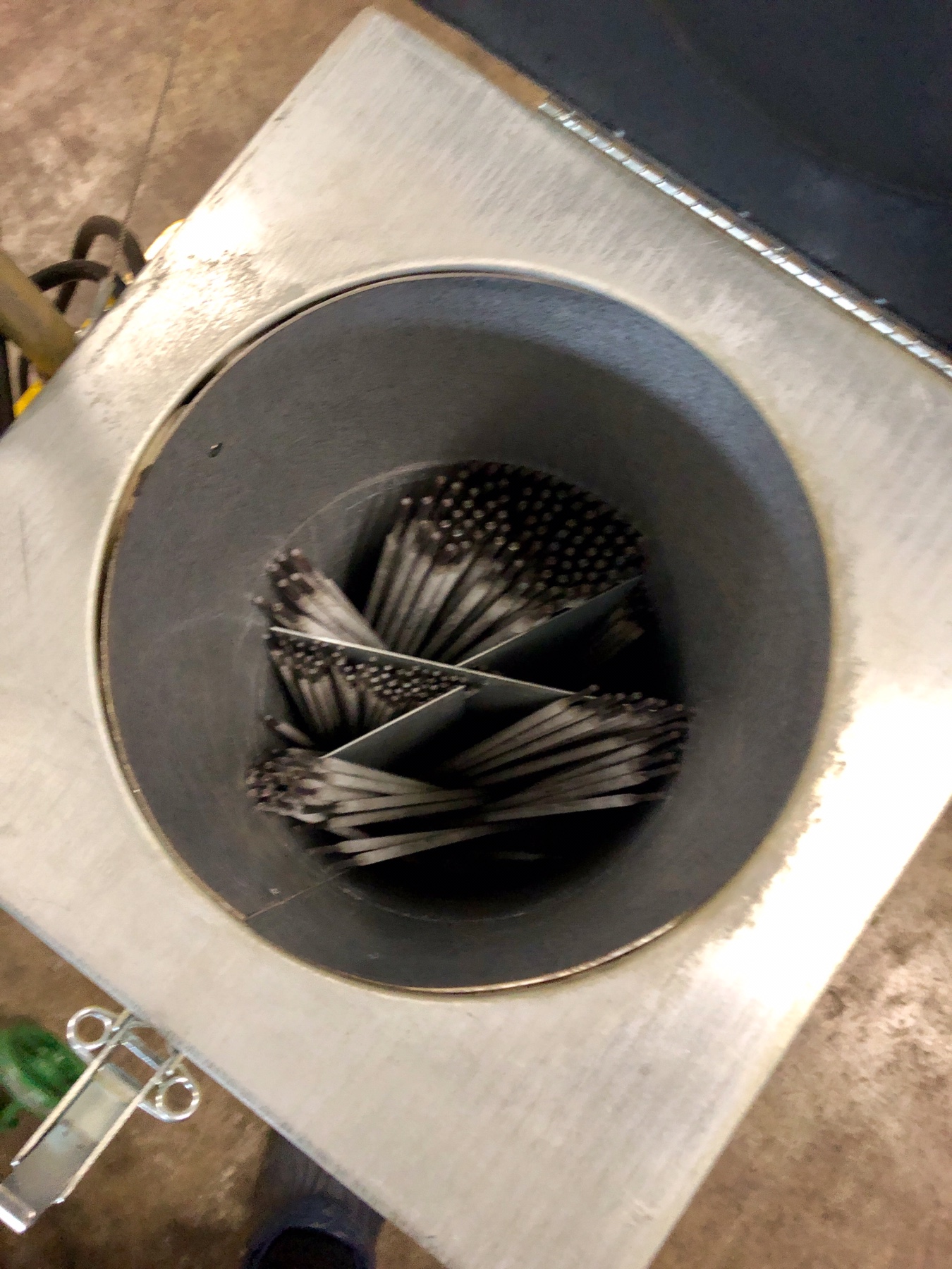

Lincoln Electric calls for opened cans or packs of 7018 to be stored at 250-300°F.
This is for welding done to code as low hydrogen rods are easily susceptible to absorbing moisture from the atmosphere.
Most likely for NON code work rods from opened packages that have been kept in sealed containers will be okay.
I have a 50 # capacity rod oven and perhaps because I am NOT a pro welder I find I can run a HOT 7018 much better than a cold one.

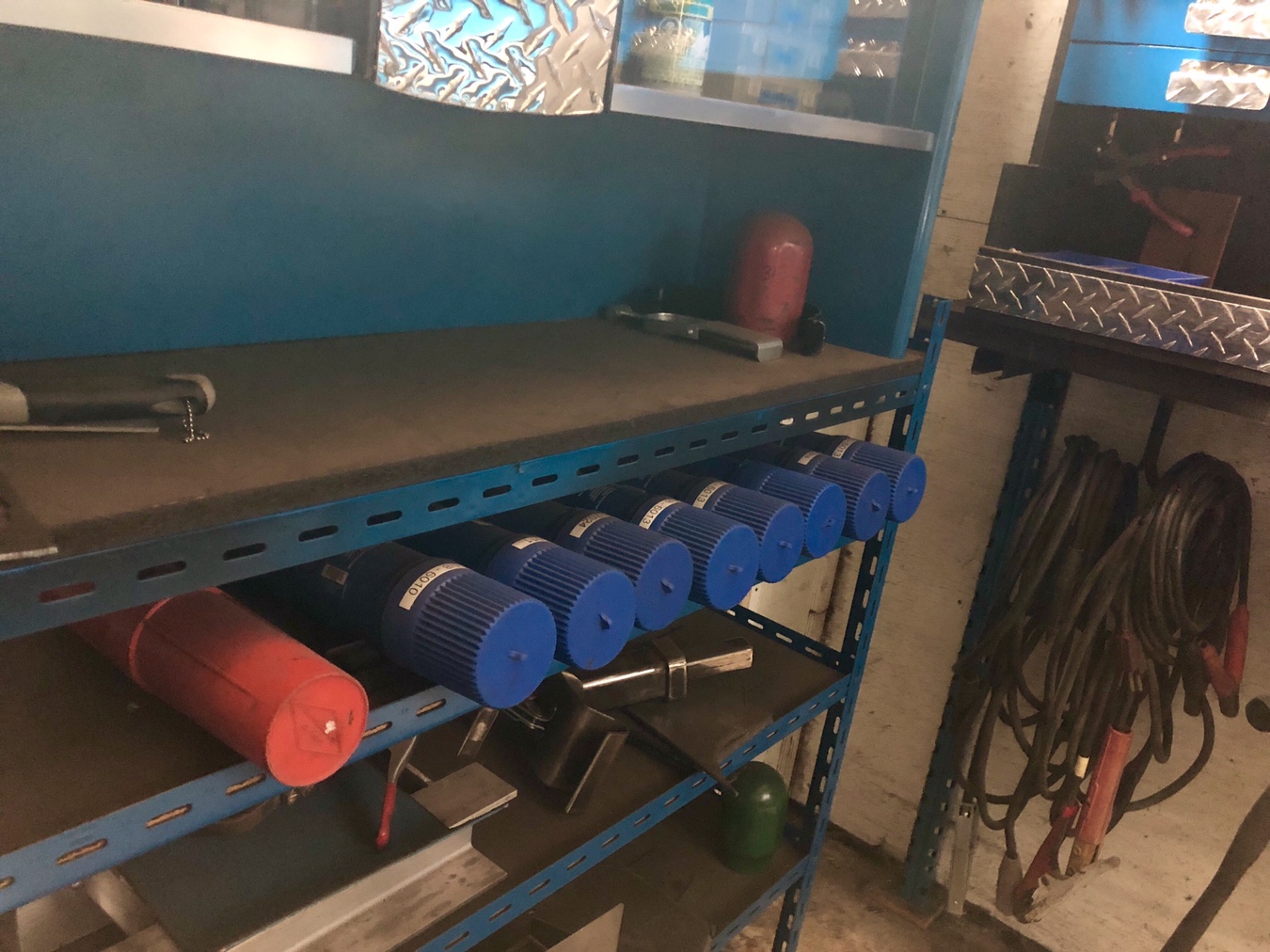

I store my opened boxes of NON low hydrogen rods in sealed plastic rod tubes available economically at most stores.
I could be wrong but it is of my opinion that it’s best to keep your 7018’s in an airtight container OR ideally a proper 250° rod oven. You may be wasting your time with light-bulbed fridges or anything in between. Please keep in mind these are observations and opinions of a NON pro welder.

I do the same.. Small quantities, keep them sealed in the containers shown above that have rubber gaskets in a cool dry humidly controlled environment. When I open them to get some rods out, I close them back up quickly to hopefully not absorb any more moisture than they have to. It has worked out for me so far. I know a rod oven would be better but I have done well with the 7018 without it. The 6011 of course don't need a rod oven, in fact I believe they need some moisture to run well.
