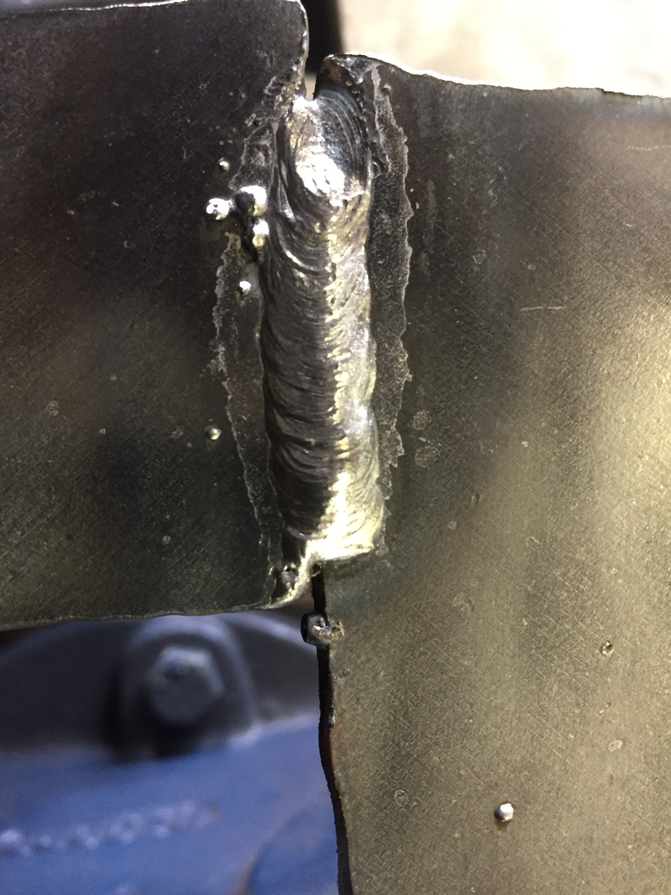

daugen. The smallest rod I had was 3/32 6013. I played around on some 12gauge scraps and this is the best I could do:
I used an inverter machine similar to yours. 80 amp DCEN. I had the advantage of cleaner material to work with and a welding table to act as a heat sink.
A backing plate and 1/16" rod as others have mentioned would help for your project.
Keep at it.
Terry

Daugen:
One thing with using the smallest rods is that they 'wobble' as nervous novice hands try to get position and arc started and eyes focussed etc. Your 'spare' hand can steady the end of the rod - Wear your leather welding gauntlets and rest the rod across the back of your fingers.
Practise running fast beads on clean scrap steel. You need to move fast laterally and vertically since these rods burn away quickly and you have to maintain a short arc length.
Heat sink will help.
I do think you should weld patch plates across the affected area, joining onto areas of good thick sheet-metal. After all, you're looking for 'function' over 'form'.
