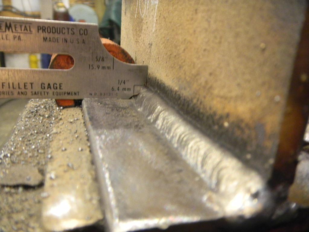

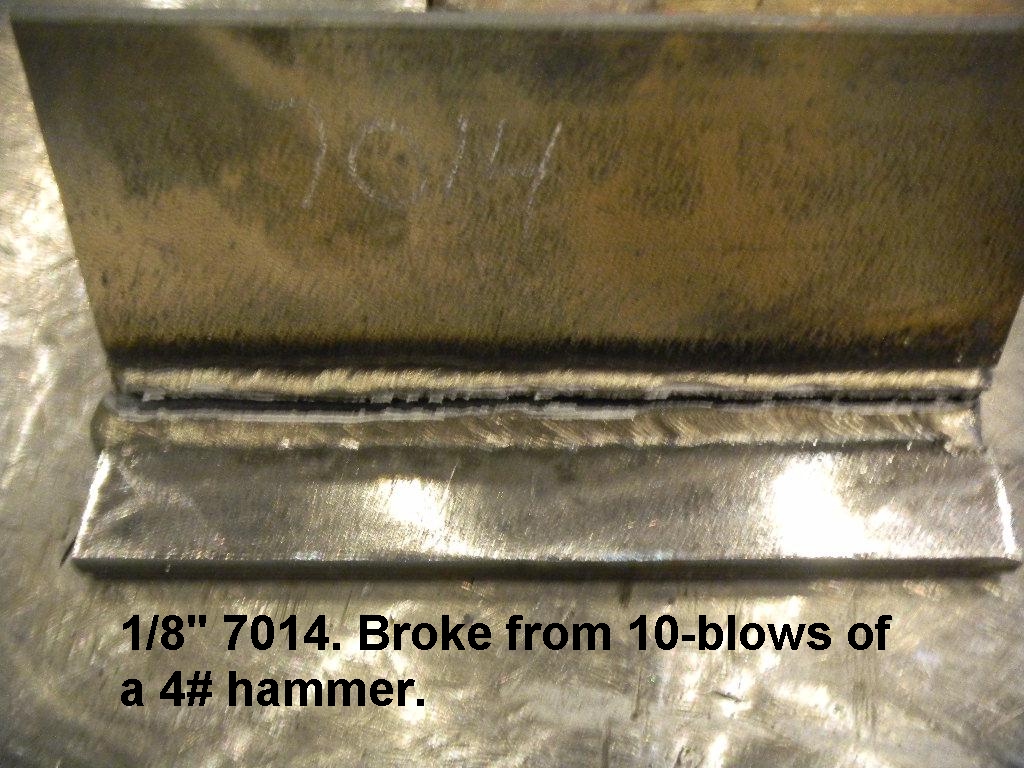

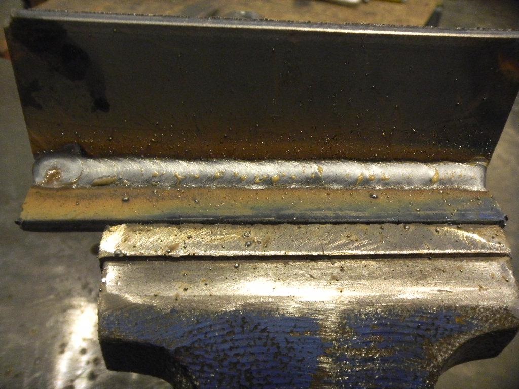

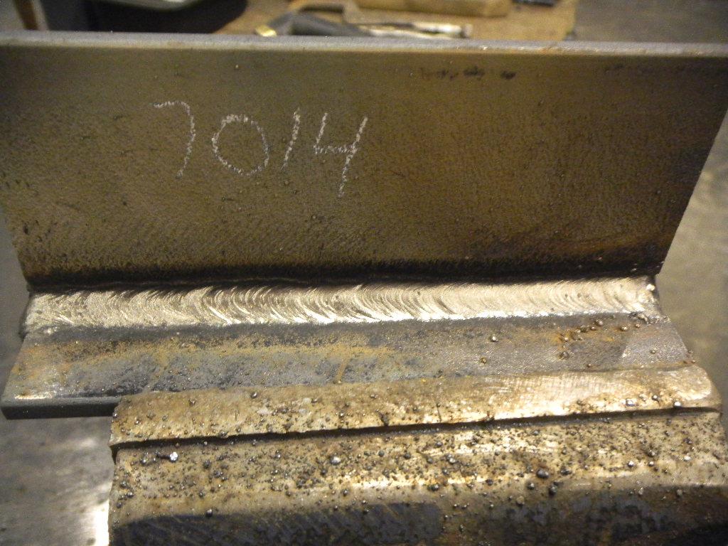

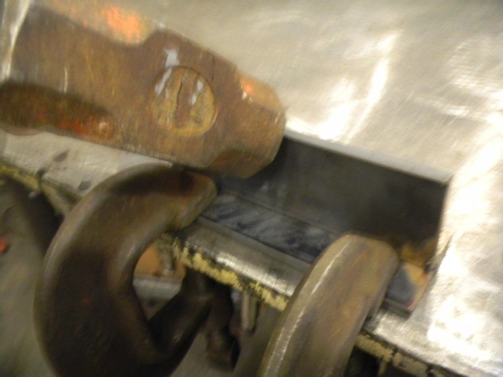

sd455dan several years ago I did some fillet weld break tests. 7018 that never seen the inside of a rod oven broke with 18-blows from a 4-pound hammer. 7018 right out of the rod oven broke with 23-blows from a 4-pound hammer. 7014 broke with 10-blows from a 4-pound hammer.
And if I remember right, the one process that is cursed among many structural welders as no penetrating, and being a glue gun.....did the best on your tests.

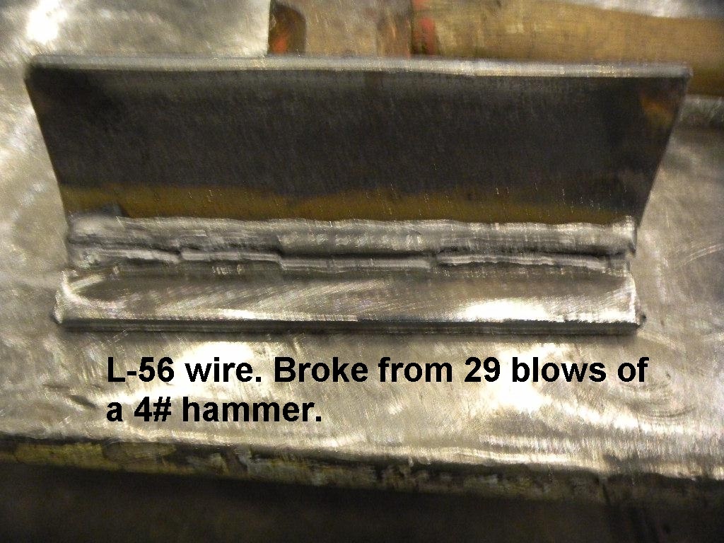

Yes, Lincoln L-56 Mig wire broke with 29-blows of a 4-pound hammer.

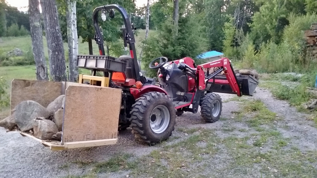

I added weld and reinforcement to the L angles. Mine is good for over the 500 lb. rating now.
