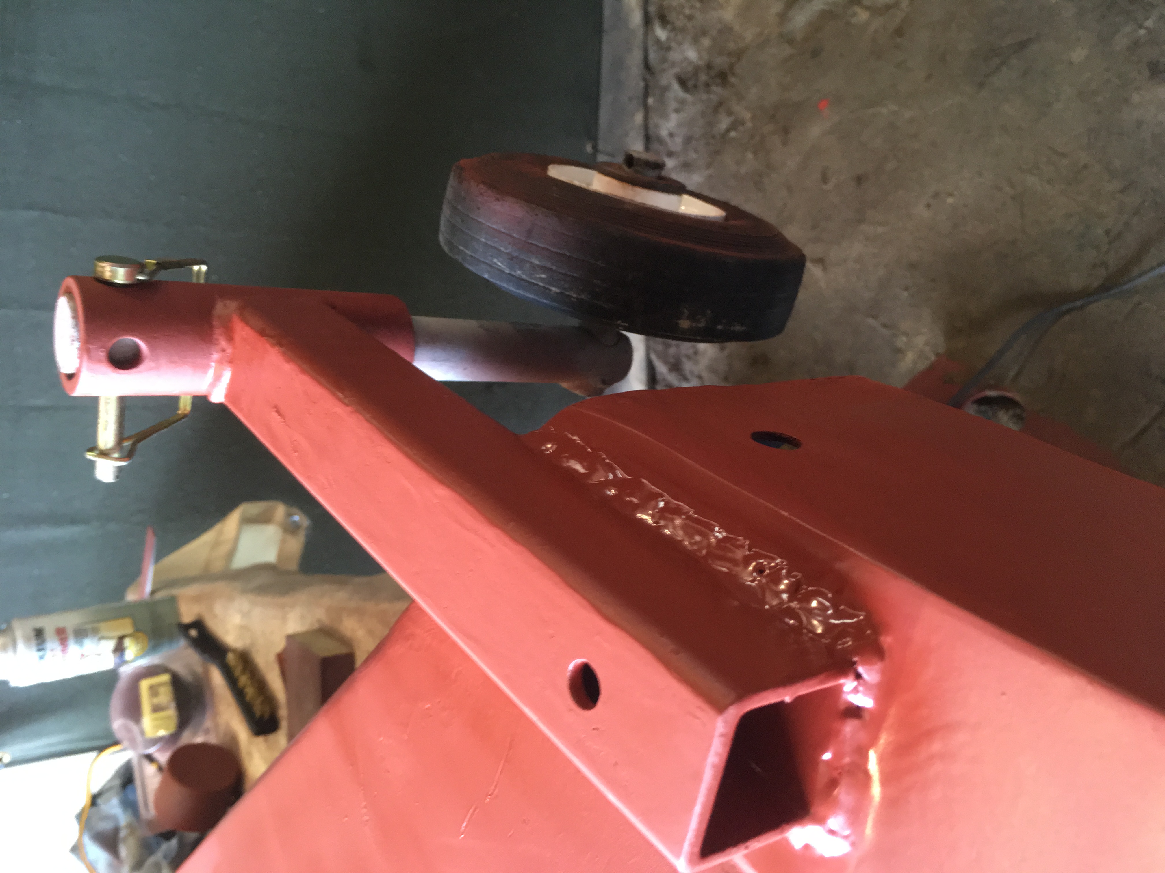

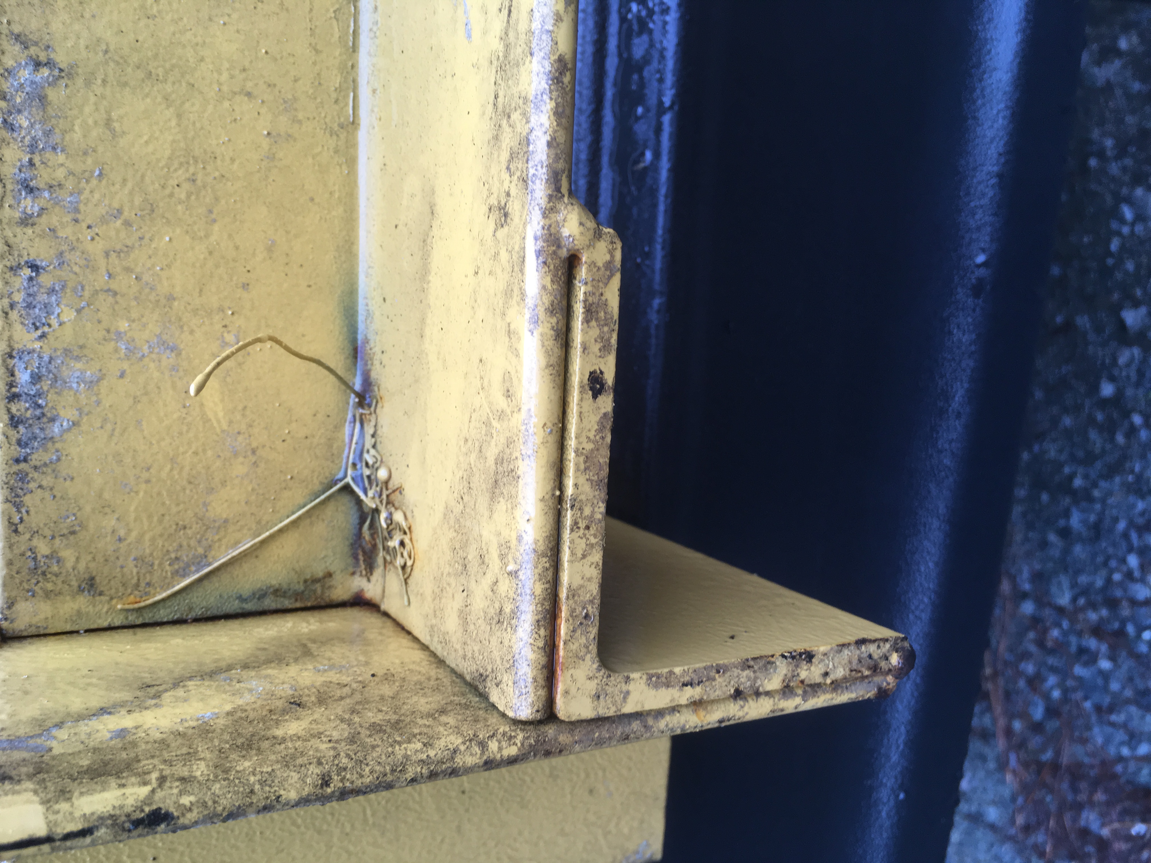

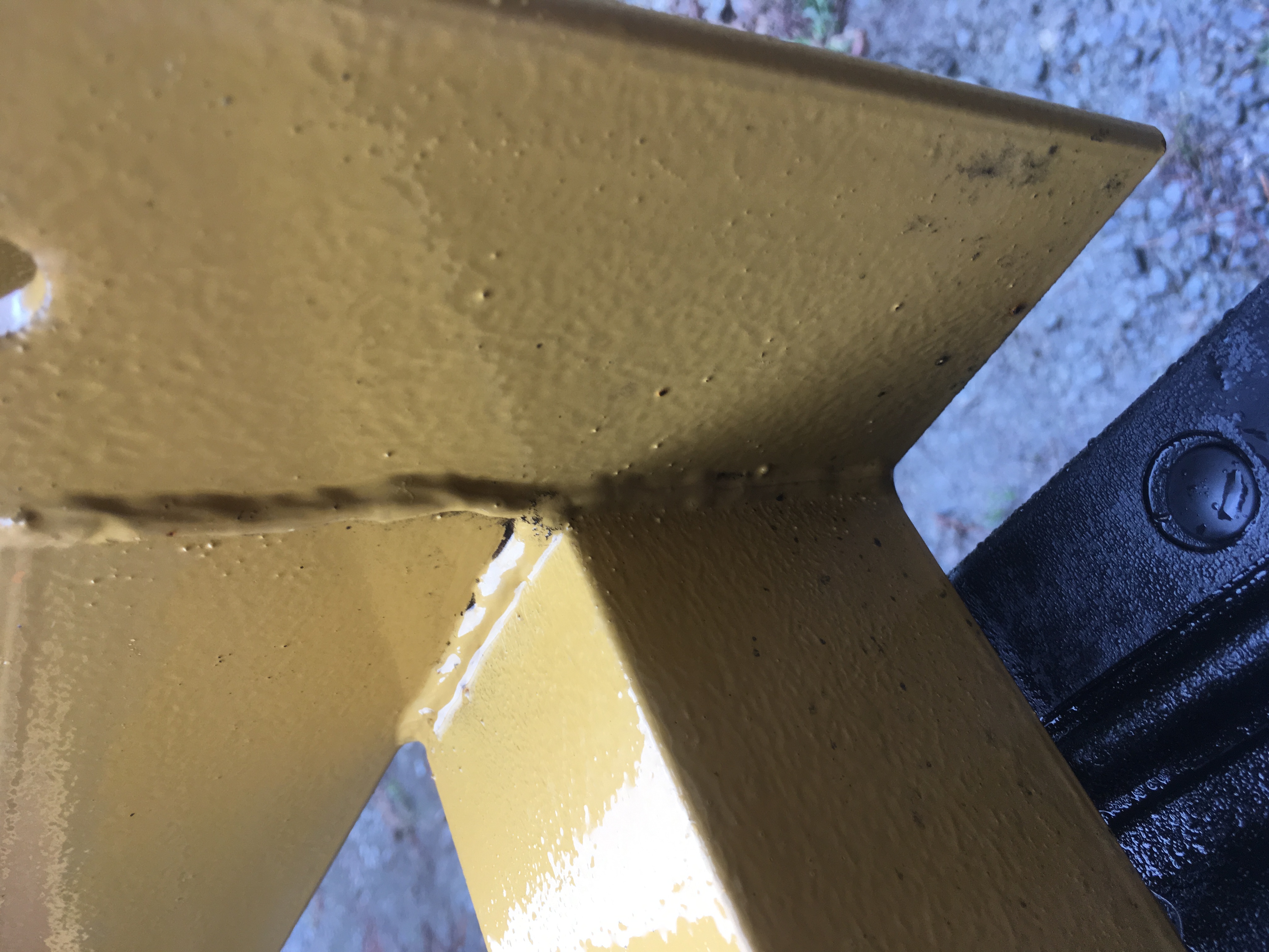

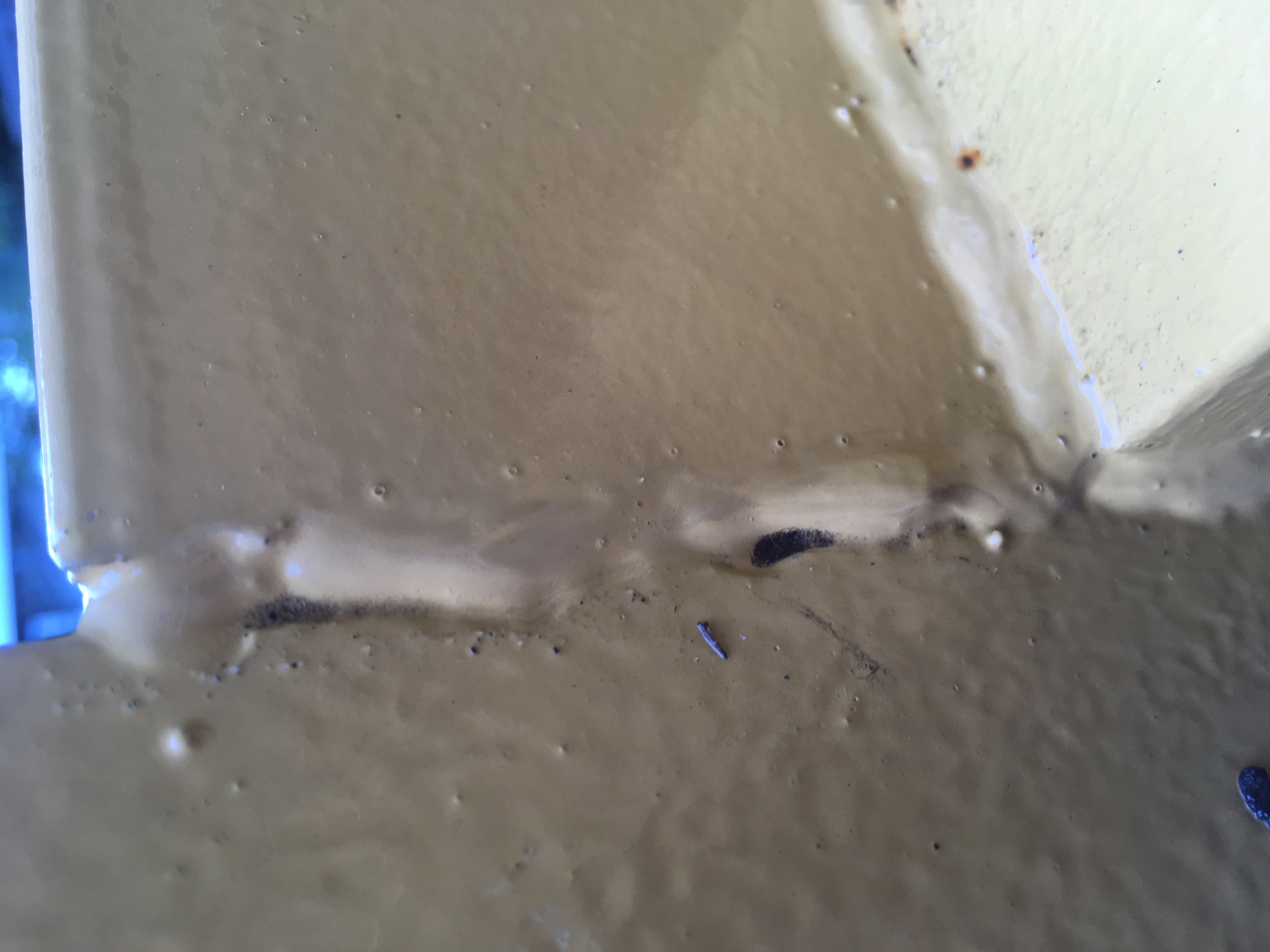

#206

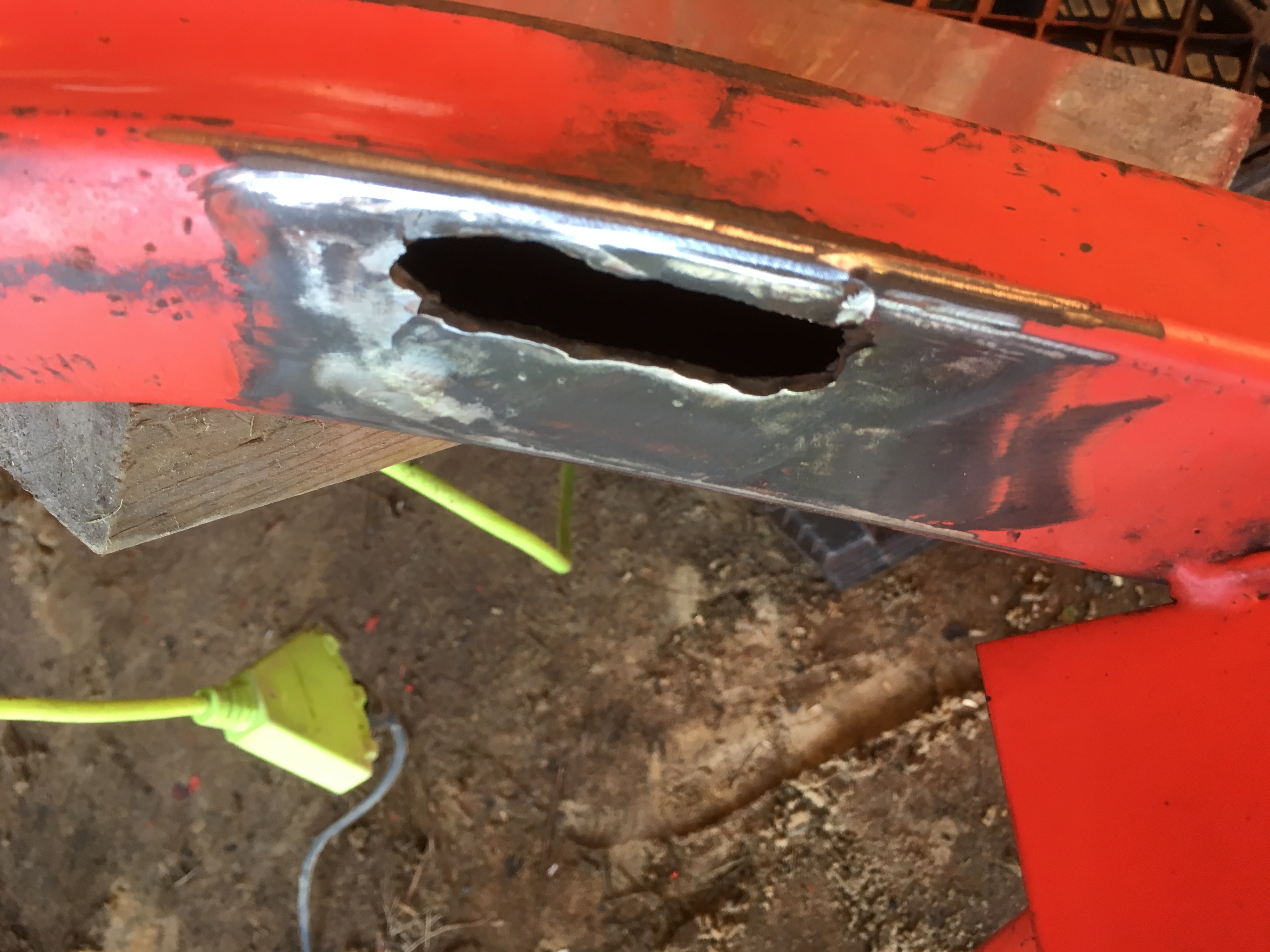

I had to chuckle when I got my TSC carryall yesterday. It was looking pretty good until I turned it over.
Looks like someone went to lunch and didn't come back.
I'm going to take a power wire brush to remove the paint and put a few more welds in where they can't be seen.
Going to use 7014.
When all the stress is being put on one relatively small area, why wouldn't they weld it all?
I'm guessing the welding inspector went out for the same lunch.
Some of it is ok, just looks like they didn't finish
I'm in the middle of painting that mower deck and will post the final result. Sure looks nice from ten feet away.

I wonder where this thing was made. Wherever it was, there was certainly no welding inspector in attendance.
That mess is real third world welding.
Did the spool gun run out of wire there? How did that bird's nest get made? (never used a spool gun)
I'm going to wind up repainting this carryall anyway so figured it made sense to do a little welding first.
I already have the 2x6 decking wood ready to cut, but obviously should get welding done first.

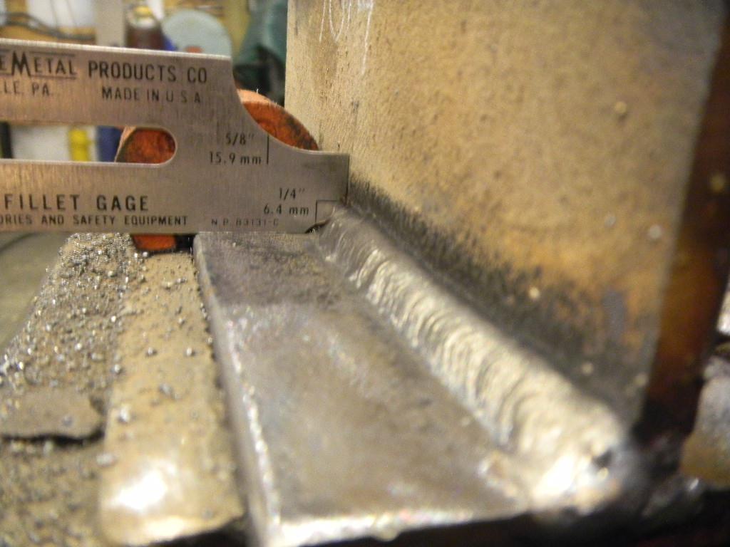

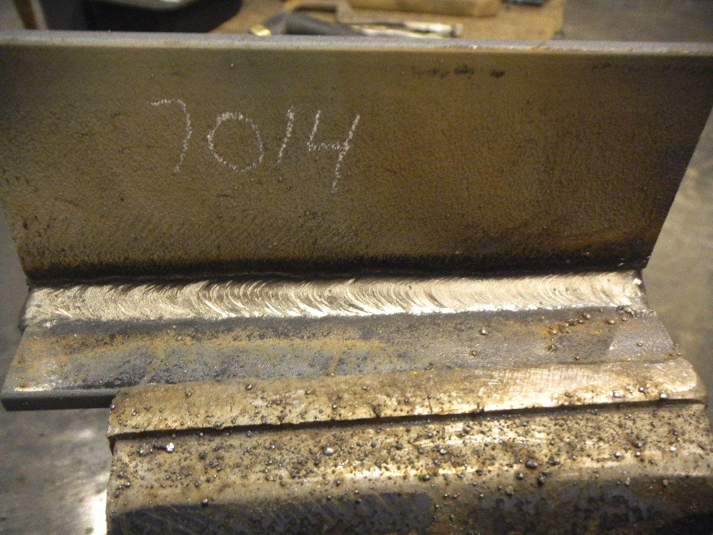

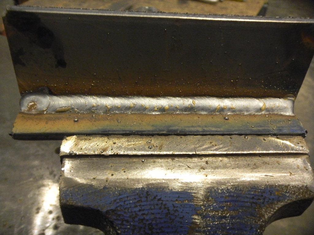

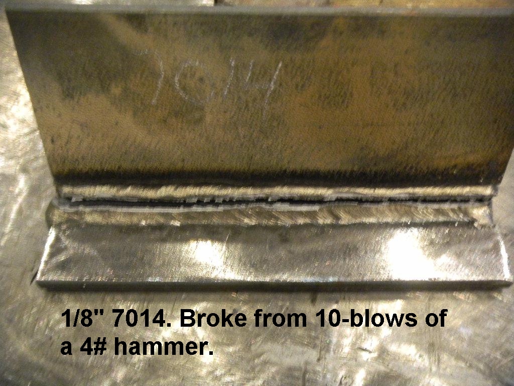

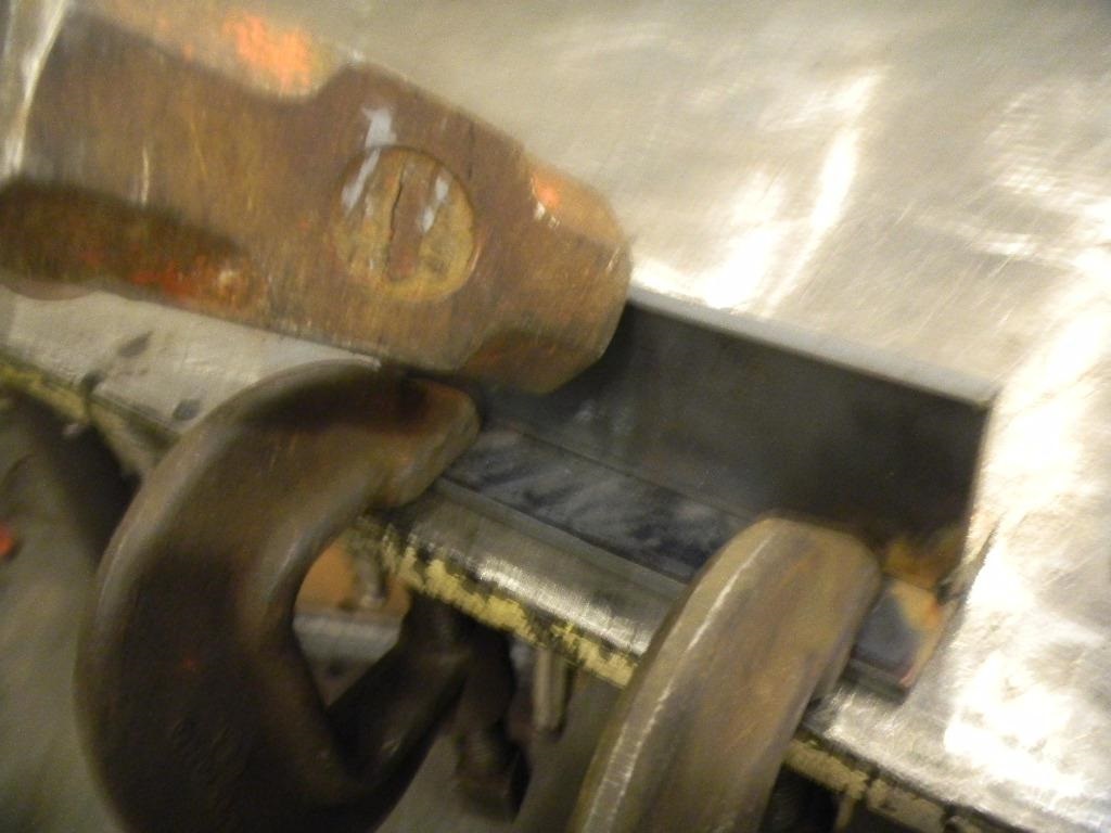

sd455dan several years ago I did some fillet weld break tests. 7018 that never seen the inside of a rod oven broke with 18-blows from a 4-pound hammer. 7018 right out of the rod oven broke with 23-blows from a 4-pound hammer. 7014 broke with 10-blows from a 4-pound hammer.
And if I remember right, the one process that is cursed among many structural welders as no penetrating, and being a glue gun.....did the best on your tests.
   / Welding Rods for beginners #216

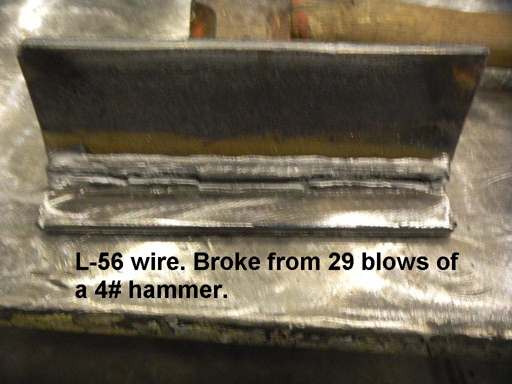

Yes, Lincoln L-56 Mig wire broke with 29-blows of a 4-pound hammer.

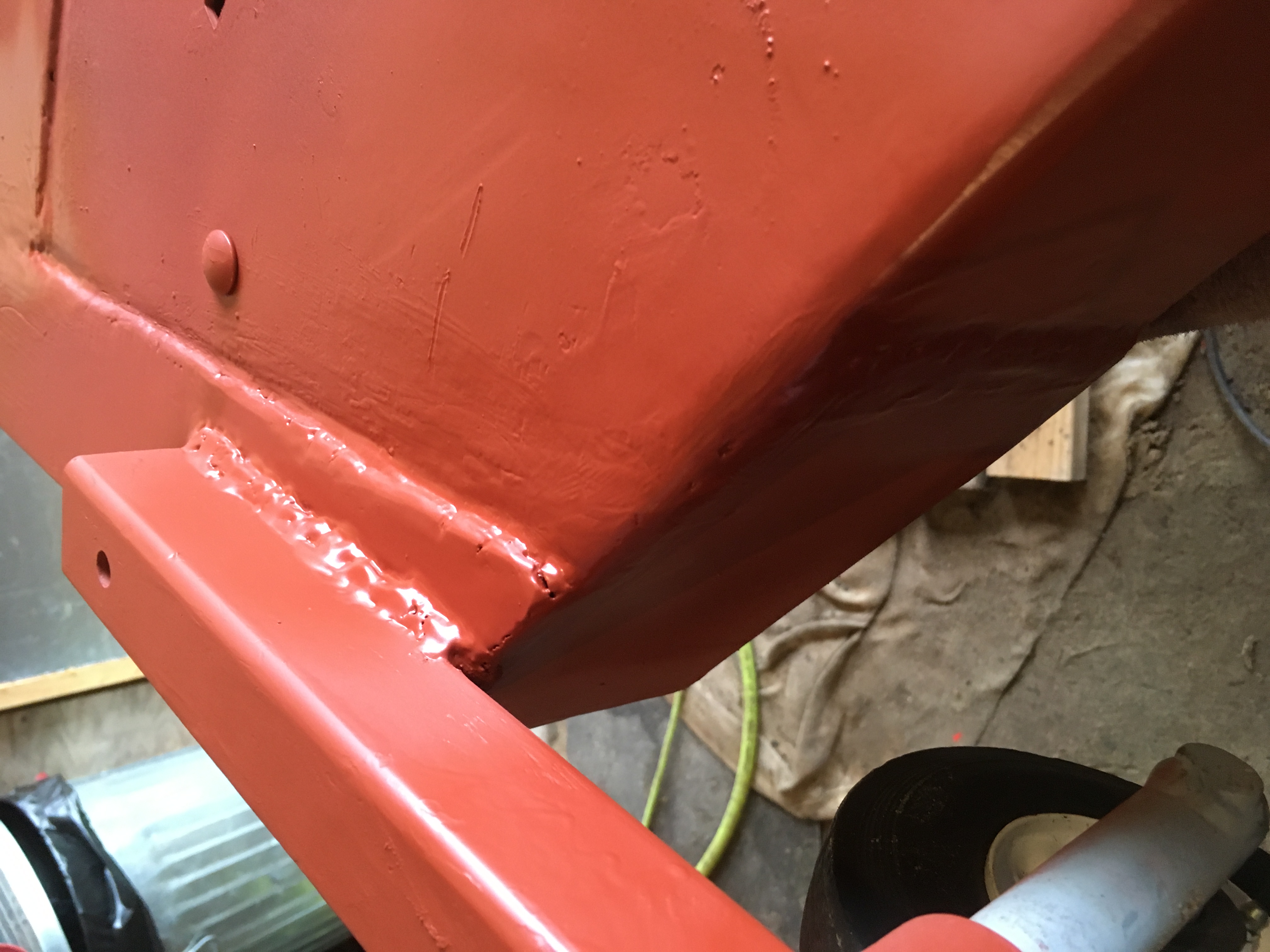

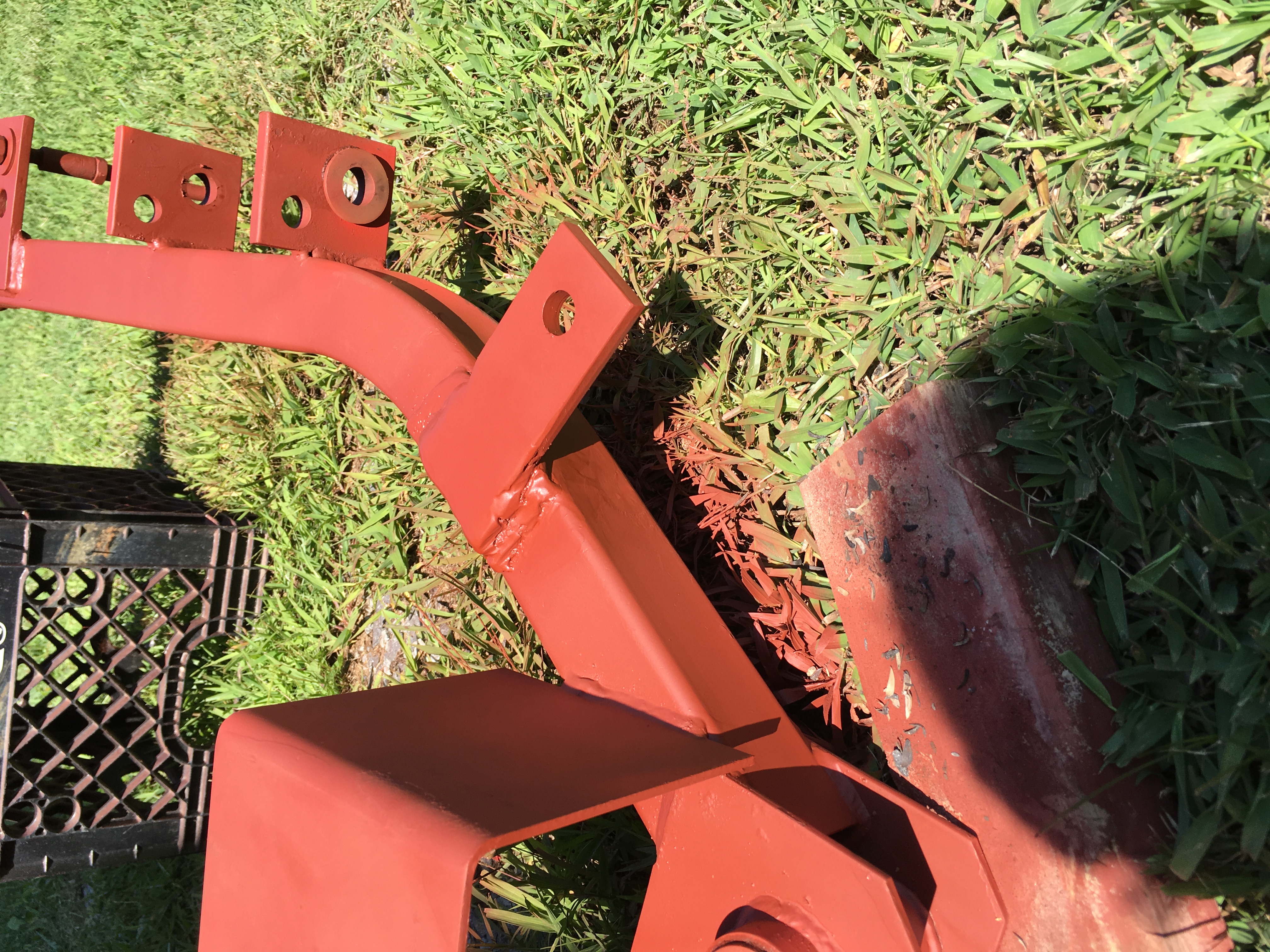

That's why TSC can sell these things under $100 when on sale and made in USA.
I bet the manufacturer as at least 30 seconds of weld time in the manufacturing process.
I added weld and reinforcement to the L angles. Mine is good for over the 500 lb. rating now.
