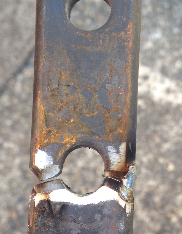

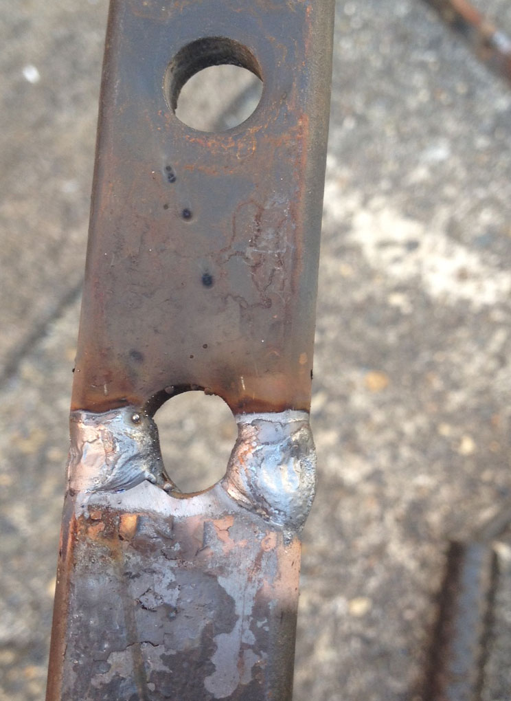

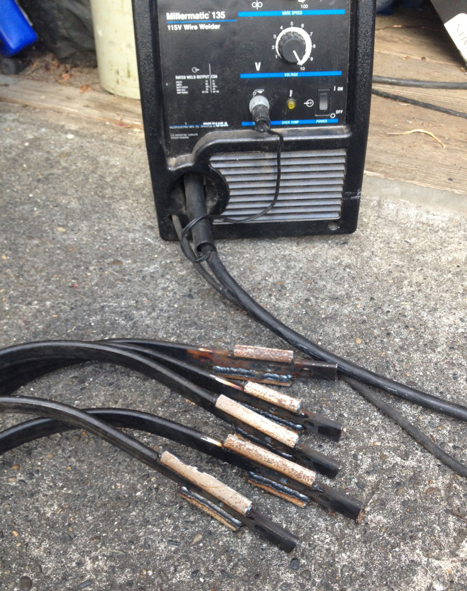

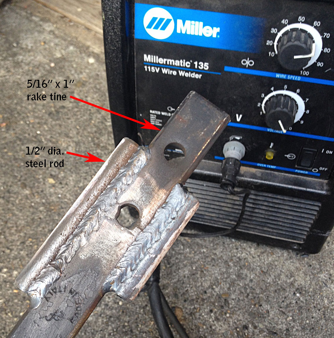

OK welded up 6 tines today.
Welded other side then ground the tack off before welding it up.
Used 2 different lengths because it just "seemed" like if they were same length then it's likely to break at the end of the doubler rods. It "seems" like if the doubler rods were different lengths then it can't figure out where to break. I guess time will tell if this was a good idea.
Voltage maxed, wire feed speed at about 75. Blew a 15A breaker, so plugged into a 20A to keep going.
All stocked up again, even have spares now.

There's been some discussion regarding welding on 15A vs 20A circuits so this is pertinent information for those interested. I rarely weld any distance at the machine's full power setting so haven't encountered this 15A limit before (or may have forgotten). Half of the six tines were welded on the 15A circuit before the breaker popped. Each tine has about 13 inches of welding. So welding 3 tines in quick succession (with the machine set at max power) pops the 15A breaker. Now I know.
If I slowed down a little the 15A circuit coulda done it, so anyway now I know what pops a 15A breaker. I do not consider popping a breaker to be a worrisome incident for this kind of repair. Maybe,,,, if I was right in the middle of the best weld EVER, and had intent to publish a photo,,,,, :D .
Been trying to find time to get these tines fixed for a couple weeks now. I consider these tines properly fixed & if they bust again replacing with new tines is a $12 option. Have a simple plan using 1/8" flatbar to add "bend limiters" which could extend the life of the remaining (un-molested) tines.
