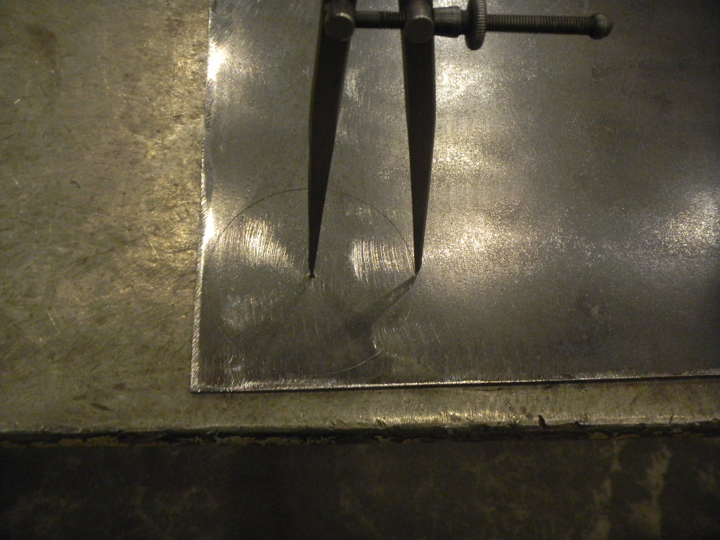

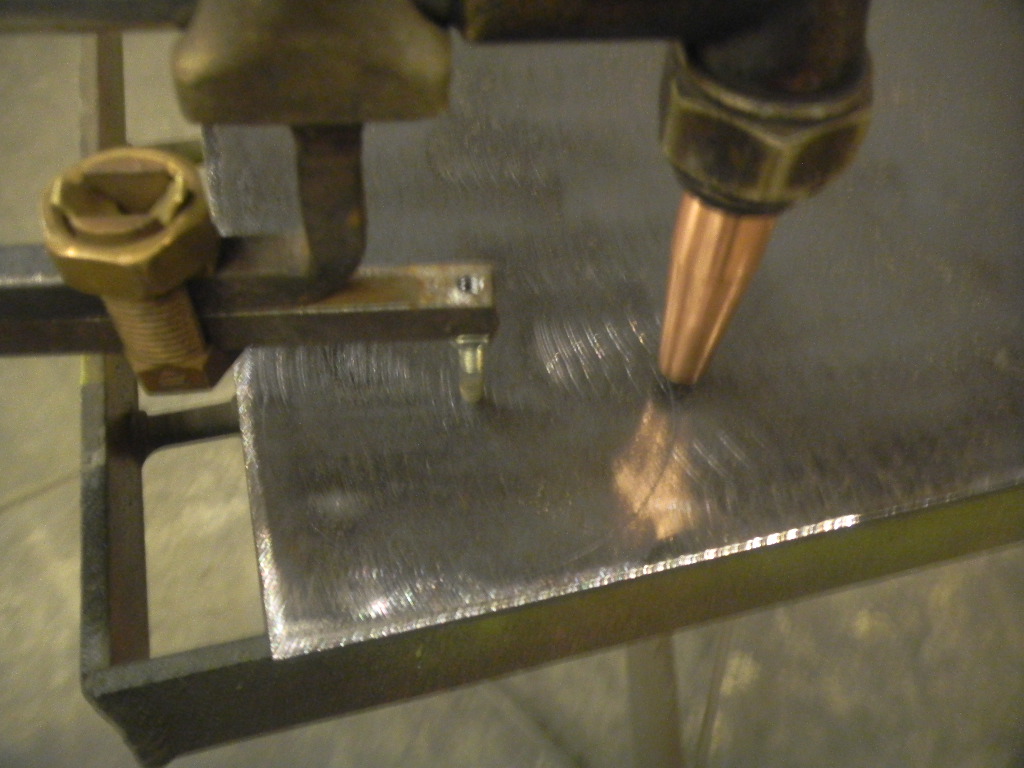

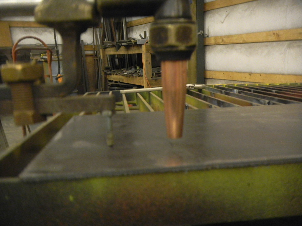

Please forgive the pictures, it's hard to hold the torch's cutting tip perpendicular to the plate and take a picture.:eek:
If the circle cutting attachment is built correctly the horizontal, (long key stock) will be 90-degrees to the cutting tip. Once the height is adjusted for the pre-heating cones of the cutting tip, the correct radius is set, you can either watch and make sure the cutting tip is 90-degrees to the plate, or the long key stock is level to the plate. Personally I watch to make sure the tip is 90-degrees to the plate, then I can also adjust my travel speed at the same time. ;)

Not quite what I meant...that sets the initial height but what keeps the torch head from dragging? Been a long time since I've used mine and was only self- taught at that. I know you need to keep a bit of space between the tip and material with a plasma cutter, doesn't a torch work the same way?
I've seen some simple homemade versions of rollers that are attached to the base of the cutting tip. They consist of a couple rollers with an adjustable height to keep the tip the right distance from the plate you're cutting. But you would have to allow enough room from the edge for the rollers to travel, or else place the rollers back behind the tip.
I don't have any now or I would take a pic. You could do a Google search and probably find a pic.
I'm so shaky any more with a damaged nerve in my elbow, I need to make a set-up like Shield Arc's. I like the simplicity of his version with the key stock and electrical split nuts used as brackets. And I'll probably also make a set of rollers for the tip. :cool:
/ Welding table build #124
With a little practice it's not hard to hold the tip at the right height. I tried a circle cutting attachment once that had rollers and didn't like it. If there's any mill scale or the plate isn't perfectly clean, it's hard to do a steady even cut.

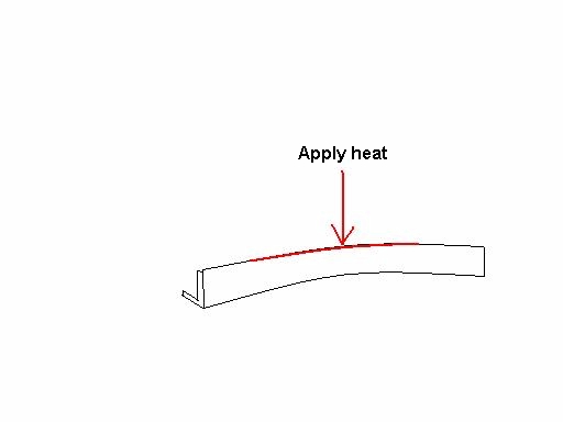

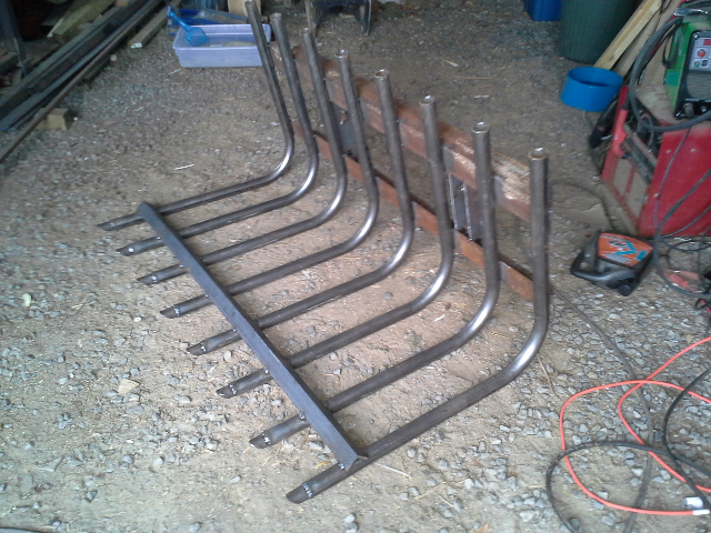

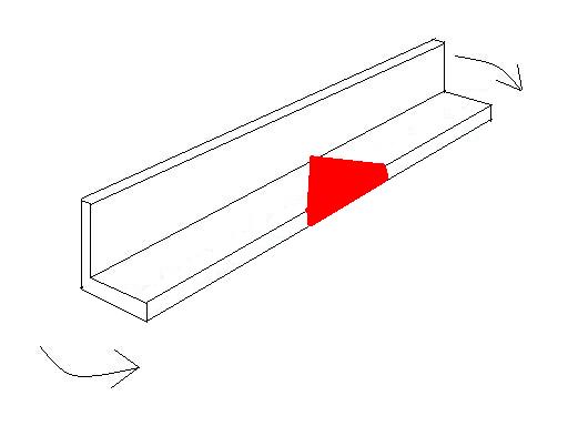

Hopefully a few of you from early on will still see this and can help me out. Kinda hijacking my own thread but hey, it's mine and what I need help with was built on this table.....
We had a very useful conversation on flame straightening and had it not been for this thread, I'd have never heard of it, nor realized that I have likely a good application for it.
Today I welded up my skeleton bucket (firewood bucket, bottom half of a grapple, whatever you want to call it). 3.5 x 1/4 angle as the back bones, 1.75 x .120 wall for the tines and 2 x 1/4 angle for the front stiffener.
The heat from welding the tines to the main angles bent the angles approx 1/4" over the 5' length, which has put a nasty twist to my bucket. This is after painstakingly measuring and squaring, double and triple checking and alternating my welds all over the place to try to help eliminate warpage. Now my new bucket looks like shiat and I haven't even burnt in the final welds on the bucket mount. I can't even get it.properly mounted on my loader to tack the pin bosses in place.
Unless you guys advise me otherwise, I'm thinking the best course of action would be to heat the top flange of the angle to draw it back into place. To me this seems like a good application of flame shrinking.
Having never tried it, (and been more than 10 yrs since I've sparked up my torches), I'm looking for any advice I can get.
/ Welding table build #129

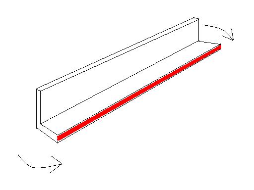

Before I heated that wedge like you have marked out. I would first try heating the toe of the angle. If that won't pull it back enough heat the wedge, or a circle where you have the wedge marked out.
