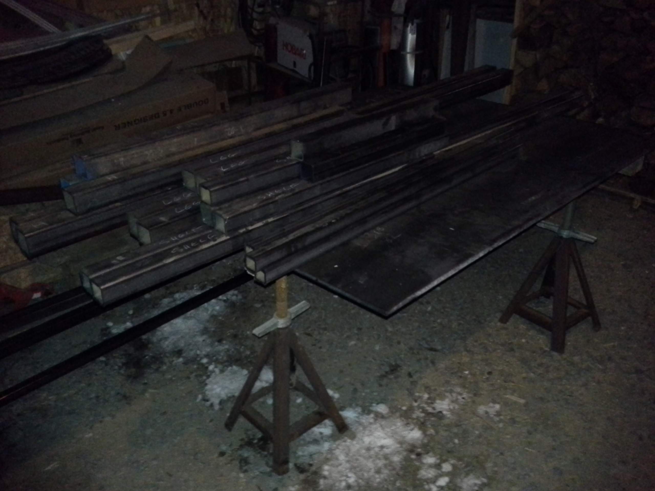

I got a handful of cash for Christmas and sold a 6.0L motor that I hadn't gotten around to using to buy a plasma cutter from Duncan at Everlast Canada. Still had cash leftover burning a hole in my pocket. With my birthday this past week, added cash from my wife, my folks and my mother-in-law and ordered up enough steel to build a welding table and have a couple chunks left over. Steel was ordered Thurs, delivered Friday and I started cutting today. Shipping slip says 1140 lbs. I'll measure up what is not used to calculate an accurate completed weight but it should be easily north of 900 lbs, closer to the 1000 I figure.
Overall the table will be 4 x 8 with 5' of it 1/2" plate and the other 3' will be cutting slats.
2.5" x .237 wall tubing used for top rails to accept 2" slide in accessories
2.5" x .188 wall legs
2" x .188 used for lower shelf supports
Parts cut and ready for prep and welding:
(Sorry for the dark pic)
A question for you experienced welders out there, particularly those that deal with heavy plate like this on a regular basis: How flat should I expect the 4'x5' sheet of 1/2" plate to be?
I figured it would be flat. Not flat like a milled surface but flat to eye with a 4' level. I've got roughly 1/8" gap under the middle of my 4' level when checking the 5' direction. I can pull it flat with a couple big ratchet straps and blocks of 8x8 but don't think that I should have to. I'm concerned that even if I pull it straight before I weld it to the frame, when I take the straps off, it will just return to the bow and pull the frame with it, defeating the purpose of building a flat table.

Possibly turn it over and try level again ? If it is the same , then just the shear weight is bowing it , if only supported on the edges . Possibly would need a support brace through middle in that direction .

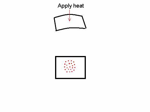

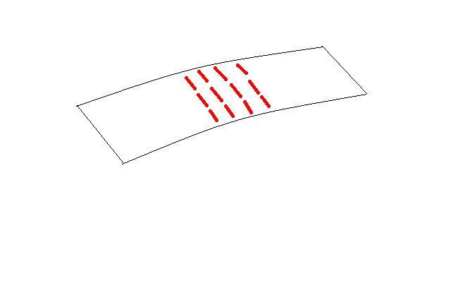

I don't have a lot of experience with this, but what I'd do is build the table with the bow up. Once the table is complete, I'd take my torch and use one of these two methods to correct the bow. ;)

Agree with S.A. , You never stated if it bowed in opposite direction if you turned it over ? If it does , it would be much easier to bow it down than to bow it up with heat . If anything , lay it with bow up on a hard surface and drive over it ??

Most of the new 1/2 plate I have encountered is dead flat from the warehouse. But then I always try to go pick one out myself. 1/2" plate with a bow in it is tough to straighten as it is probably stretched. I would get a piece of H beam, probably 6-8" and put as a strong back under the center at right angle to the bow. Get the plate pushed down tight to the beam, get innovative and figure a means to do that as there are many ways I can think of, put a series of tacks 2" long about 8" apart . That should hold it pretty flat. You will probably never get it dead flat like my smaller one is.

Its definitely the plate that is bowed. It's currently supported on the ends and the bow is up. The frame material stacked on top as on the pic did nothing to change it.
The main frame will be set back 2" from the edge for clamping. Using 2" x 3/16 for the cutting slats, I'll have 1 1/2" square crossers to set the 1/2" plate at the same height

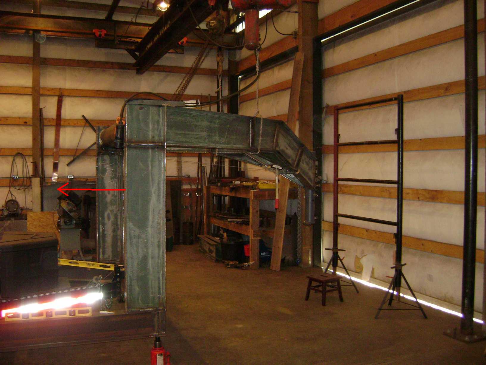

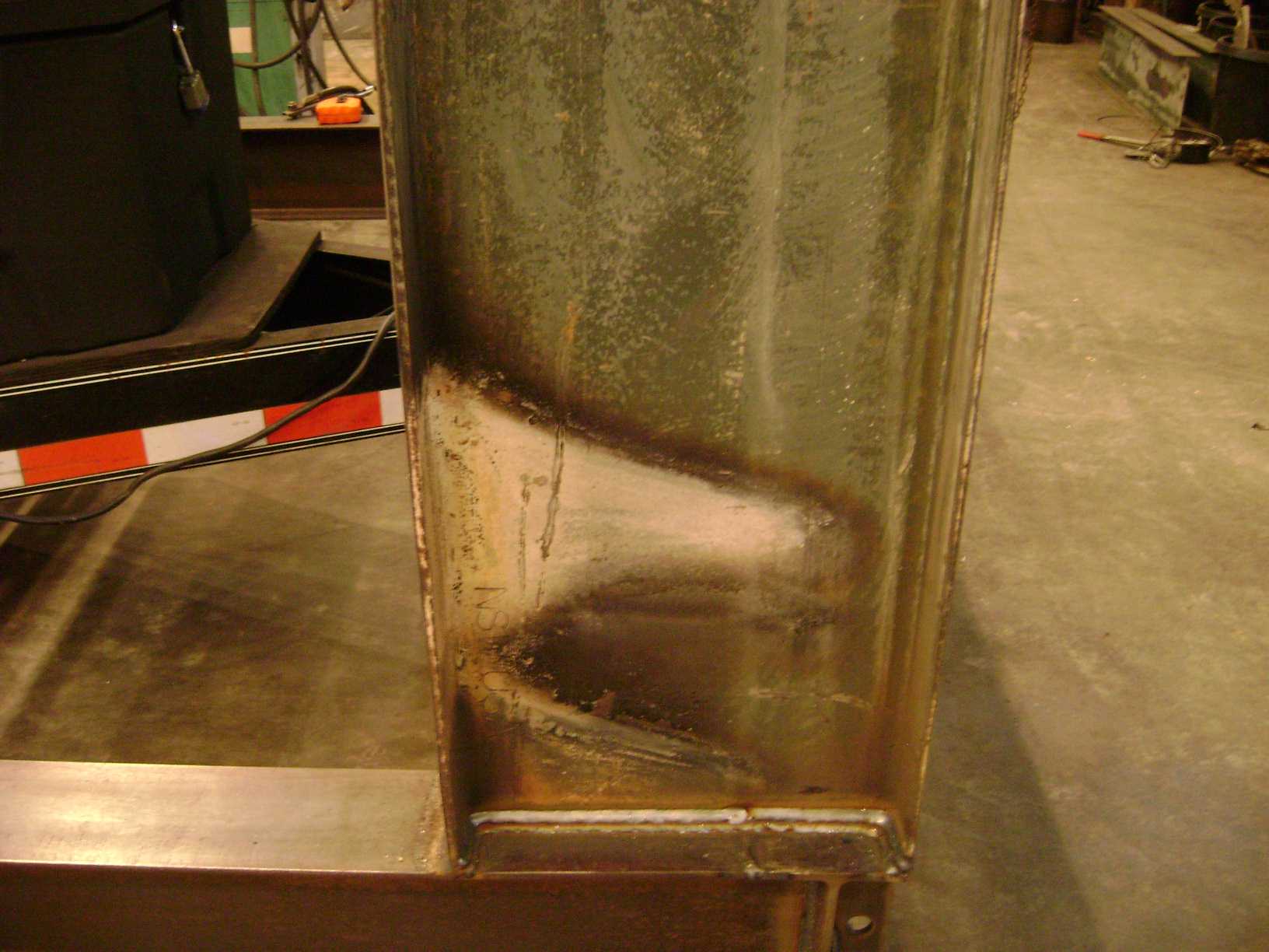

The theory of heat shrinking is easy, the trick is how much heat to apply. Sometimes you end up chasing your tail when doing it! :laughing:

Shield Arc,
Please explain what you're doing and why in the drawings in post 3 and the photos in post 11. I want to make sure I understand.
/ Welding table build #13
Well some people think it's voodoo,:laughing: but it's really simple! When you heat steel it expands, when it cools it contracts further than it was originally, the water just speeds up the cooling / contracting.;)

Shield Arc,
Please explain what you're doing and why in the drawings in post 3 and the photos in post 11. I want to make sure I understand.[/QUOT
In post 3, the lines and dots represent places you've applied heat with the torch and when those spots cool, they'll contract more than they've swelled and draw the ends of the steel upward and the places where heat was applied downward, is that correct?
In the third photo, that must be a pump type spray bottle in your hand. At first I thought you were applying heat with a plasma cutter and couldn't figure out why you weren't wearing a glove.
The final two photos have me stumped. Is the red arrow pointing at something or showing the direction you are drew the metal? Is the final photo the result of your work?

A type of heat shrinking is used all the time for straightening things like oilfield skids. The skids get bowed from welding the checker plate on. All you have to do is flip the skid upside down and place blocks at the 4 corners. Then you heat across the main I beam cross members (usually about 4) and let it cool. The weight of the skid will let it settle till it's pretty flat. If it needs more you can some weight or a wet rag or water mist to get it to move a little more. I'm real rusty on the subject but I think as long as the steel is under the lower critical temperature, the water won't affect it.
Shield Arc, you should post the pictures of the I beams that were curved with heat in the Procedure Handbook. I'm sure that takes some expertise to do but very impressive they could get them the same.
