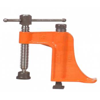

Thanks for the suggestion, but I was hoping for something a little faster than machining clamps. Are there any welding specific clamp systems out there? I may just make bigger slots and put my c-clamps through them.
THere are several welding quick clamps available at different price points and mounting style. These are but a few examples.

Check out Strong Hand (?Stronghand) clamps which are specifically designed for welding. Very nice.
/ welding table slots #10
yeah that whole stronghand table and clamps system is way cool, but too much $ for me. Now if I was trying to make a living welding.. maybe a different story.

There is a cheap table too. I think I paid $130 or so. Uses the same nice clamps.
