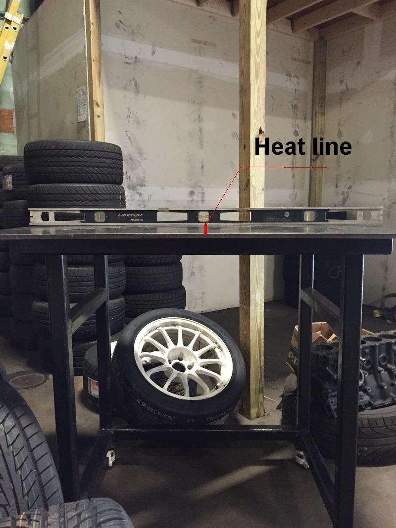

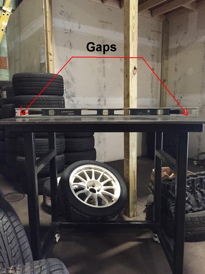

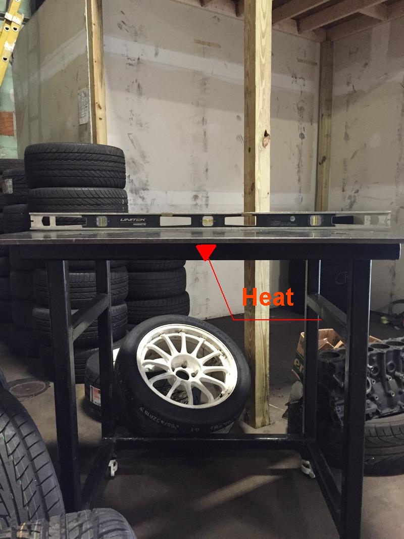

So I ended up buying a sheet of 1/2" plate. I am in the process of building the table but trying to figure out how to flatten the sheet. In the 8' direction the sheet is lost perfect. In the 4' direction its roughly 1/4" cupped across the full 8' length. Is that typical tolerance for steel like this?
/ Welding table top? #26
Was it sheared on that end? If the answer is yes, shearing will put a 'bow' in the drop off end. Most steel plate these days are stretcher leveled (google that) up to and including half inch, and it's usually pretty flat. Stretcher leveling became popular because of the demand for 'flat' sheets that are being cut with laser, water jet, plasma etc. But I don't think your sheet is way out of spec. I like to use 8"-10" channel welded vertically to the underside to help straighten it out. Basically, build a box underneath with the channel and tie your legs into the corners. Very stout! Heat shrinking is another option. (google that also)

Couple weeks ago over on Welding Web I helped a guy heat shrink his table back straight.
