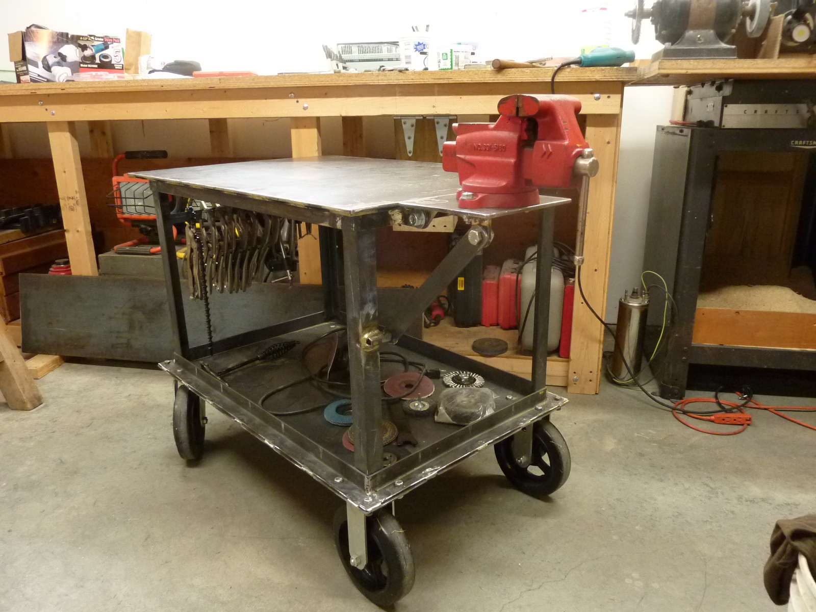

My table is 2x3 and has a thick top and a vice, perfect size that’s small.

I have two tables sort of suitable for welding.
One is a 1/2in 2ft by 4ft steel plate I slapped on an old Craftsman tool chest that I rescued from the recycle bin. Fixed the bent drawer slides and added casters.

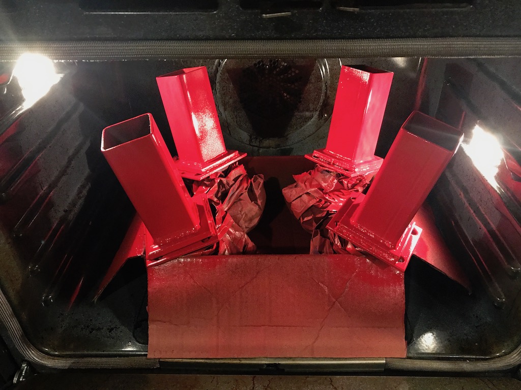

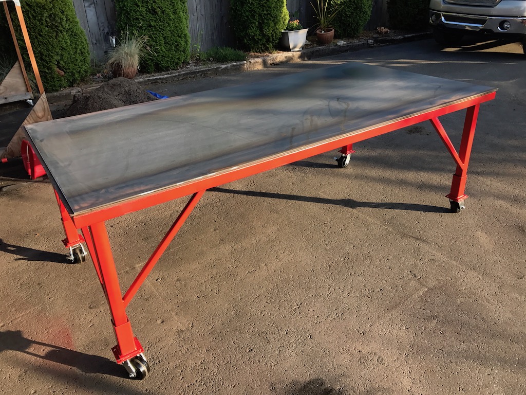

Since that is always cluttered, I bought a 4ft by 8ft steel table at a Boeing auction that was rusted bad. Legs needed chopped off due to water that froze and blew out the bottom tubes. I made some 'boots' with casters and added another 1/4in plate on top. Picture of boots in my wife's oven post baking the paint. She wasn't amused to put it mildly.

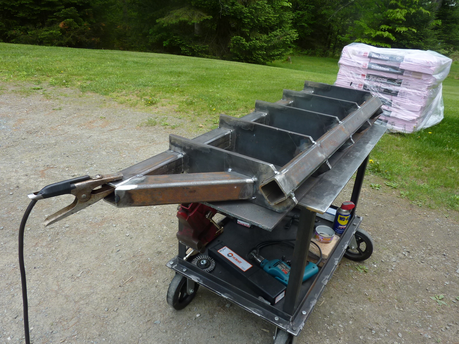

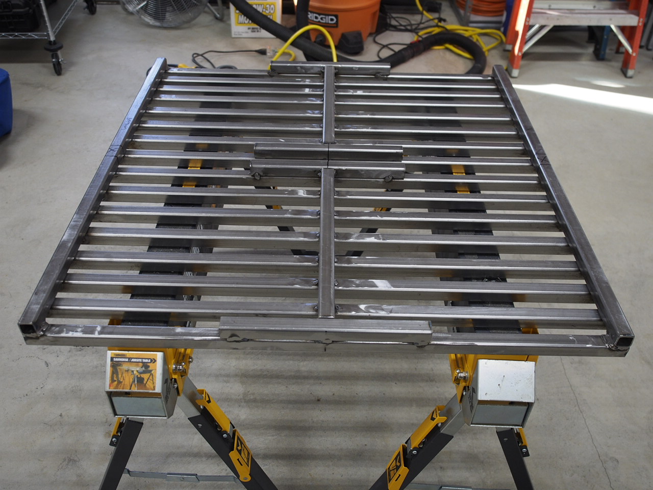

My welding and plasma cutting projects are not numerous so I can't justify a large spot in the shop that already has a truck, tractor, UTV and lots of tools and project storage space used. So I use two small portable welding tables with two platforms I made that works great for clamping, allowing plasma fodder to blow through the slats and allowing a lot of free space attaching options.
Pic is during construction. I subsequently cut it in half across its width as it is just too heavy to manhandle these days. I built it on the saw horses, moved it to test strength by supporting ends and placing 725# ROBB across its middle. The platform supported the ROBB fine but I was unable to lift it back onto the stands...

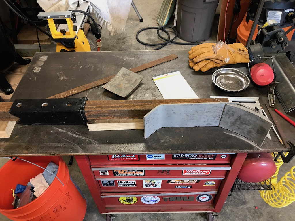

I made this 2' X 3' table with fold down vise as a 1st real welding project. I use it a lot - as a welding table and work cart. Nice and portable. Has a 1/4" top so maybe not an official welding table but it is what I have so I use it for every thing. Even fairly big stuff.

Look at local auctions. I’ve bought all but three of our welding tables that way and they are usually giving them away because they would have to pay a rigger to get rid of them and I always see small nicely built benches at the auctions. Large companies always have a maintenance department but a welding shop is better
Two of them are 60” x 144” that I got for $150 with 3/4” top plate
