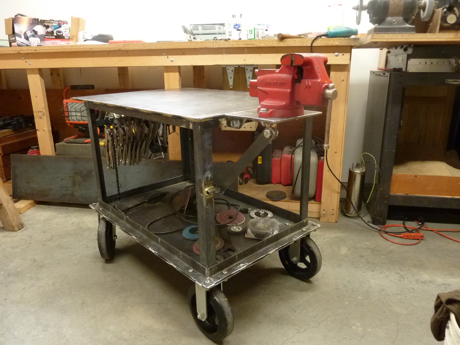

Dale, I watched a bunch of videos on that table and was ready to pull the trigger as I thought it would be a fun beginning welding project. Probably would have bought it but in the mean time I found a 'bruised' craftsman tool chest that I fixed up and threw a 2ft x 4ft by 1/2in steel top on it. I have a couple of small vices that I clamp on it but they get in the way sometimes.
I do wish it was bigger though. In the pic you can see I was laying out a DIY trenching tool from the scrap from shortening my back blade that was too long for my BX. Obviously, if space is a constraint, you got to do what you got to do... but I would highly recommend the 3ft x 4ft table over the 2ft x 3ft. Also I would really like the holes in the top for alignment and local clamping!
For such a small table top, the HF one could work too (I have one) but I use that one for supporting a couple bench tools at the moment.
