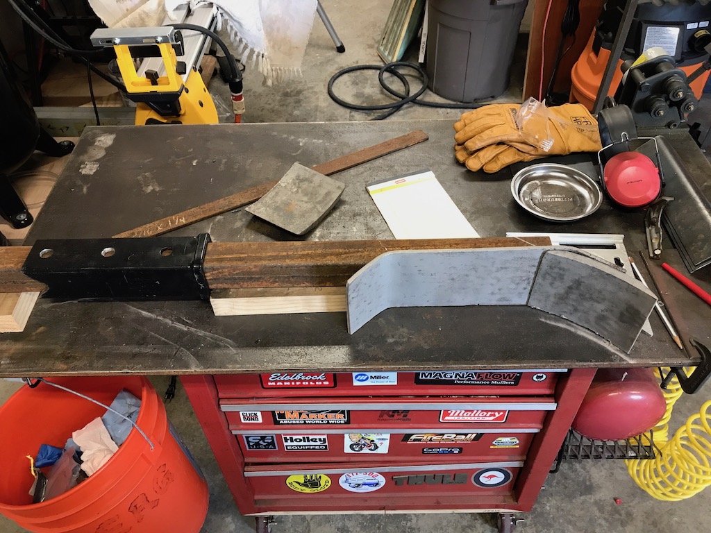

I never have bench space in my shop so I keep a welded together, lightweight, cut down to working height, section of racking, in behind the shop. Probably weighs 40# and I carry it by getting inside and holding each side, probably 36" X 72". I just throw on a plank or plywood to suit the job.
/ Welding Table? #49
I keep a section of pallet racking set up same as you. It will accept a 4x8 sheet of plywood. Handy for temporary benches or work surfaces.

I think mine is a bit lighter, but will still carry probably a thousand pounds. It looks a tad wonky in the picture, but it's not. The trick is the welded joints. I drag it out for painting quite a bit.
I have this heavier clamp table from a furniture factory, used here to assemble a hot water solar collector. I welded stake pockets to it, but the other frame is much handier.
